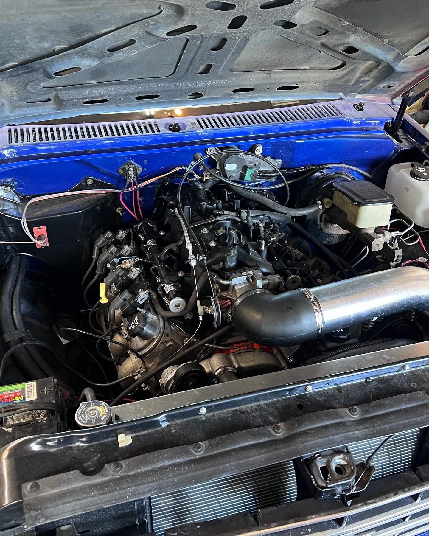

Hi all! I’m new to this forum and have poking around somewhat.
At the moment, I’m trying to figure out what torque converter to run in my truck.
5.3 (stock) swapped S10
‘92 4L60
3.08 gears
245/60R15
Truck in total probably weighs about 3000lbs
Right now I believe it has a 1400-1600stall converter in it since that’s what we had sitting around with the transmission. With that low of stall and my rear gearing, it’s a bit of a dog off the line so I’m thinking of jumping up to a 2200-2400 ish converter. What would y’all recommend? It’s mainly a cruiser right now. Someday I’d like to do autox but just want a nice driver
