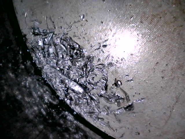

Today I took the valve covers off to inspect while running. Car wouldn't start but would turn over enough to see that the intake rocker on #7 cylinder wanst getting oil. I pulled the spark plug and put a bore scope inside to find this damage to the top of the piston.

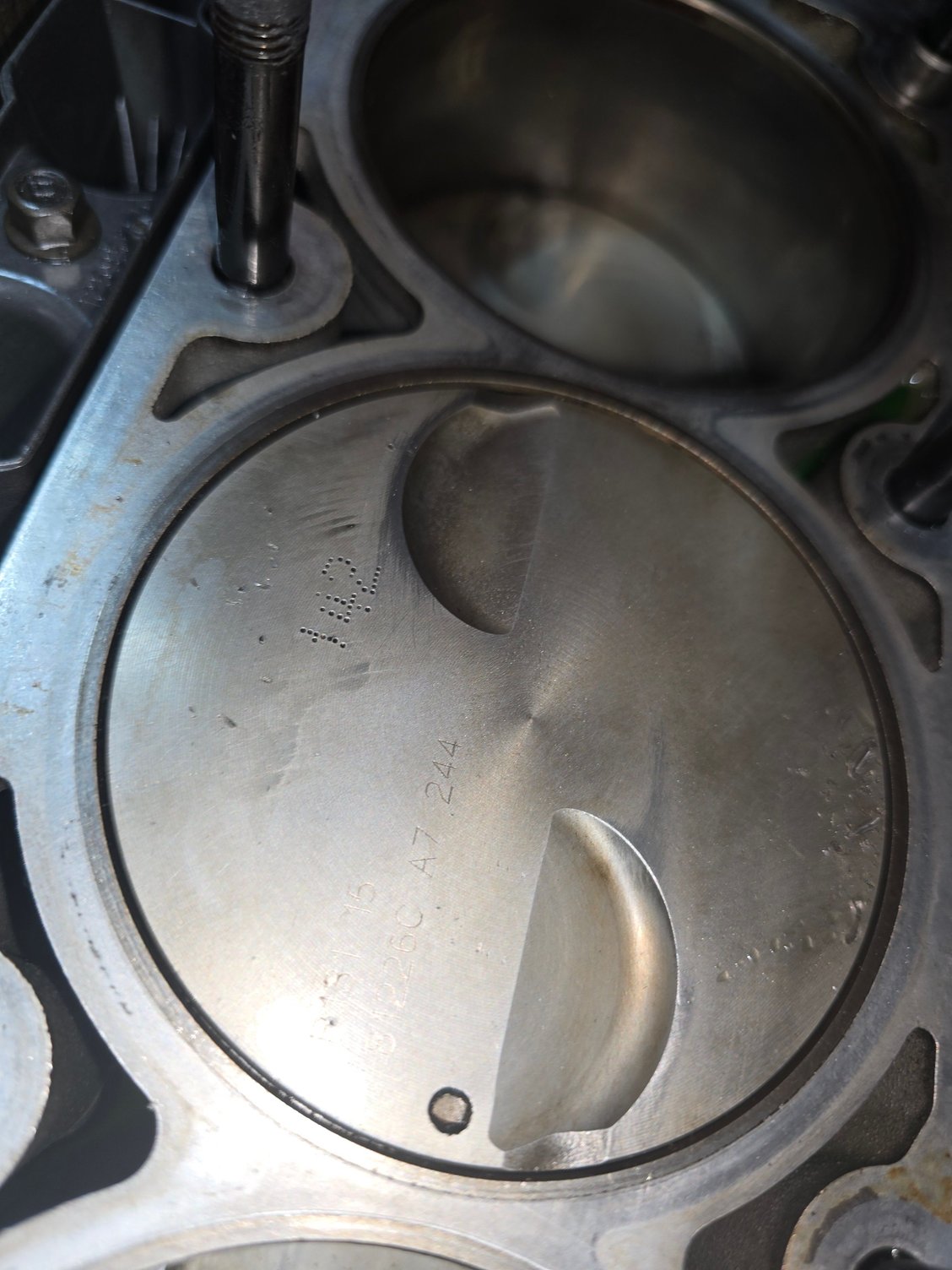

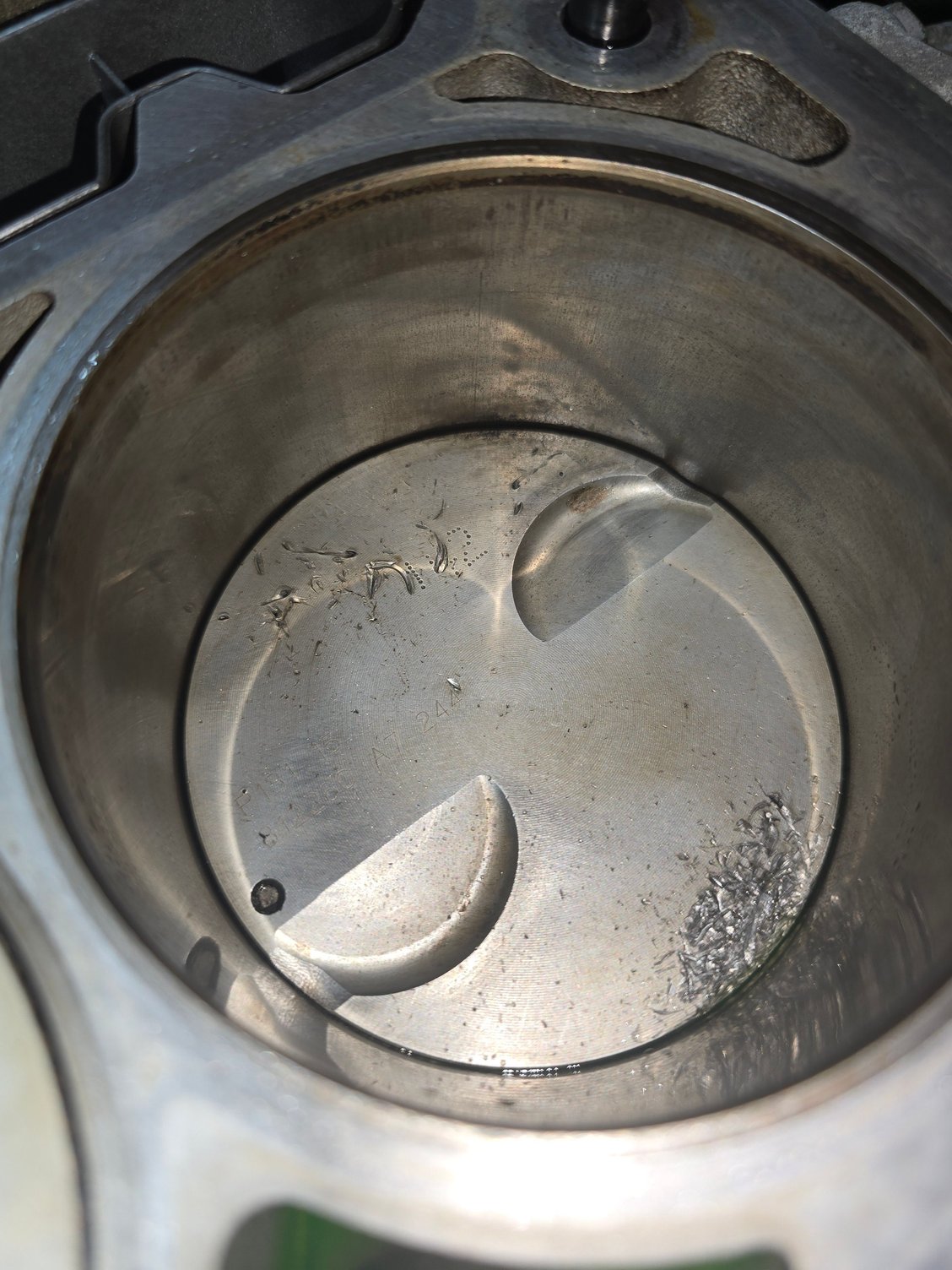

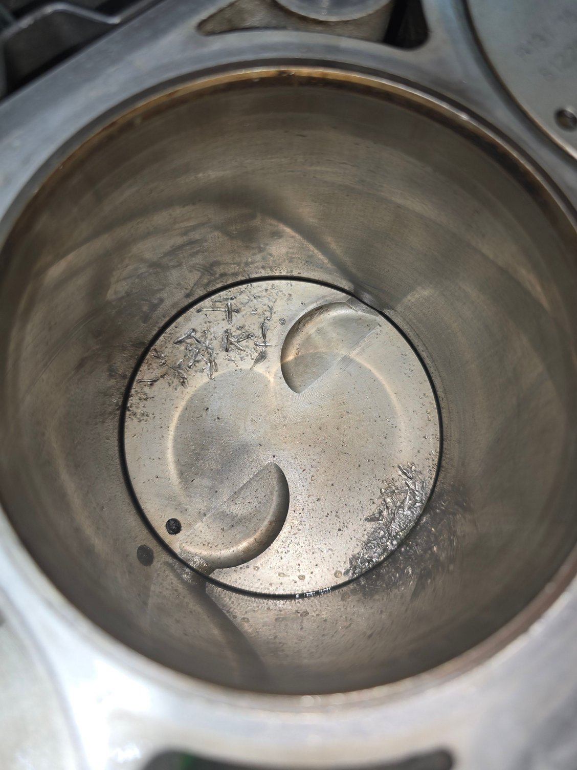

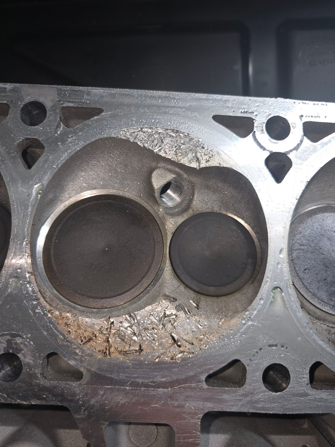

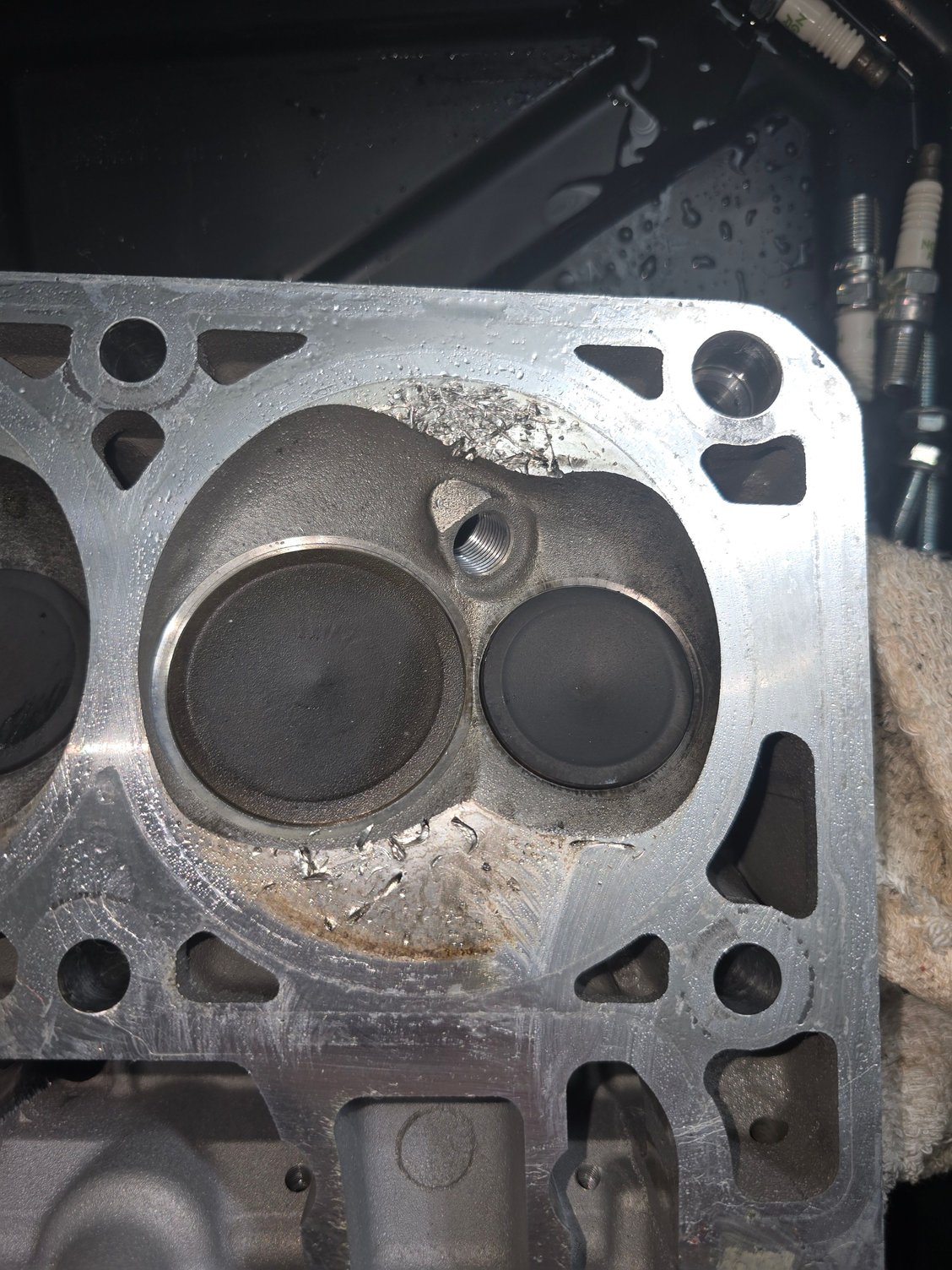

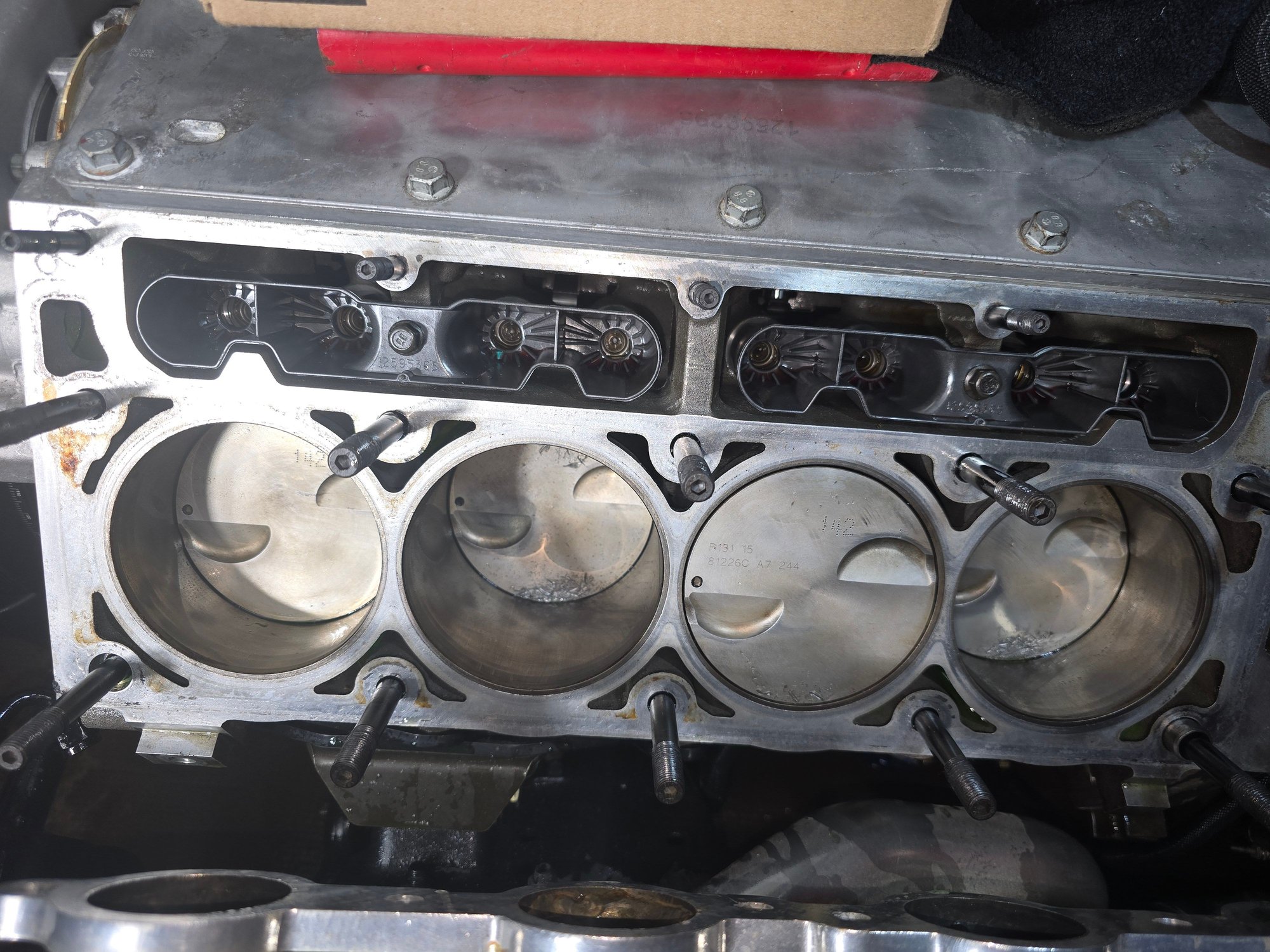

Default Pulled the drivers side head
Piston tops 3 and 7 look pretty beat up. Cylinder walls look good woth no damage.
#7 head damage
#7 head damage
#3 head damage
#3 head damage
Piston top #7
Piston top #7
Piston top #3
Piston top #3
#5 piston top
#5 piston top
#5 head
#5 head

So, what was in it?
Old Jan 13, 2025 | 09:24 AM
Fastpass69's Avatar
Joined: Jun 2023
Posts: 32
It must have chewed it up and spit it out already cause I was unable to find anything in the combustion chamber or stuck in the head. I still haven't pulled the passenger head yet but I'm assuming it looks similar and hope to something inside that I still asking the rattling sound.

Default Passenger Side Head
I put a bore scope down the passenger side and all bores and piston tops look good with no damage.

Hate to see this. But, at least you found your problem.

BTW, looks like a clean install too. Good luck, keep us updated
