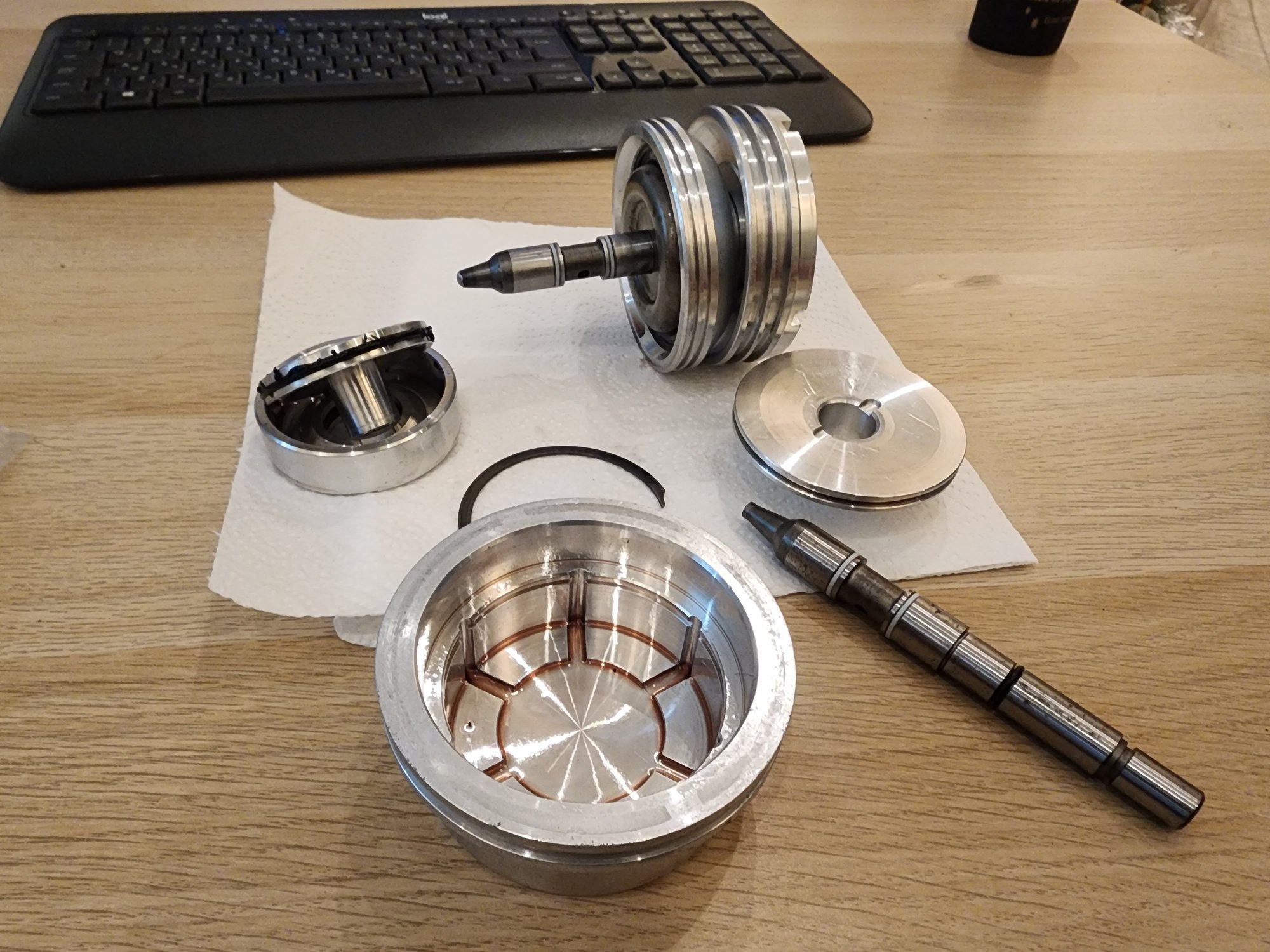

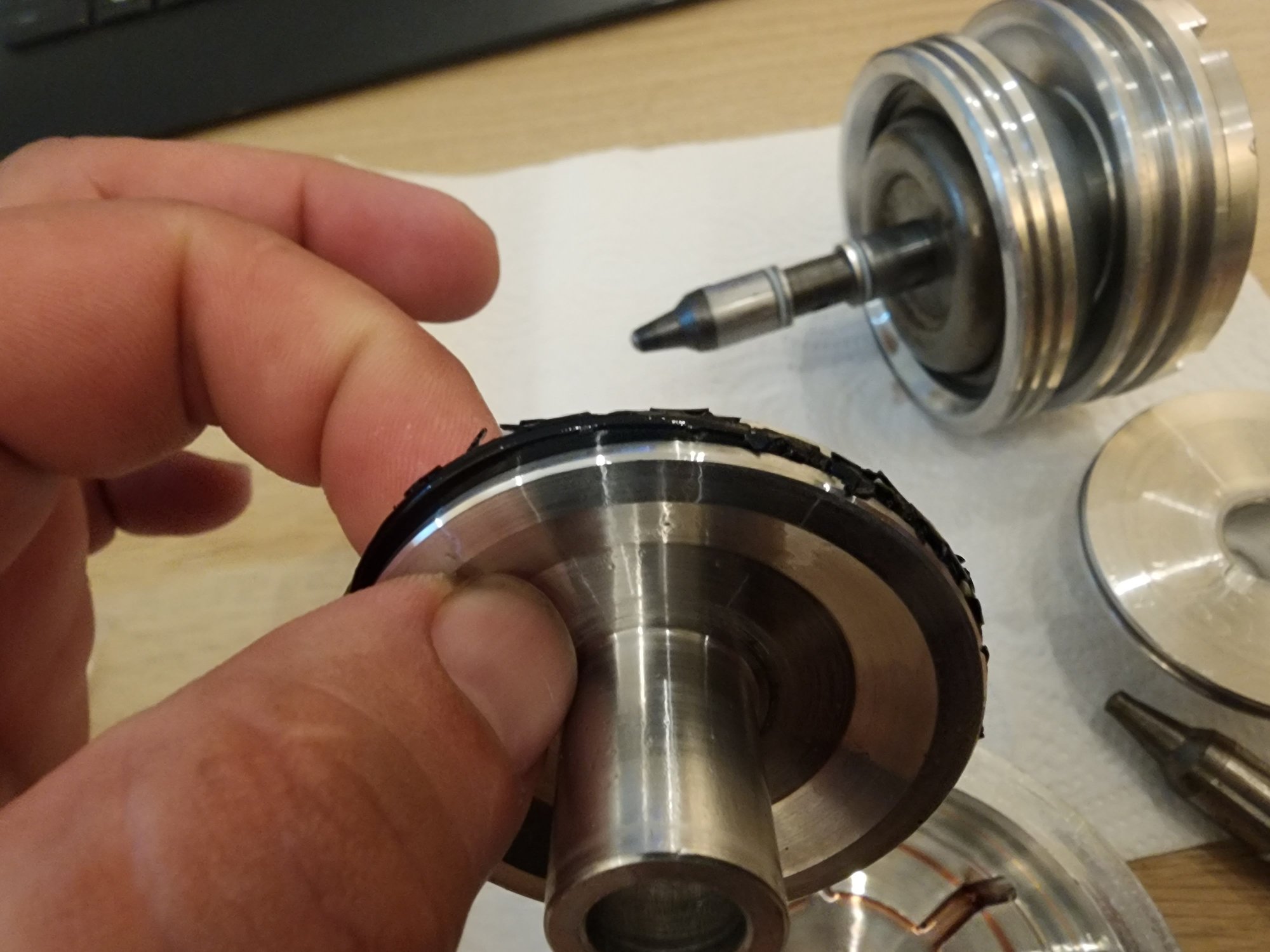

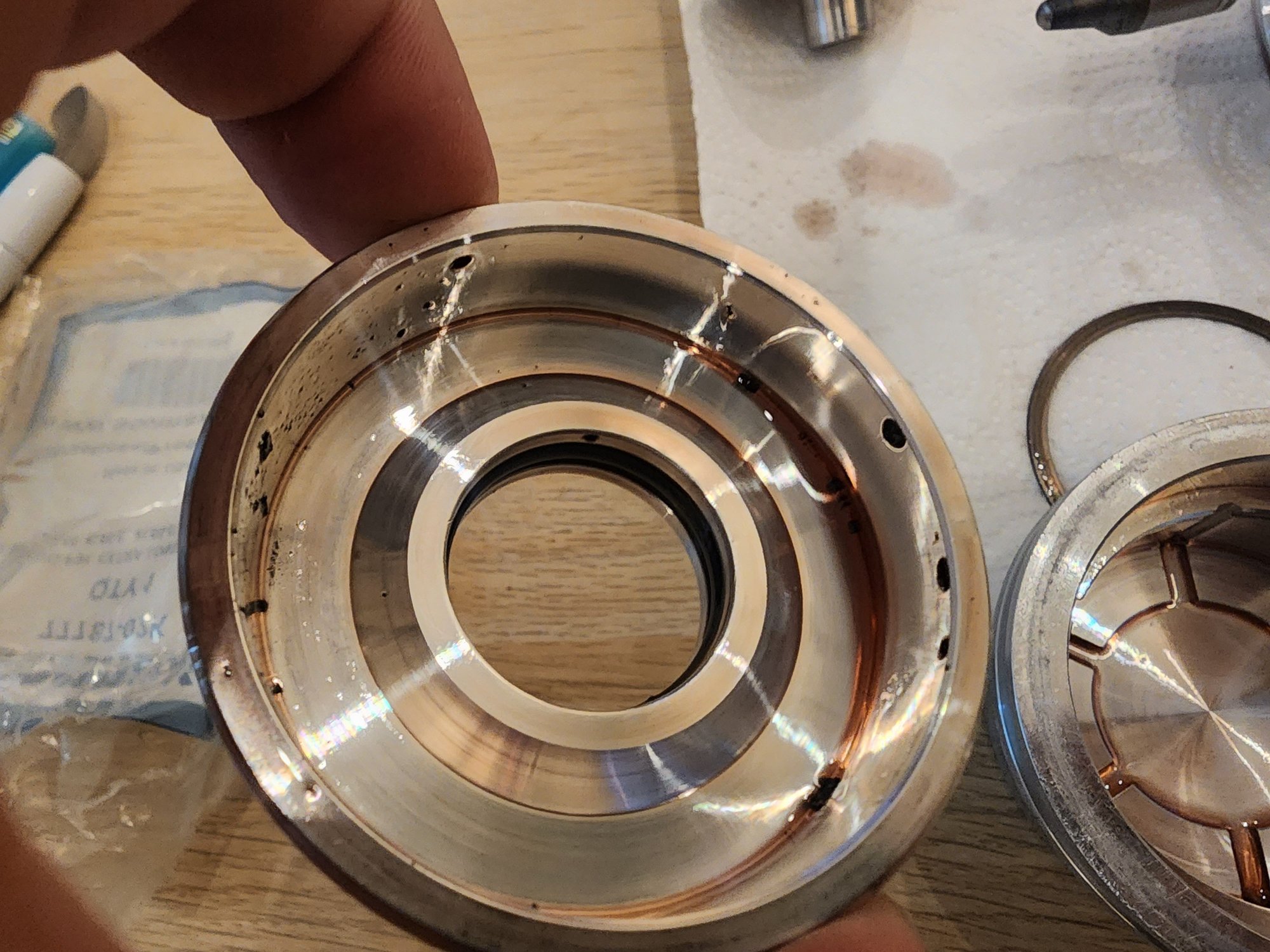

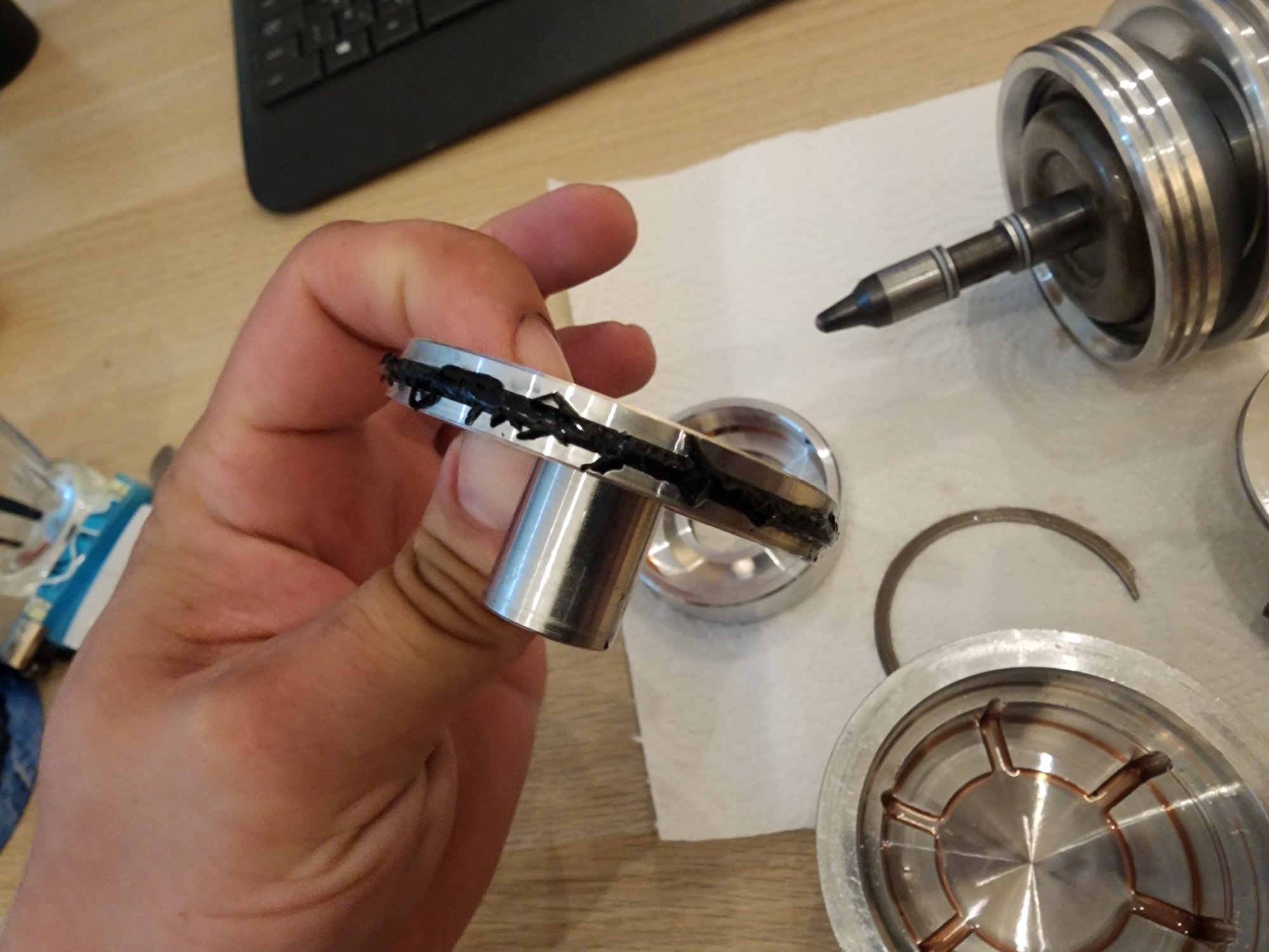

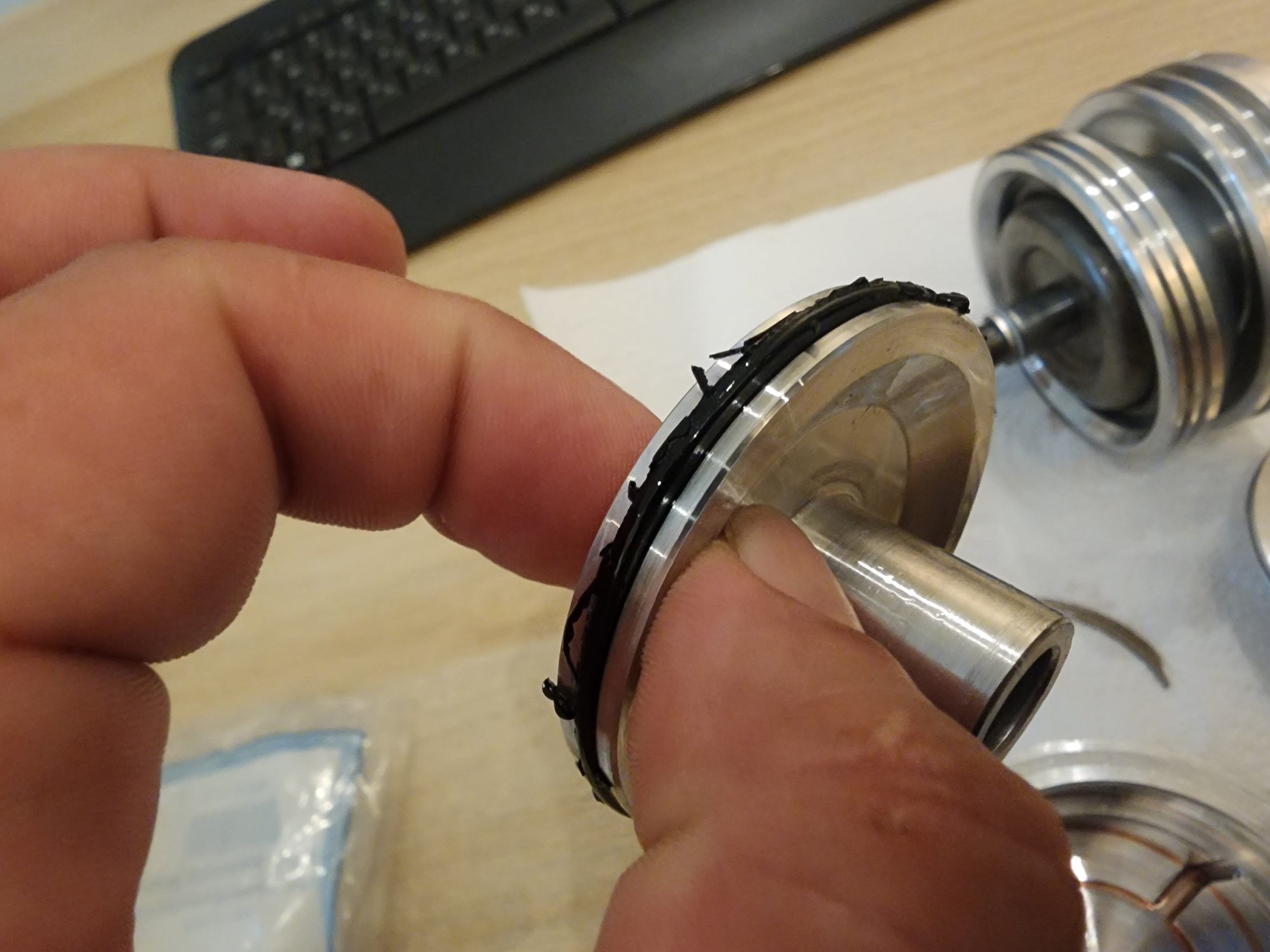

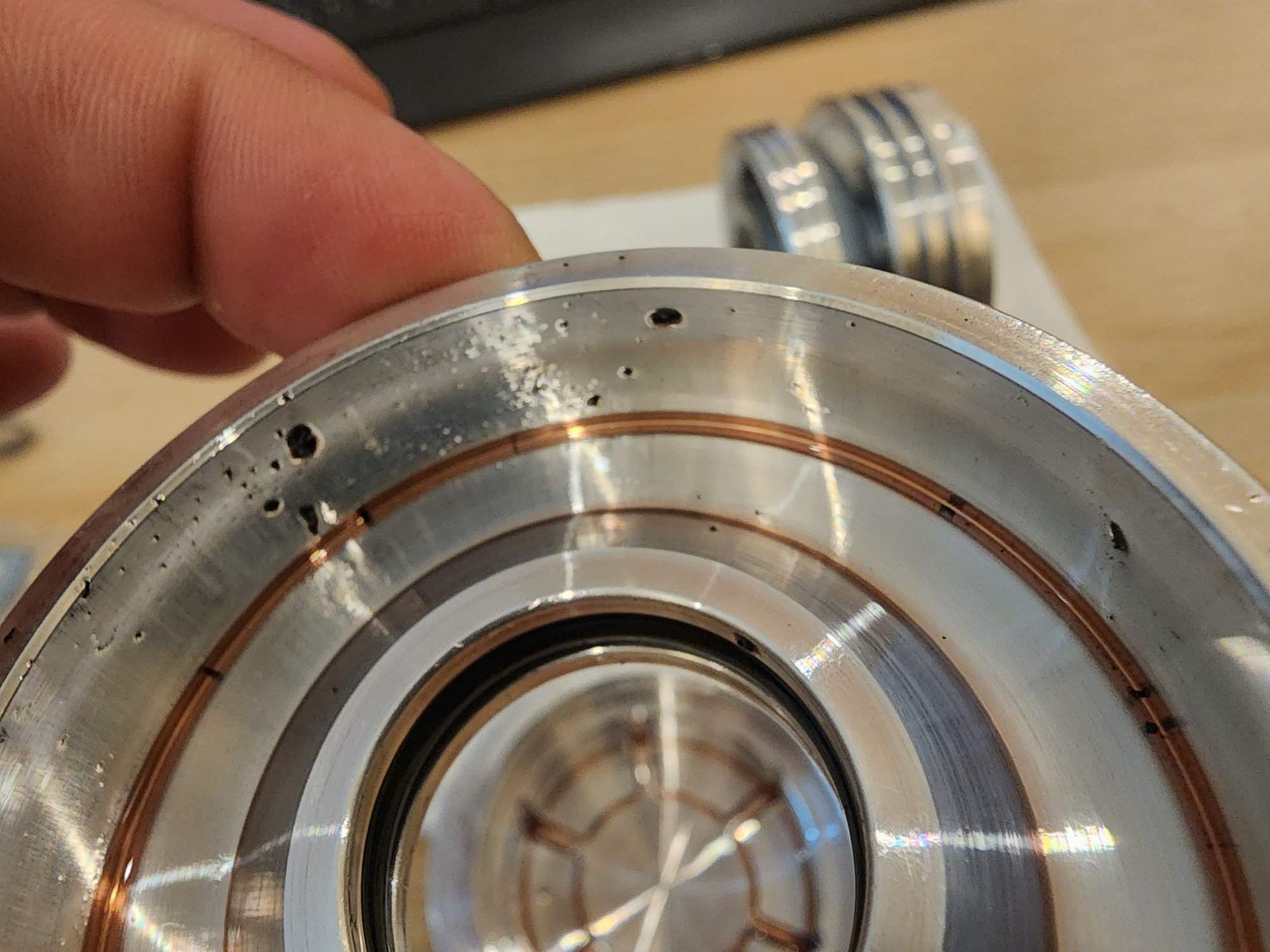

Alright, i will add to the 2-4 super servo.
Today, my long sonnax pin arrived and i decided to take off the servo, clean it, inspect it and put the new pin in.
as you know, the 4th super servo comes in 1 piece, assembled.
Here is what ive found in the 4th super servo, after like 10k miles.
Superhold Huh?
i use OEM GM Dex VI.
Servo travel 0.100 now.
Old Jan 3, 2024 | 12:11 PM

Hopefully one of the experts here can tell you which (good) seals to use going forward.
I regularly see a company sell a top-quality assembly but then include cost-saving crappy hardware/seals and such. They seem to forget that the quality and reliability of your overall product is generally determined by its weakest link.

It is a sonnax super hold 4th servo. I bought the whole 2-4 kit together.
Im shocked is not big enough of a word for what i feel now.
Need to find a quick solution because my truck is unusable now because of this.

Sonnax does sell that seal set , But if you have one what I would do is install a stock 4th servo, It will serve you just as well and has greater travel too. Never really seen that with a seal looks ike it desentigrated .
