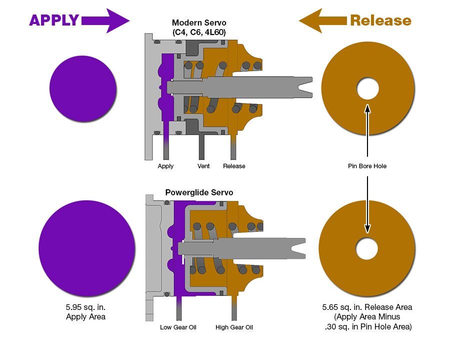

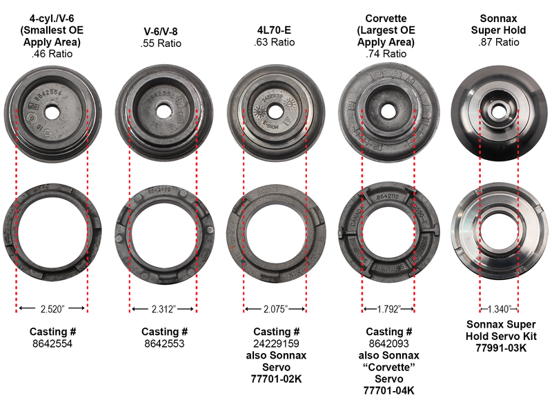

I wanted to add an Educational Post here regarding Servos, but I am really struggling to find the Words and access my own memorized information.
Please bear with me...
There are so many Different Servo Options for the 4L60E... It's Kind of Crazy!
Something that is NOT discussed on this Topic that is actually Important, is Servo Ratio.
For both Transmission Health and Performance use, Servo Ratio is something that has to be considered.
What you guys refer to as "Smaller" than the Corvette Ratio Servo, would be Servo Ratios that are essentially insufficient for the Transmission.
In my Opinion GM should have used the Corvette Servo in every 4L60E...
And made the necessary Hydraulic Calibrations (and even Spring Calibrations) to obtain the desired Shift-Feel for ANY Vehicle.
(From Mild to Wild).
There are 3 Smaller Ratio GM Servos used...
The 2 smallest, absolutely toss in the Trash.
The 0.63:1 Ratio Servo can be made to work (so can any really) but it is inefficient in comparison to the 0.74:1 Ratio Corvette Servo.
Fortunately the 4L60E has the benefit of Fluid on Both Sides of the Servo.
The Power-Glide for example does not have Fluid on the Release Side and has to rely on the Release Spring ONLY.
Servo Ratio in this case is substantially more Important for proper operation of the Band.
(Sonnax actually makes a great product to change this).
(Sonnax has an AMAZING Parts Selection for the Power-Glide!!!)
If anyone reading this does not really know what this "Ratio" is about...
It is (in the 4L60E) a Larger Area for Fluid to act on, in order to Release the Band, Than to Apply the Band.
There is an Ideal Ratio, and I feel it is the Corvette Ratio.

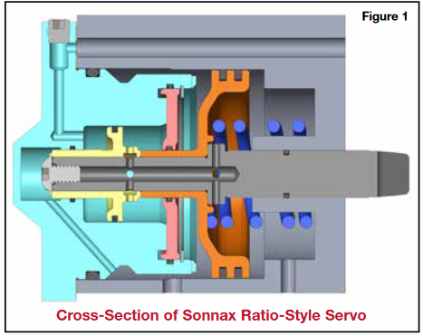

Band Holding Capability is another factor.
Going to a higher Ratio Servo like the Sonnax Part, will increase Band Holding Capability...
But So will the proper Hydraulic Calibrations, and so will a Wide Band.
Going too far past the Corvette Ratio Servo like the Superior Transmission Servo that does not use a Cushion Spring...
Requires changing all of my Orificing that Control the Band Apply and Release.
Unlike many Builders here, I do NOT have an operational #2 Check-Ball, and Plug it's Hole.
This makes the Orificing very Critical.
Superior also offers a Billet Servo that retains the Cushion Spring and is larger than the Corvette Servo, Similar to the Sonnax Servo, and not as large as the Original Superior Billet Servo.

Originally Posted by MaroonMonsterLS1
No matter which brand...Anything more than "corvette" ratio, I'd advise against.
I've got the math on the apply power a corvette servo has with a normal and a wide band.
I can say with confidence that a wide band with a vette servo will not be an issue at virtually any power level...and having that apply ratio changed to sonnax or superior or to yours...does no benefit on a 2-3 shift IMO
Hi Grady,
This is so true. I regret so hard getting the sonnax billets. Too bad i didnt know what im doing.
My purpose was not drag racing. Installed them on my dialy driver, because its fancy billet super duper servos.
I remember when you have read my build, you dialed down my orfice sizes and i drilled according to what you said. And it still super harsh for a ride, its perfect on WOT tho.
I will go with a Corvette Servo and throw this sonnax stuff out soon.
For everyone reading this post in the future. Its been told here 1000 times by Maroon, Vortec and others, that Sonnax billet 2-4 is not made for a dialy driver. Its for racing only. Do not expect them to work smooth on part throttle
Ask me how i know.

Originally Posted by Edward Stark
Hi Grady,
Ask me how i know.
I agree with Maroonmonsterls1 here for the 1-2 Corvette servo. I do use the Sonnax 4th servo a lot and I have not had any complaints yet on the 3-4 shift being to harsh at part throttle.

I have both 2nd and 4th Sonnax billet servos in my trans and it shifts great part throttle and WOT
Not saying they are better than the .093 vette style but the complaint of to harsh part throttle im not experiencing.
Not saying they are better than the .093 vette style but the complaint of to harsh part throttle Im not experiencing.
I believe that the shift holes require smaller hole sizes for the larger servos and some builders do not adjust them for vehicle size, weight & converter being used. there for they end up with either to harsh or too soft of a shift at times. HP work is not what the OE engineers had in mind when spec'ing out a transmission OE shift feel. That way builders are on a trial and error scenario. I even drilled my own 2-3 shift hole to small for very light throttle but just fine if 25% or greater throttle setting. Go figure...
Old Nov 26, 2023 | 05:11 PM
2BFAST's Avatar
Joined: Apr 2005
Posts: 1,067
Likes: 234
From: N.E Missouri
My orifice sizes are as follows:
Band release - .104"
Rev input - .104"
3-4 clutch and 3-4 clutch signal - .110"
1-2 shift - .096"
2-3 shift - .140"
3-4 shift - .110"
Low/reverse - .093
Forward clutch - .086"
I do like the extra sealing rings with the Sonnax pistons as well as the rings on the servo pin.
Rev input - .104"
1-2 shift - .096"
2-3 shift - .140"
3-4 shift - .110"
Low/reverse - .093
To get by the additional drag of the dual Drings I found a th400 int servo return spring to replace existing spring works well.
