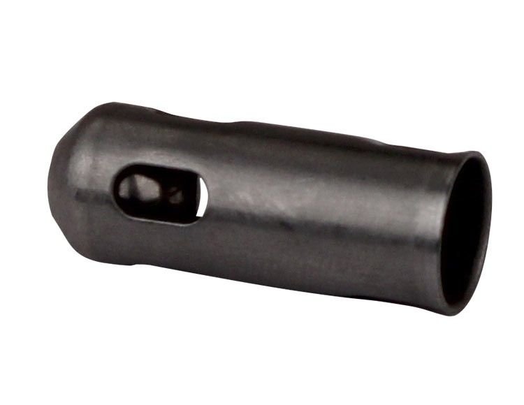

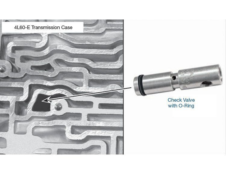

Old Dec 10, 2023 | 07:43 PM
vorteciroc's Avatar
Joined: Jun 2008
Posts: 3,204
Likes: 1,391
From: Nitro Alley
I also want to make certain that This Part was installed:
And not this Part:
