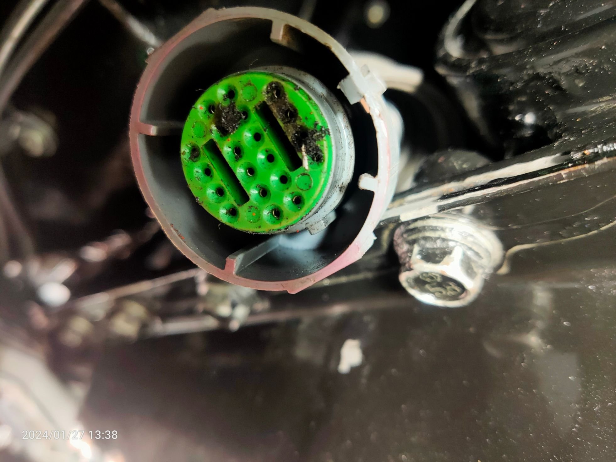

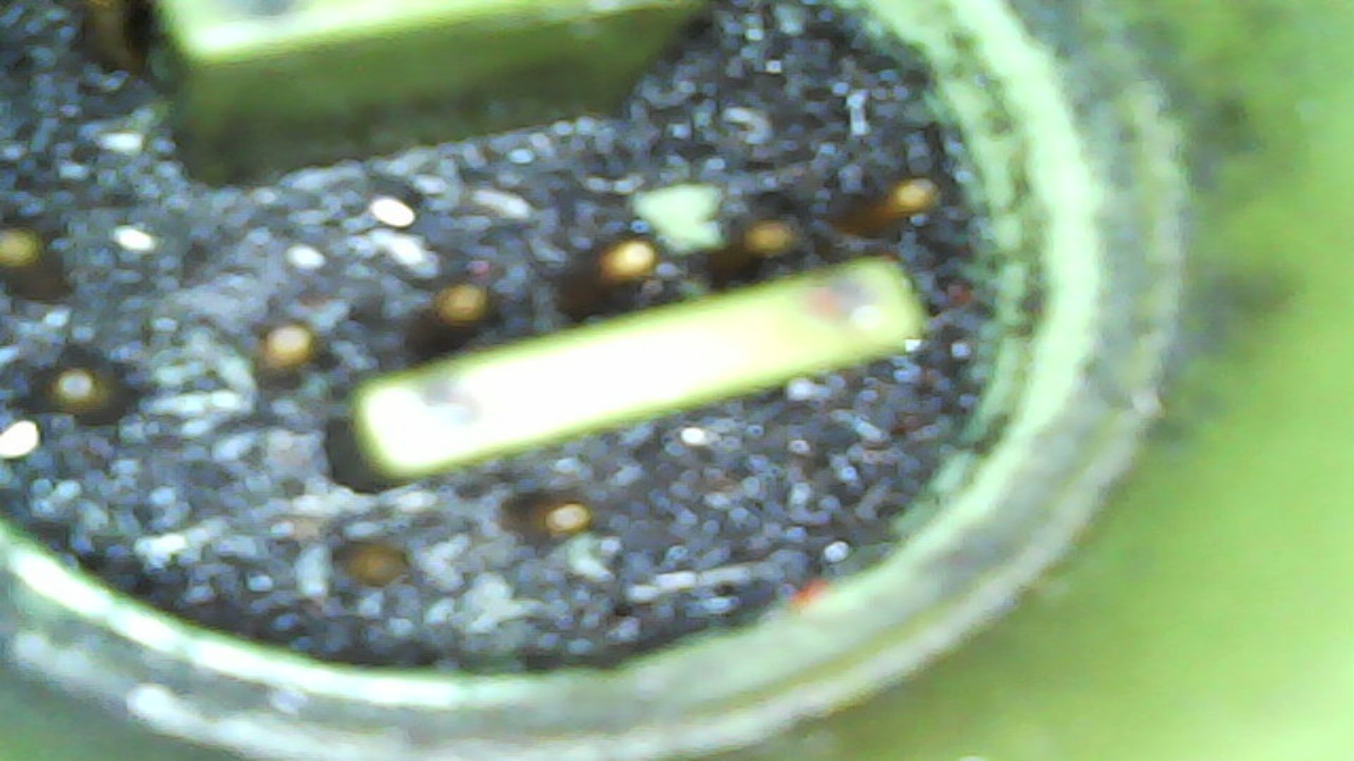

Got a good look at the transmission plug and socket today. The plug has some black marks around some of the pins, could be burn marks not sure. The socket was filthy. It was covered in some black gunk right across the bottom. I really don't know what it is or how it got there.
Anyway, cleaned them both up and was confident this would fix my problem with the P1810 error code. No such luck! In fact, it reverted to the previous behaviour - wouldn't change past 2nd. All I can assume is that there are still one or more pins not making proper contact.
Here is what the plug looked like:
Here's a photo of the socket (sorry about the poor focus):
I'm going to try to wiggle the plug around to see if I can get the gear changes to come back again. If so, its likely a problem with a contact in the plug/socket.
Old Jan 27, 2024 | 12:02 PM
FranksCustomTrans's Avatar
LS1Tech Sponsor
Joined: Mar 2023
Posts: 1,824
Likes: 1,162
From: BERWICK PA
replace plug end you can buy them on ebay and amazon IMO

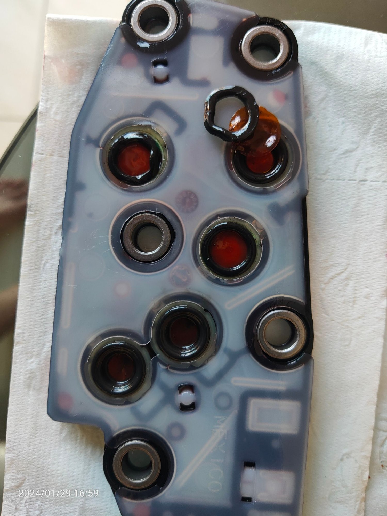

Removed the plugs from the PCM and tested the wires coming from the tranny. All the signals read correctly (the resistances of the solenoids were within spec and the temperature sensor and TSS were reading correctly as well). I checked the continuity of the wiring from the tranny connector to the PCM plugs for the pressure switch signals and they indicated no open or short circuits.
Next step I dropped the tranny pan and removed the pressure switch. This is what I found:
As you can see, one of the pressure sensors was completely destroyed. Another one was crushed. When removing the bolts, I noticed one was very tight, two were moderately tight and one was relatively loose. I trusted my mechanic to install this as I didn't want to make a mess with transmission fluid all over my garage floor. Usually his work is very good - he certainly had an off day when he did this little job for me!!!!
So I've ordered another pressure sensor - I'll be installing this one myself for sure. (should be 10 ft-lb for all the bolts, correct ?). I ordered a "Rostra" brand pressure switch - anyone had experience with this brand?

Old Jan 29, 2024 | 10:58 AM
LS1Tech Sponsor
Joined: Mar 2023
Posts: 1,824
Likes: 1,162
From: BERWICK PA
Looks like you found your issue and yes aprox, The rostra is fine have used many rostra products over the years.

Old Jan 29, 2024 | 05:03 PM
mrvedit's Avatar
Moderator
Joined: Aug 2010
Posts: 7,323
Likes: 529
From: Ann Arbor, MI
That is a bit too tight. The correct torque is 8 ft-lbs, often documented as 96 in-lbs. Same as all the VB bolts in the area. The HF 1/4" torque wrench works fine for this. Or gorilla strength on a nut-driver.
On the "lighter" side, I recall a post where someone misread the "96 in-lbs" as ft-lbs and had the bolts snap. Somehow VB bolts don't like like wheel studs to me.
Old Feb 9, 2024 | 04:41 AM
carmodyg's Avatar
Joined: Dec 2020
Posts: 88
Likes: 16
I replaced the pressure switch. Torqued the bolts to 8 ft-lbs as suggested by mrvedit. Took the car for a drive today and it seems to be changing gears properly. Getting 1 thur 4 in drive. Gears are changing smoothly without any issues.
Thanks everyone for your help and suggestions.
