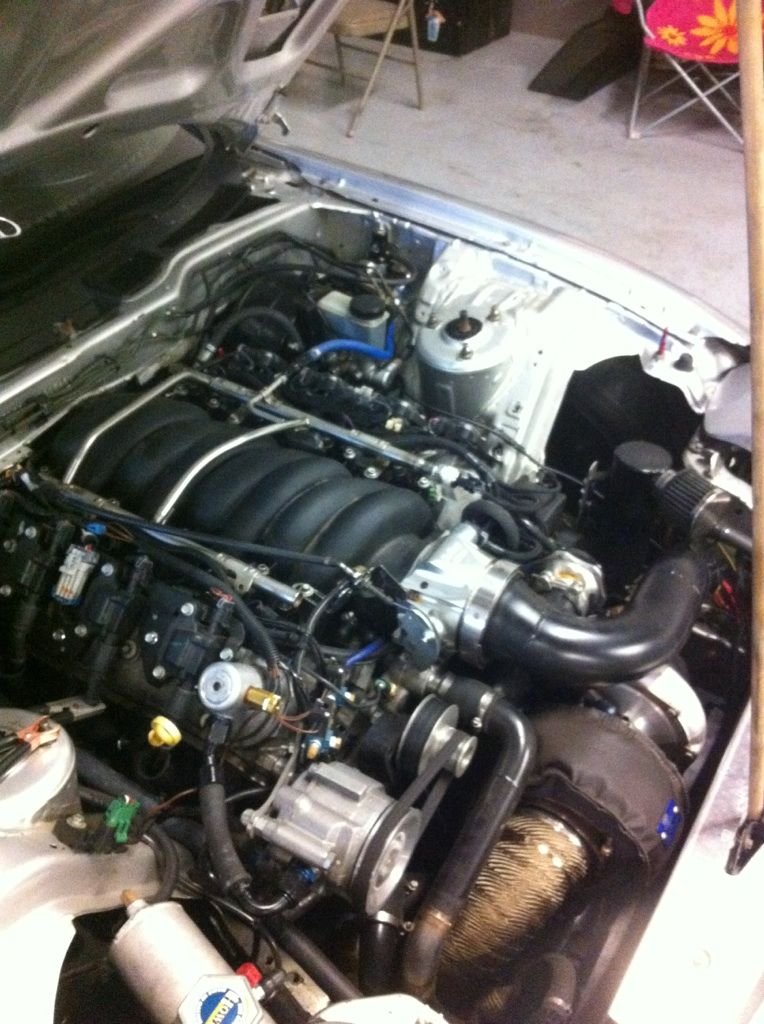

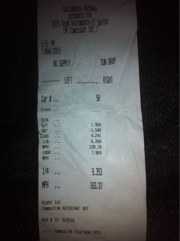

Until you are beyond 600-700rwhp just rebuild your T56... if you plan to make more than that... sell your T56 and buy a T56 Magnum.
My stock T56 Magnum F (same dimensions/bolt in as yours) is holding 1200rwhp ramped in. I don't launch it hard as I really don't like fixing broken parts... but it certainly moves out. It's mainly a street car and 1/2 mile. I can only do private track days as it doesn't have all the safety gear (full cage/parachute). An automatic is so boring... you can have an 8/9 second car... keep it a stickshift and negotiate corners unlike a full blown drag car. Plus you have overdrive.....
The pass from the strip was the best of the day on a new 88mm turbo with a ton left. The track wasn't prepped great and I launched it with zero boost. Turbo is rated at 1450hp+
