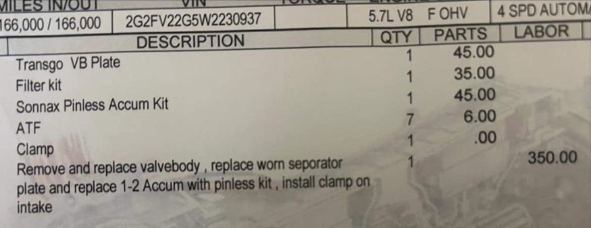

I have a rebuild 4l60E shifts great usually… but for some reason when it’s cold it will clunk into drive and reverse.. attached is a photo of what has been done to the trans along with a video of what it’s doing..

Idle line may be to high, Some builders trun up the EPC solenoid this can cause this or other means to raise line. Also note while receipt does not say it pinless fwd accums do limit travel but since its reverse to I would say idle line is a bit high. IMO.
Will it cause any issue not likely. Also idle mspeed might be a bit high

Then I would look at the fwd accum make sure its not sticking cold and spring is in and the correct one, You could also change it to spring with less tension to increase accumulation this would affect at all temps but that would not matter really . Also its possible someone could have enlarged the FWD feed in plate or even the plate , I have noted difference in sizes on some plate yes new GM plates ,but would thik that would have the opposite affect temp wise.
I would try and get a preasure gage on it to and see what the idle line of cold verse hot , Also what is the engine RPM cold ? Generally its higher.
