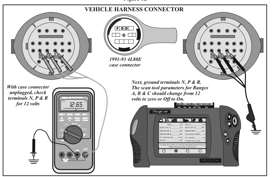

4L60E, can it be unpluged to perfrom a wire test?
Old Jun 10, 2024 | 02:13 PM
OddJack's Avatar
Joined: Nov 2023
Posts: 85
Likes: 9
Default 4L60E, can it be unpluged to perfrom a wire test?
I mean without moving the transmission?
Talking about the case connector on top.
The purpose is to check the voltage coming from PCM to the harness.
Old Jun 10, 2024 | 02:57 PM
FranksCustomTrans's Avatar
LS1Tech Sponsor
Joined: Mar 2023
Posts: 1,799
Likes: 1,142
From: BERWICK PA
If you are just wanting to check voltage to Pin E sure, Though you would get a better loaded test with harness plugged in and tapped into pin e wire and PCM does self test with solenoids loading circuit,
Thanks Franks,
This is what I am trying to do:
Yes, it can be unplugged with trans still in the vehicle.
