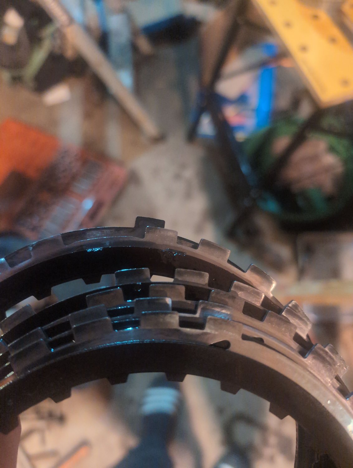

I watched this YouTube video and the guy said around 3:40 in that if the clutch disc is welded to steel it's like the same as having the piston apply the clutch. When you put it reverse it's like having both the reverse and the forward clutches applied. My truck wouldnt go into neutral either. (When in neutral and on jack stands the wheels actually were turning in forward direction). The symptoms seem correspond like what the fellow is describing in the video. Any thoughts?
Here are some pics of my reverse and low reverse frictions and steels:
I haven't taken apply piston out yet because I have to modify my spring compressor tool and I gotta go to sleep.

Its normal for the wheels to drive somewhat with the wheels off the ground. Did they drive when they were on the ground?

I didn't try to drive it in neutral but I did try to push it backwards in neutral and it would not budge. I tried shifting between reverse and neutral while truck was on and it seemed to inch a wee bit forward after shifting into neutral.

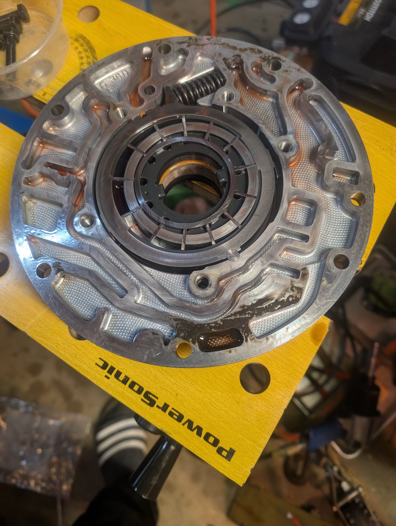

A couple other things I found upon disassembly:
Black looking liquid in pump:
And worn looking low/rev piston:

Piston looks normal to me and the "Black looking liquid in pump" is burn clutch friction mixed in with the trans fluid.
