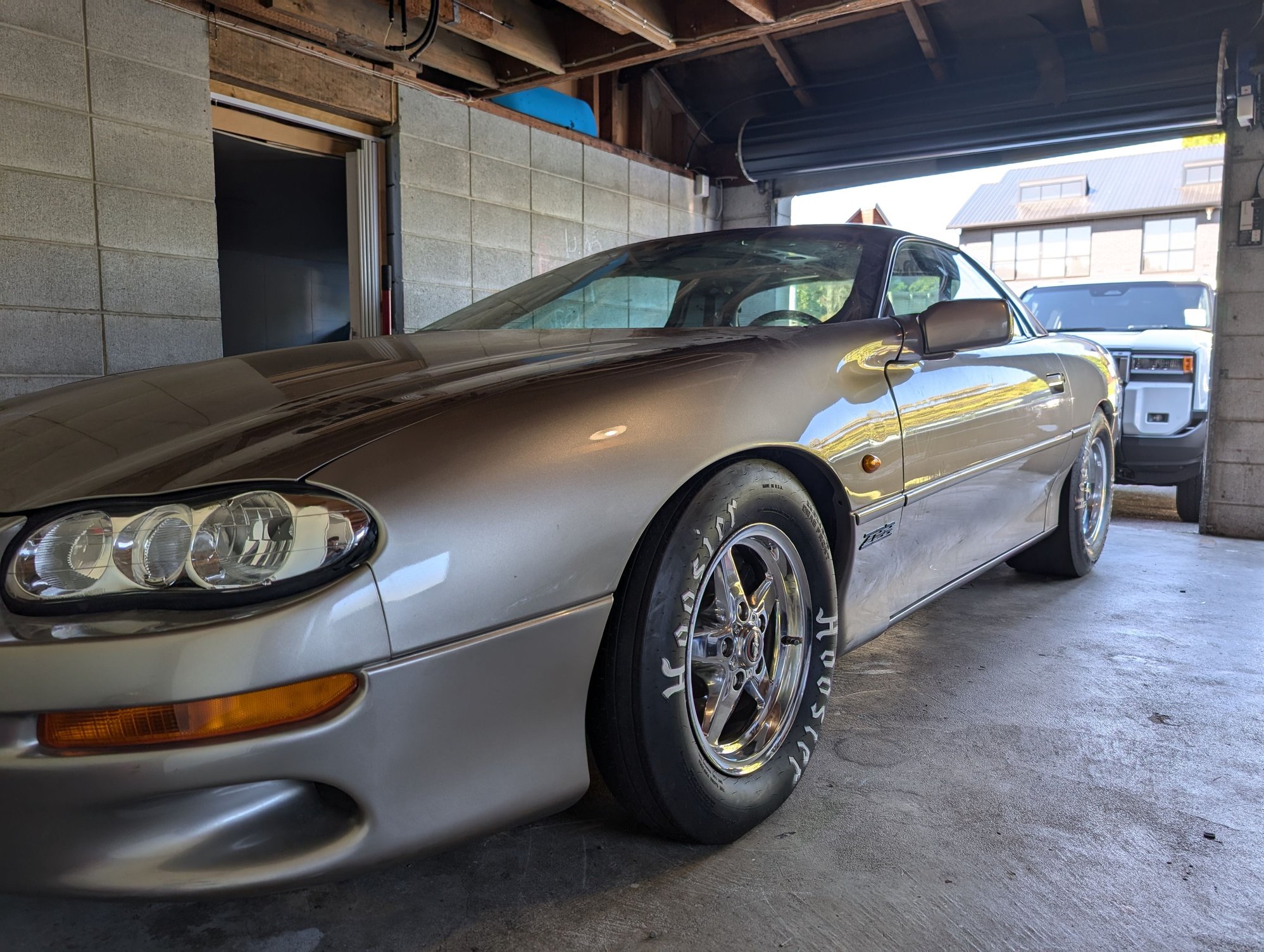

Hi. I have a 2001 LS1 Camaro, cam only (Tick SNS 3) with a Nitrous outlet stinger plate/ Vic jr. Will run up to a 250 shot on C12. 1/4 mile track car only. I currently have a stock 4L60E with a TCI 4000 stall and a stock 10 bolt rear and 11.5 Hoosier QTP. The expectation is that this rear/ trans will live a short but exciting life. Not sure on the weight or times yet as a cage is being built at the moment. All "free" weight reduction has been done, and some more.
What is the general consensus on th400 vs powerglide for this setup? Any recommended transmissions? (With trans brake)
Also what type of stall? (Up to 250 shot) Also any thoughts on rear ends? E.g Strange S60 vs Moser 9.
I'd like to prepare for a little more power in future if I went for a bit bigger + built motor.
