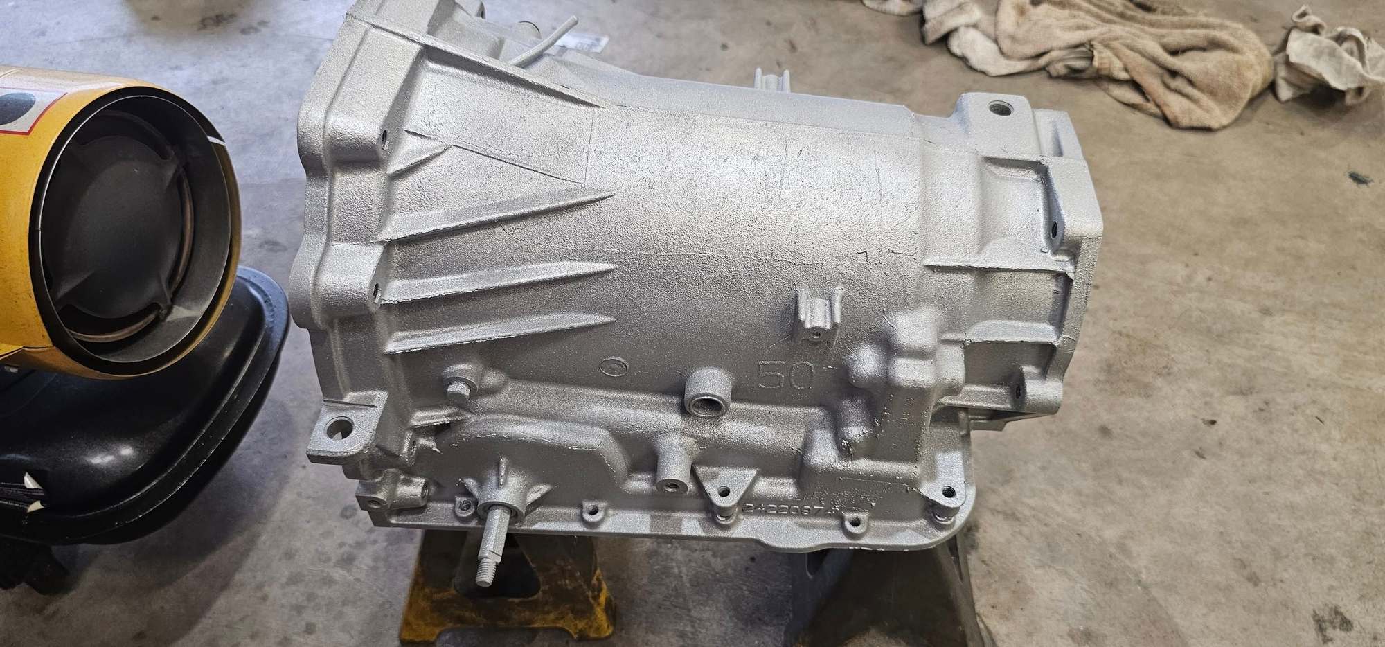

A little while ago I ordered a 4l60e from @FranksCustomTrans in the stage one variety, and he’s recently sent me a couple photos of it. I bought an 11” FTI 3,200 “Street Brawler” to go along with it. I hope the Brawler doesn’t take a dump on me while cruising around. Anyway that’s the route I wound up going. I’ll let y’all know how it is once it’s installed.

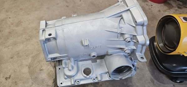

You might wonder why if is sitting by a bullet heater? It is part of a process. I clean and strip all the oil and grease off first, Then heat till dry, Then baking soda blast to remove all the corrosion (Being in the north salt really corrodes the aluminum) I use baking soda for a few reasons but mostly its water soluble on clean up . Unlike Nut chips or sand it wont become lodged in indesirable places , rinses away and and poses not health issues to me or environmental issues. Then its heated again to remove all moisture to 200f. Then primed with High Temp engine primer while hot, Then when cooled to about 100f sprayed usually with flat cast aluminum spray high temp header paint. Then heated again to 200f to bond it all. Came up with this system many years ago.
Prevents future corrosion, Stays on (many of my customers have hot rods and show type cars, so this is important to them), Makes cleanup on a refresh super easy, And just makes it pretty. The case even after soda blasting is still very discolored and restoring the original GM finish would require polishing then a boiling process.
Just some useless info for anyone interested.

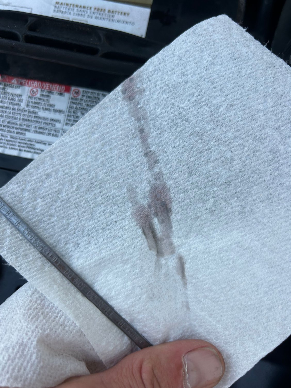

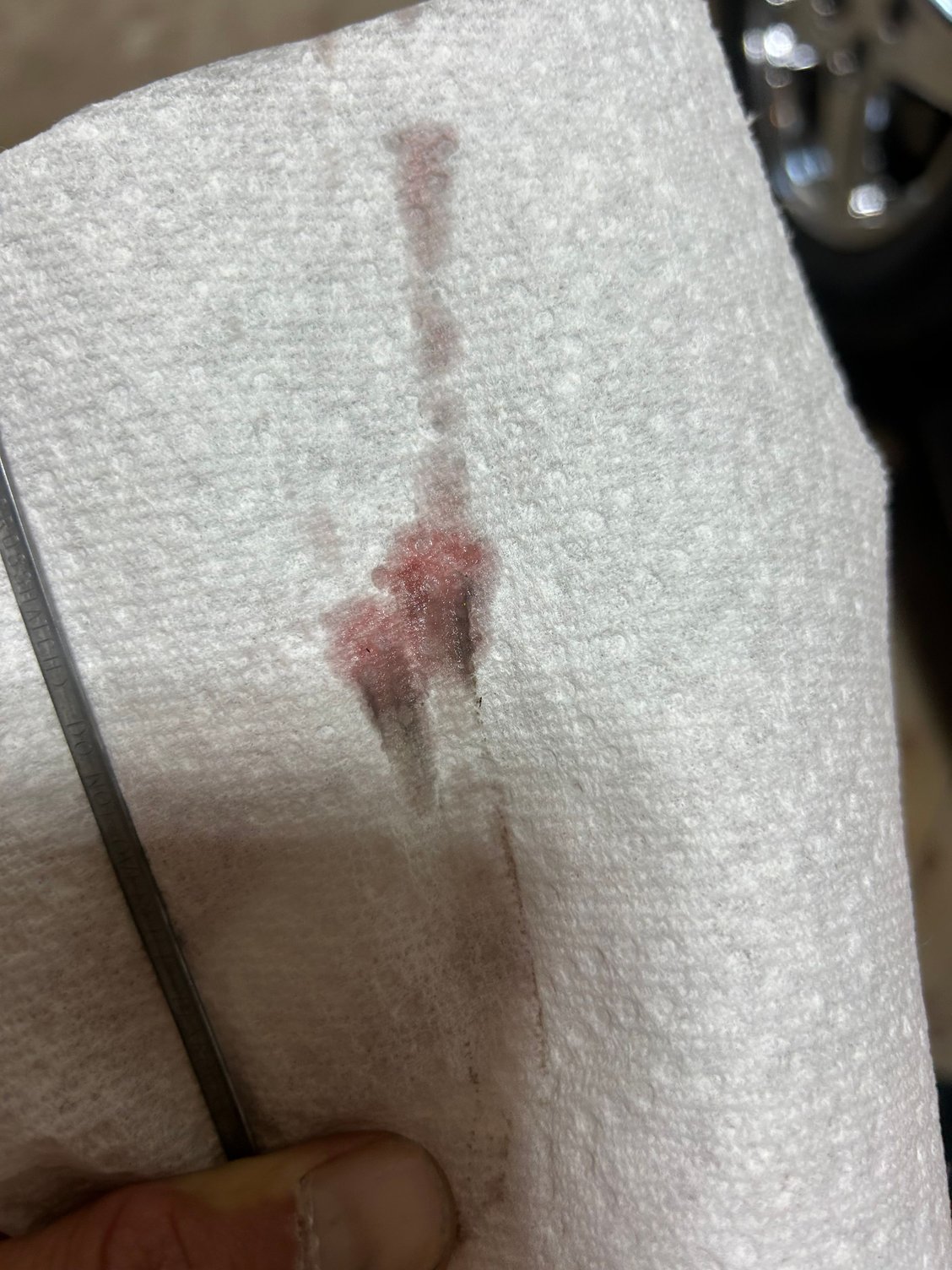

I bought new bell housing bolts, tq converter bolts, U-joints, as well as a trans cooler. Other than fluid is there anything else that you can think of that I’ll need to get this thing into a 4th gen F-bod? I just thought about the tail shaft extension deal. Isn’t there an o-ring between it and the trans? I suppose a new one would be prudent. The seal in the tail shaft housing was replaced not all that long ago because it was leaking. Should I get a new seal for it too or just the o-ring?
I’m going to have a shop do the install but it probably won’t be until mid June or so. Will the deep trans pan cause any fitment issues in a ‘00
Z28? I suppose I should’ve asked prior to ordering.
Another question I have is since I can see clutch material on the paper towel when I check the fluid on the old transmssion should the lines be flushed prior to installing the new transmssion?
Thanks again

Check the crate that the trans came in, I would think that Frank would have sent a new o-ring with the trans. A new tail housing seal won't hurt to replace while the trans is out.
Yes, cooler lines and cooler should be flushed.

Yes on flushing lines.
Unless I missed in packing you should have the tail seal. bushing and o'ring tapped to output shaft .(let me know)
To date no one has had any clearance issues with that pan in any application.
Don't forget drain plug and washer are in dipstick hole .
Just holler if you need anything,

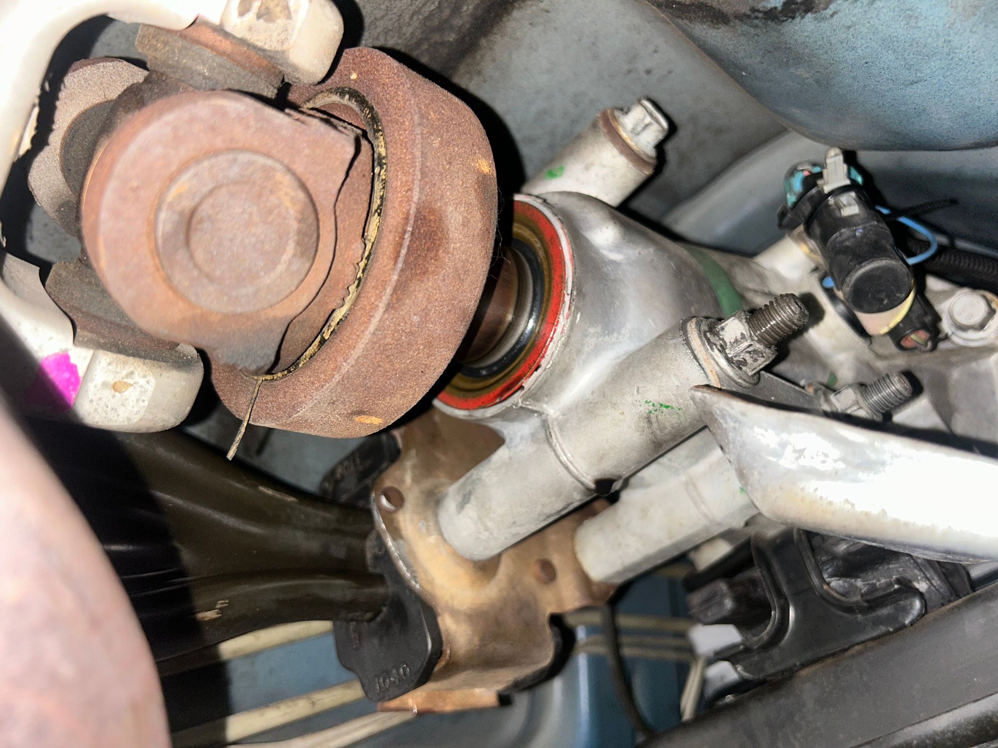

I had Frank’s Custom stage 1 4l60e and a FTI 3200 stall Street Brawler installed in my ‘00 Z28 and he finished today. The drive home started ok but the shifts got rougher the closer I got to home. When I got home I checked the fluid and it was about a half a quart low. I had a little ATF on hand so I topped it off and I figured it’d be a good idea to crawl underneath to check for leaks. Sure enough, the tail shaft seal is leaking. I guess I’ll call the shop tommrow to see what he says. I hope he doesn’t give me any issues since I brought in the parts.

Looking at the color of the oil I doubt its new from trans . Could be melting green assembly gel I use potentially. 1/2 quart low also not abnormal depending on how long driven then sitting before being driven again. In initial start up with a new trans and drive . A lot of air gets churned up particularly in the converter, This will cause softer shifts also . But the air will cause a false reading for full. Then after it sits and air bubbles out . When restarted and run it will show lower and need to be topped off.
Shift quality. While this is stage 1 the shift kit and quality will be the same as all other stages . The shift will be firm not slamming but most certainly firm. Not stock like shifts at all. They will be firmer as throttle is increased. To what extent you feel this will depend on several factors . Rear ratio, converter and of course Tune, It is very typical for tuners to increase line with the stock trans and if so you may want to have this undone. This may make the new trans which has larger feed holes. Higher line pressure , A perfectly flat Rev input drum feel to firm if it has been turned up in the past. Of course I cannot feel the shift in your car myself to make a judgement. But It should feel firm to quiet firm depending on the other factors mentioned and become progressively firmer with throttle. Also note as new friction and band "wear in" shift quality will change some over the first few 100 miles.
I did not of course to clarify furnish the tail housing as I do not normally send those this is what is meant when it's said he supplied it. But I would not be quick to say it's actually leaking either as with the dark color could just be assembly lube that melted.
Most important is top off oil. keep checks for leaks. If you get any codes contact me immediately as while I do use new wiring harness and shift solenoids. New ones do fail from time to time usually if they do it in the first few days . though this is rare. Also note that while off hand I do not remember what stall you purchased that depending on gear ratio in rear any stall 2800 or higher has the potential to set a false code PO757 causing limp mode and no shifts starting out in third gear. This would need to be turned off in tune if it happens but is nothing to be alarmed about and may not happen at all.
If you have any questions or concerns feel free to contact me . Here or FB messenger <always best. And Text of course and call if necessary though I may not always hear phone immediately when working in shop but will return call and or text ASAP . FB messenger is best because I keep it up in my shop on screen all day and of course I check here multiple times a day. But strive to be available always.

I’m sorry to say that the tail shaft is indeed leaking and the installer didn’t want to fix it. I took it up there and when it was on the lift I pointed out that one side of the seal appears to be sticking out further than the other and he replied, “It just looks that way because I put silicone on that side.” I’m assuming to try to fix a leak.. He didn’t want to fix it so I’m gong to have to have it done somewhere else. Are the odds very high that he messed up the housing when removing & the old bushing and seal and installed the new? He said, “I should have left the old seal in because it wasn’t leaking.” “I” refering to himself. Would it be wise to have another tail shaft housing on hand when I have the seal replaced by someone else?

YES if he put silicone on the seal he already knows it was leaking and tried to fix it. Or he damaged the tail housing removing the seal and that was his attempted fix /
May just be he didn't clean out the dip tube and or stick when he put in. It is however normal to see some thus the reason for the 500 mile filter change.
However if he didnt flush cooler? Well" it is flushed now. So little point in flush now. If in doubt I would just go ahead and change the filter now/ TF-351 at autozone as whatever flushed is in the pan now..
