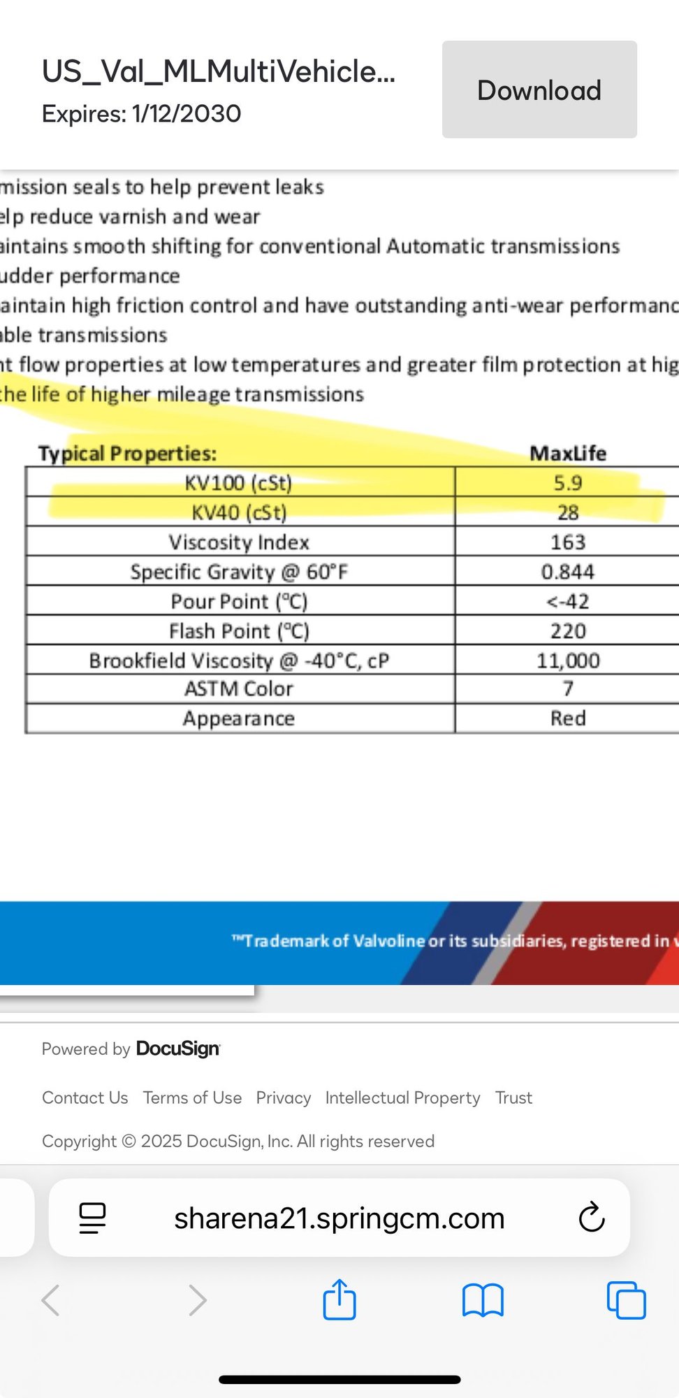

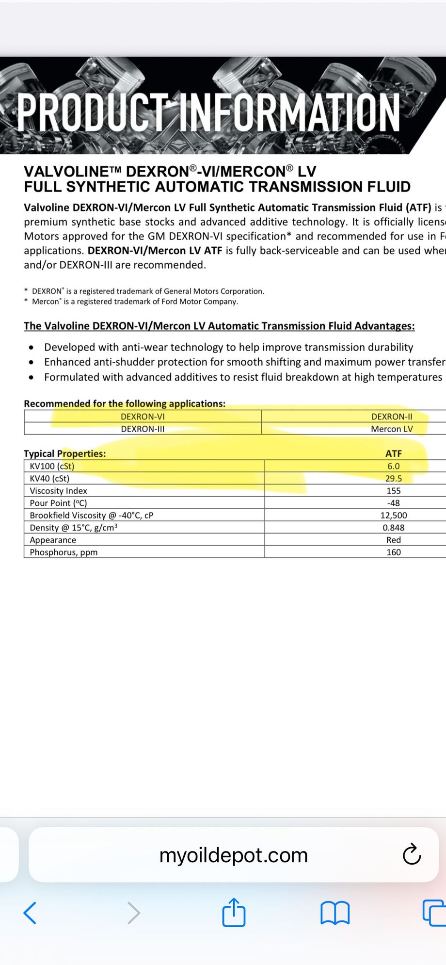

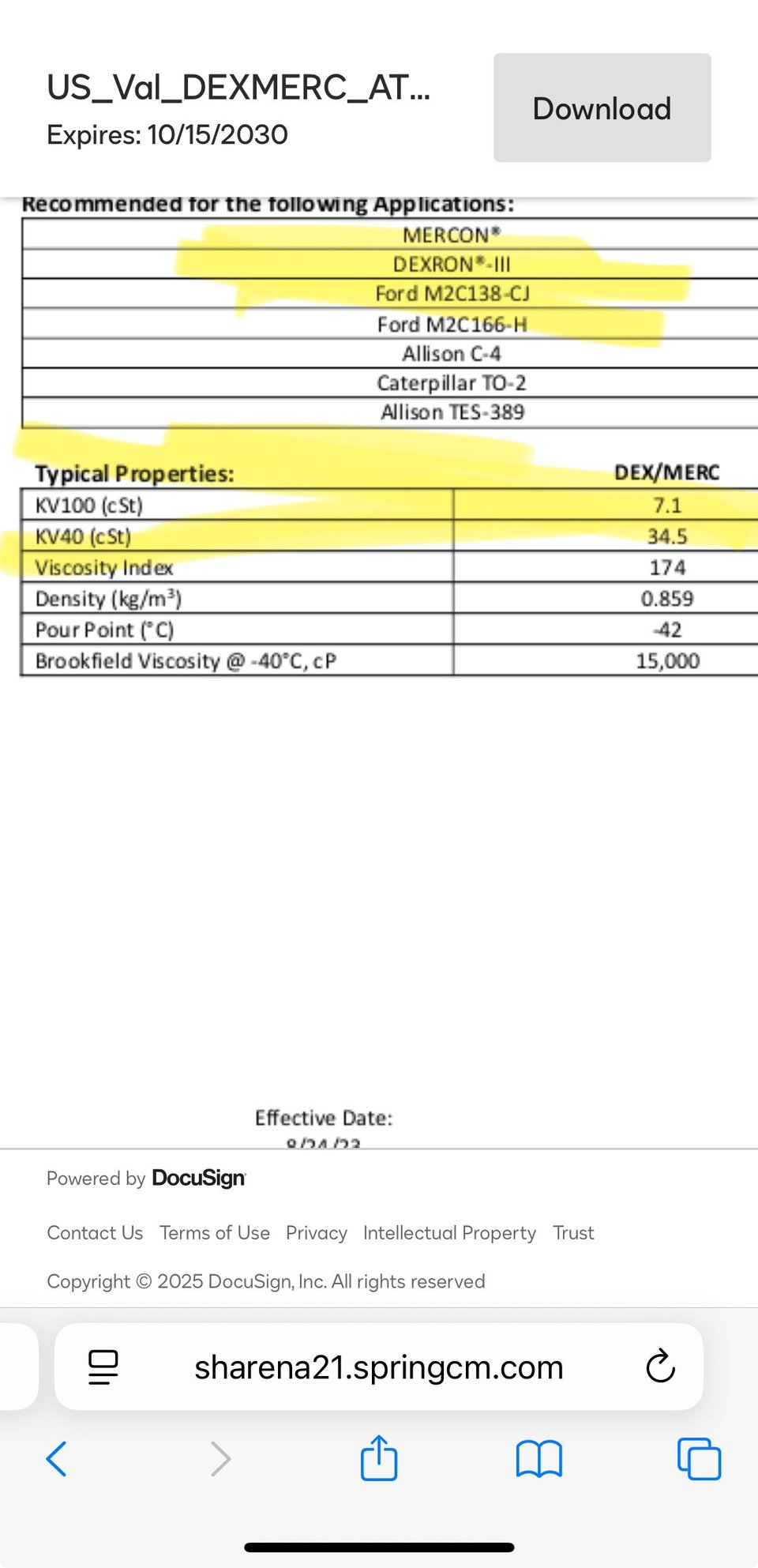

When I had the transmission installed I brought the shop Valvoline Maxlife ATF to use which has about the same Viscosity index as Valvoline’s Dex VII. Their Dex VII is rated at 6.0 cSt at 100*C and their Maxlife is a little thinner at 5.9. Dexron III was/is a little thicker than Dex VII (it was rated in the 7’s at 100*C vs Dex VII’s 6’s) so I thought I would see if a little thicker fluid would help. This past weekend I did three drain and fills with Valvoline Dex/Merc which has a viscosity rating of 7.1 at 100*C. I was only able to get about gallon of fluid out each time so I suppose there’s a little bit of the thinner “Maxlife” ATF left in there. I only have about 20-30 miles on the new slightly ticker fluid but it will almost pull itself on level ground now. It’ll inch forward a little anyway. It also seems to be shifting a little smoother and it has only “clunked” on a slow speed 2nd to 3rd shift a time or two. It didnt feel it in the seat when it clunked this time I could just hear it, so that’s an improvement I guess. I have a little over 200 miles on the trans & converter now. Redline brand has an ATF that they say is speced for Dex III but it’s a bit thicker. It’s rated at 9.5 cSt at 100c* vs 7’s for “normal” Dex III. For something to compare it to it’s like a 5w30 vs a 5w20. I’m thinking about using a couple quarts of it (maybe 4) when I change the filter at 500 miles. Maybe the thicker fluid will band-aid it some more. If it’s mixed with Valvoline Dex/Merc the viscosity would be an 8 some odd at 100*C so I don’t think it’d be too thick.
The take away I guess is that it shifts a little better with Dex III than VII and that if anyone is looking for a little higher stall speed maybe try Maxlife ATF.
