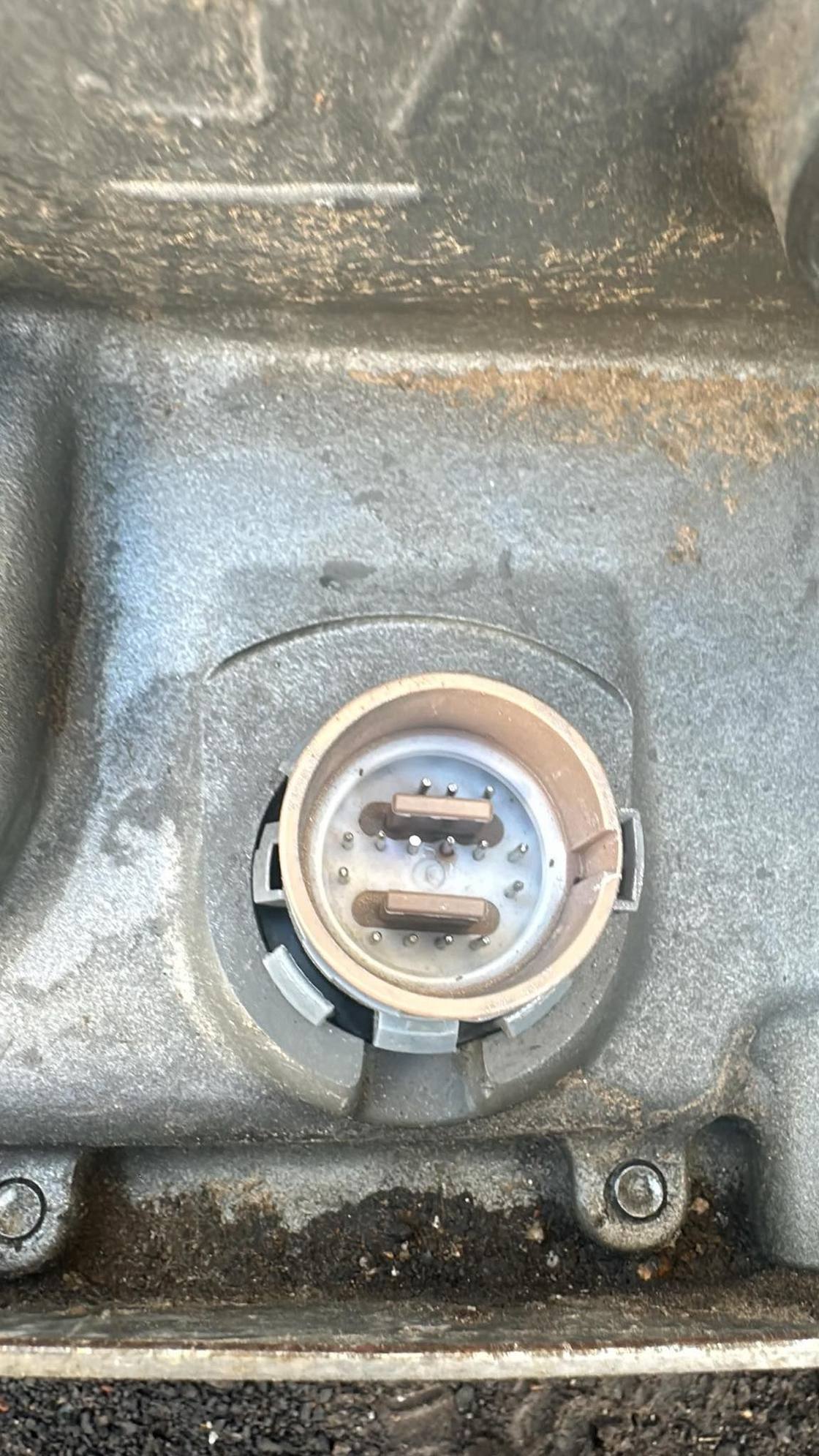

Hello all. I have a 5.3l 07 tahoe 4×4 with the 4l60e which has the 15 pin connector and has lost 3rd gear. I have found a low mile (30k miles) 4l70e from a totaled tbss awd. Would the l70e plug and play with my 07? I plan to rebuild my original in the near future just need to aquire more of the specialty tools beforehand.

All depends on the year of the TBSS unit. 07-08 should be the same 15 pin case connecter. 09 will have 17 pins and will not work on an 07 set up. Internals all changed for 2009....

It is coming out of an 06 tbss. So if it has the 15 pin connector it is plausible?

2006 should have a grey/green 13 pin connector. If you're original transmission has a white/black connector with 15 pins, it has an ISS sensor. The 2006 unit doesn't have an ISS sensor. You will need to delete any code reporting for the ISS sensor.
@vorteciroc (RIP) did a huge thread on connectors.

The connector is black/tan with 15pins and he says it's an 06. Thoughts?

06 was a transition year without being able to see inside you cannot tell if it has an ISS sensor. Pan gaskets are cheap if it has a ISS connector inside up by the rooster comb it would be a direct swap. If it does not have an ISS, you can still delete code reporting for the ISS with HPTuners.
