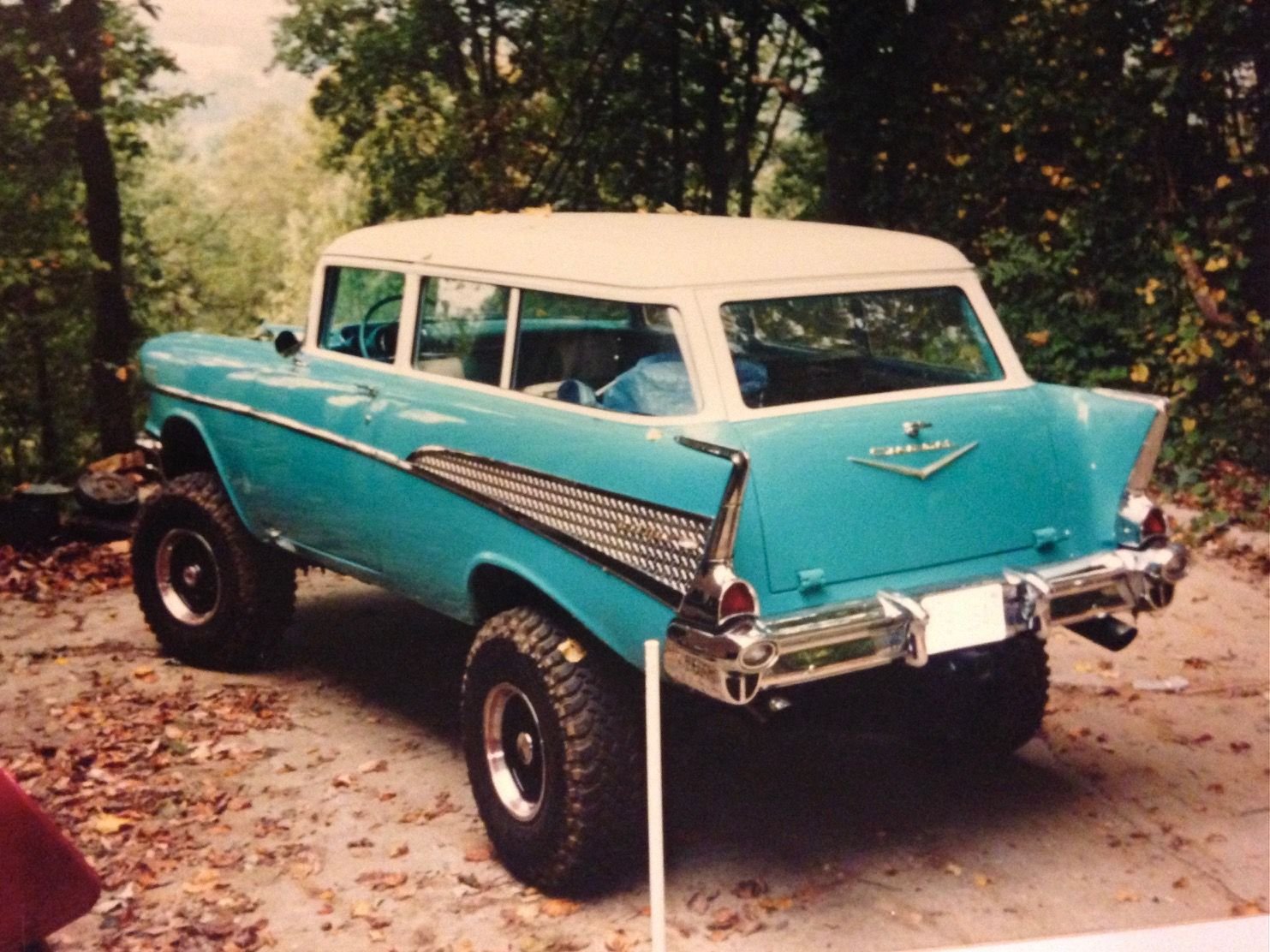

2500HD 4X4 chassis LQ4 4l80E Full-size factory radiator.
2500HD 4X4 chassis LQ4 4l80E Full-size factory radiator with large plate and fin secondary trans cooler.
