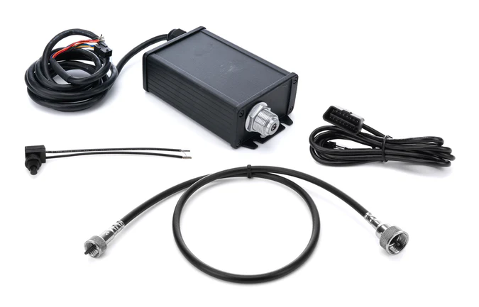

dakota digital makes a box to take the VSS signal and drive a mechanical speedometer. https://www.speedwaymotors.com/Dakot...ad,410403.html. I have used them a few times.
I second this idea. I've used these also. Quiet, smooth, accurate, very happy with the results.

When I first built my A-body wagon I went down this rabbit hole...by the time you get everything you need to convert your tail housing to mechanical drive, you can use Dakota Digitals ECD-200BT-1 converter box cheaper...and easier.
