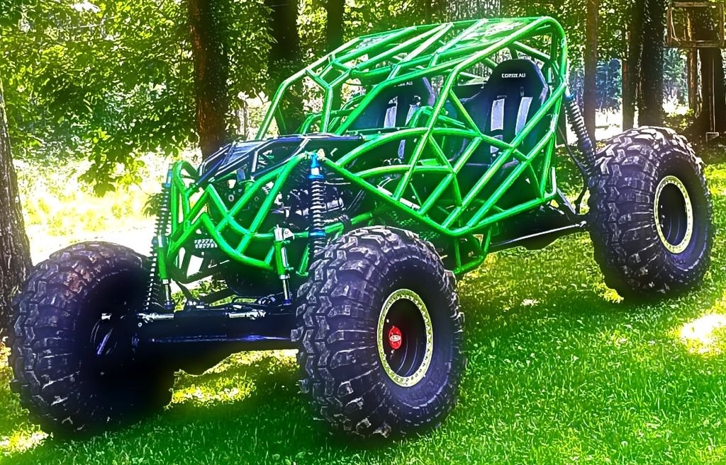

Hey ya'll thanks in advance! In my fairly new rock bouncer I have a LS W/Turbo low miles 400 reverse manual valve body trans with a Winters Shifter. I'm not sure but I believe it has std ATF Fluid in it now, its on the low side and I want to add fluid and get it back to the full mark. Should I add std ATF or can I top it off with what sounds like a better fluid Type F, does it hurt to mix these 2 fluids? Thanks for any input on this! Bryan
Old Oct 6, 2017 | 12:20 PM
Dufftuffbryan's Avatar
Joined: Jun 2017
Posts: 10
From: Friendsville, Tn
Default Fluid for turbo 400
This is my Bouncer,
