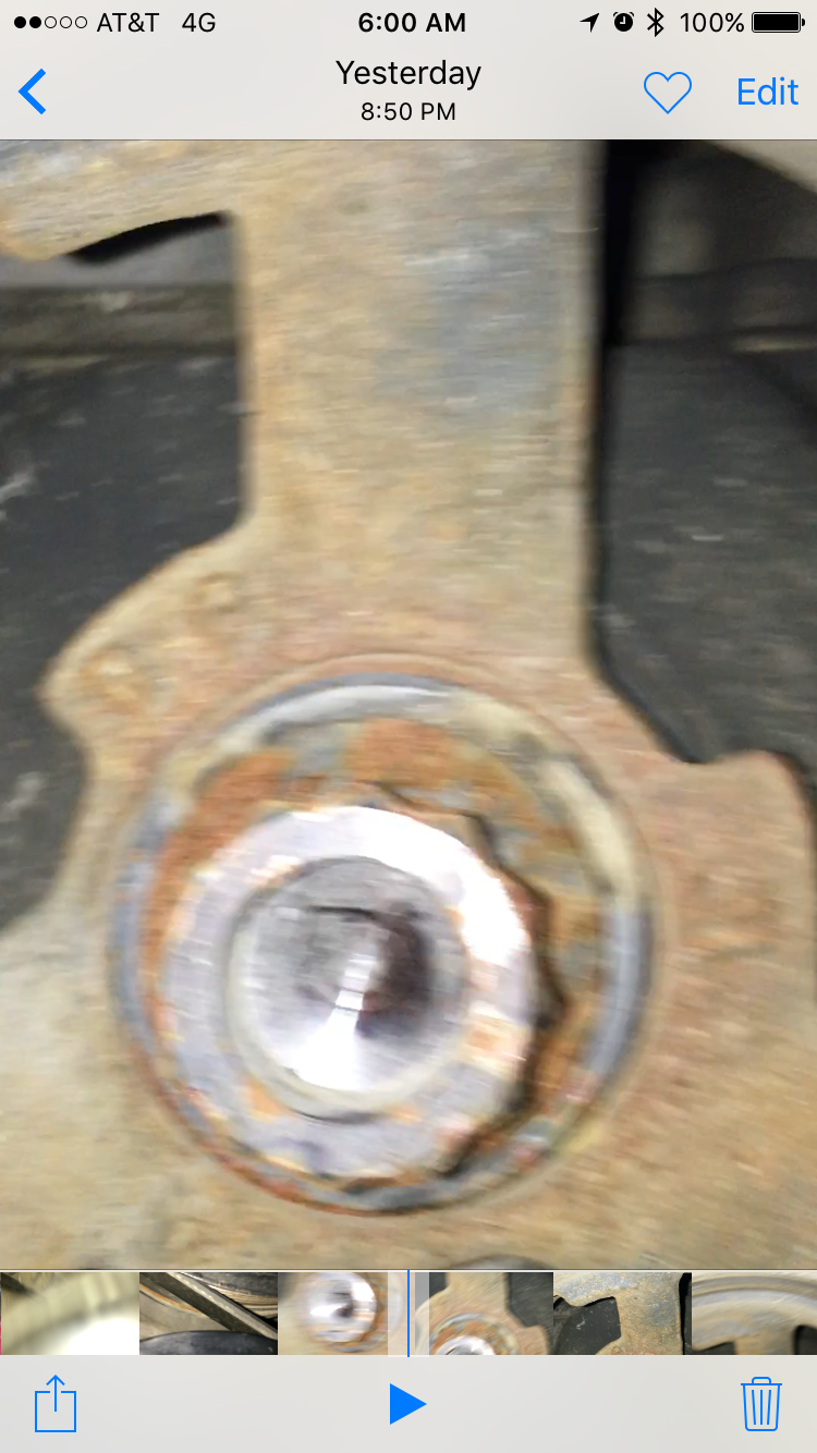

When you were checking the starter did you take a wrench and make sure the connections are tight? I had this issue and the nut holding the power wire to the starter was about 1/2 a turn loose. That was all it took to cause it not to start. Also, did you go through your fuses and relays? Start with the simple checks and work from there. As for that bolt, it looks like it is designed for a 12 point socket.

Before you go too much further beyond checking fuses and connections though, verify that a 12 point socket will fit your bolt and try and turn the motor over like toby suggested. There's no sense in spinning your wheels diagnosing an electrical issue if the motor is locked up. Again, it is a quick check to eliminate another cause that doesn't cost you anything.
