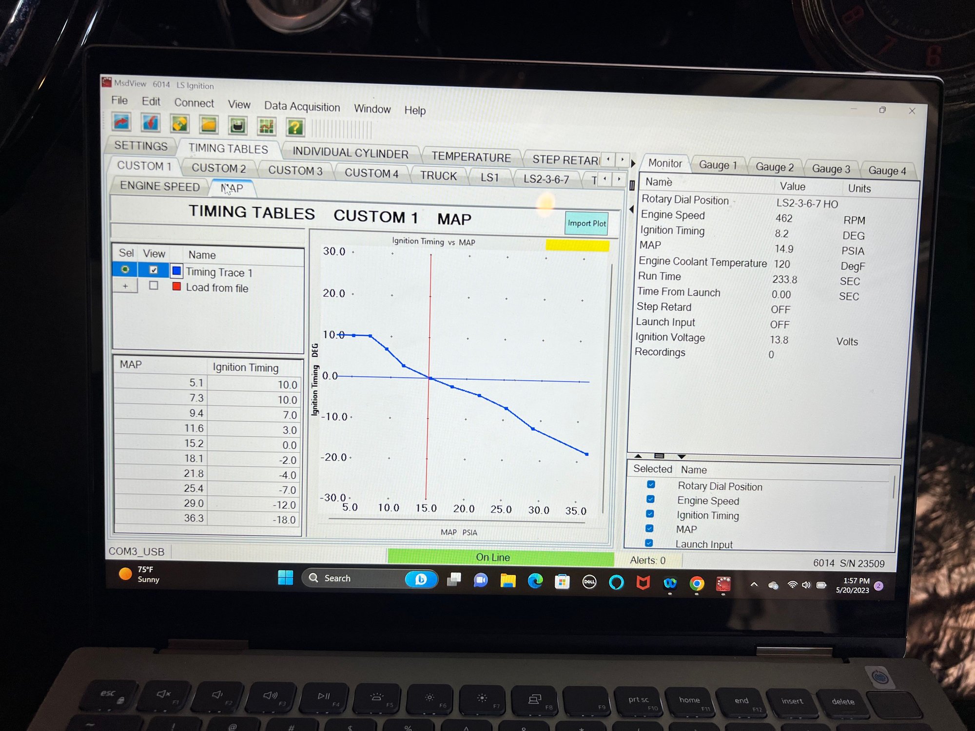

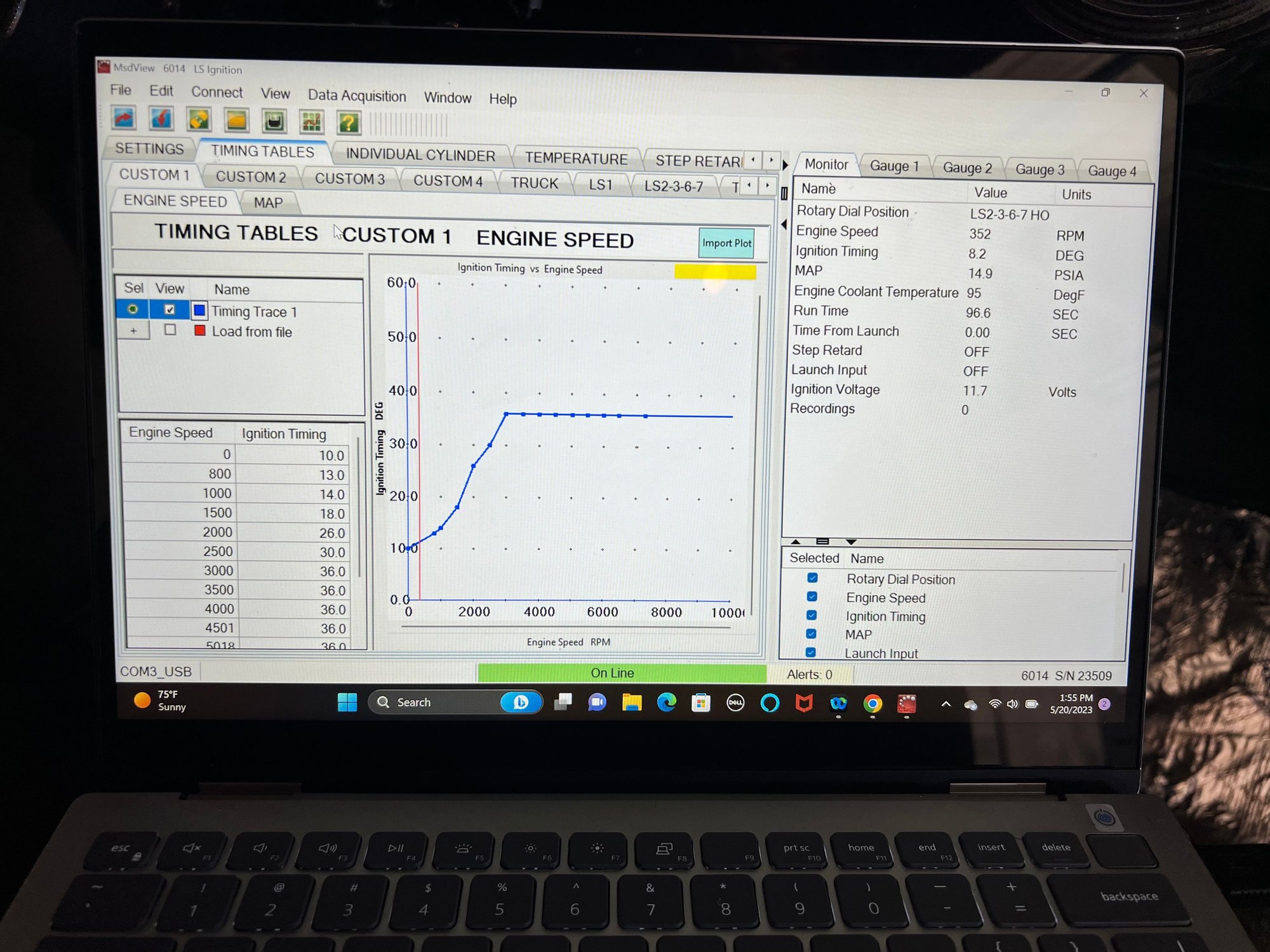

excuse me for reviving this thread. im sorta having same issues. i see that he changed out his msd box for a new one. mine is new. tuned it to 10* at zero rpm, 24 @ 2500 and total of 36. it runs fine. but where im having issues is at IGNITION. i have to give the switch short turns, several times. after like the 5th time itll fire. any one having that issue? is it still timing? the msd box? thanks for the knowledge and yalls time. much appreciated
Post a pic of your curves... timing and MAP
Haven’t adjusted the map whatso ever.
Old May 20, 2023 | 05:37 PM
Doug G's Avatar
Joined: Aug 2010
Posts: 4,468
Likes: 195
From: Harford Co. Maryland
What box is that ?
Looks like it pulls timing over 15" ?
