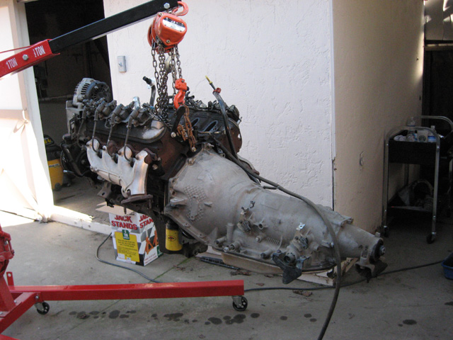

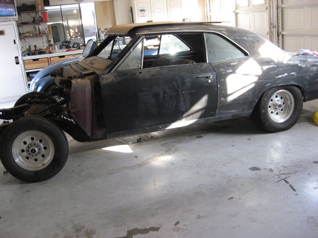

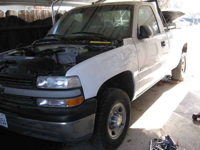

Thanks mred,
I broke a universal and a few knuckles trying to get the tranny split while in the truck. I decided to pull it in one unit and finally got it today. I am hoping it might be a little easier to split out of the truck.
Got this....
out of this.....
Time to start stuffing into this......
