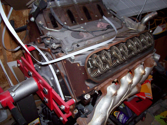

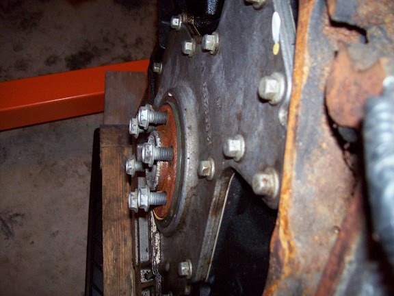

Well from what I gather
I103 means September 10 of 03 with 317 alum heads dbw. Now to find out if its a lq4 or Lq9
Since I was told this was a 06 looks like it was 3 years off.

Looks like possibly an 04 model vehical and probally an LQ9 since thats the same style fly wheel used behind a 4L65E pull out the spark plugs and look for a piston that's close to TDC you will either see a slight dish or completely flat across.
LQ4= Slight Dish
LQ9= Flat top

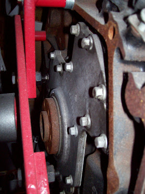

Thats a 4l60/65E flexplate, so probably a LQ9. Just pop a plug and check it out though!

The flexplate theory doesn't work bexause the h2 has a lq4 and a 4L65e. The easiest way is to pull a spark plug out and look at the piston.

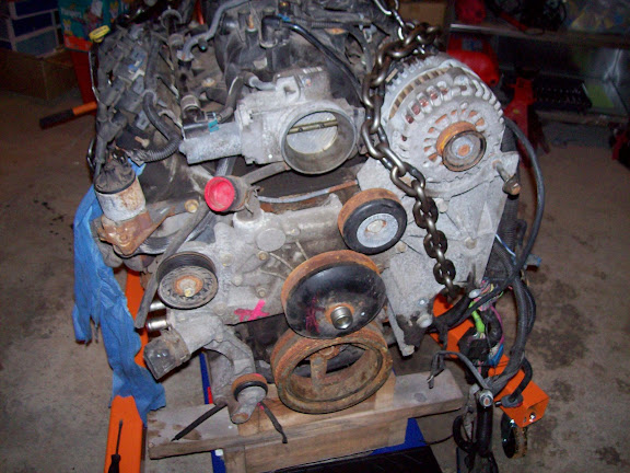

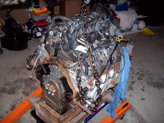

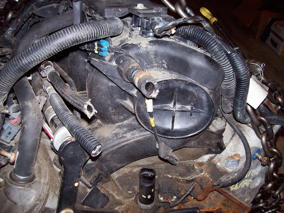

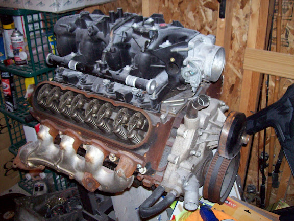

I'm still confused on this one.. I will pull a spark plug tomorrow to look at the piston, but perhaps someone can shed some light on this for me.
Plus, I have pictures of two different motors that might help someone else in the future.
1.) 99/00 LQ4 motor. Notice the cable driven throttle body.
It has Iron Heads (though I don't see an actual casting number printed anywhere.. they are clearly iron heads).
Here's the back of the intake manifold for the port that is plugged on this one.
Here's the back of the crank.. note the big flange.. which is what prevents you from hooking this up to a T56... which is why I bought a new motor.
2.) LQ4 or LQ9.... I'm not sure???!?!?
It has an electronic actuated throttle body.
It has aluminum 317 stamped heads.
It has an open tube on the back of the intake manifold.
No big flange on the end of the crank.
All this talk about codes stamped on the blocks... I'm at a loss on this topic. The newer motor seems to have a K#00 on the front above the water pump. But the old motor also has something ending in 00. So that doesn't help me. The laser etch on the back is 12559287.
It's missing the oil filler neck.
I'm confused... Clearly it's a 01 or newer LQ4 or LQ9 motor because it's got 317 aluminum heads, the right crank flange, etc... But is it an LQ9... it's got the open tube on the intake manifold? Can anyone help me???
