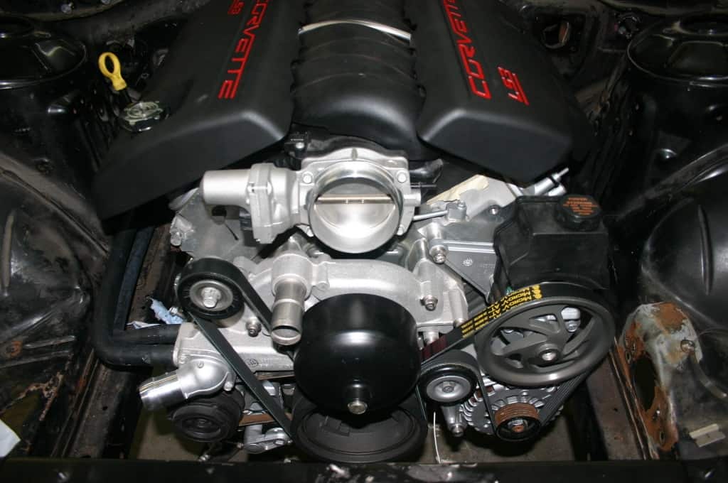

I have just completed my build of installing a L92 from a 2007 Escalade into my 97 240SX. I thought I would share what I had to do to keep the VVT on the motor and make the Camaro front accessory drive work. Since the cam cover is so thick due to the VVT solenoid you have to keep the truck crank pulley. So to make everything work use the following:
I hope that this might help some of you guys out. The .75" spacers were made from 1" aluminum bar stock machined by a friend of mine.
Here is a pic for reference during mockup:

Did you have a truck water pump to mock up? I'm curious what kind of clearance issues it had with the TB. Didn't someone say recently that they were able to dimple the tube in the truck water pump to make it work?

hey man, this is pretty helpful. I just got a Ly6 and Im wanting to run the L76 intake and I was confused about what to do with my accessories to get it to work. if you dont mind me asking, what intake is that you are running? and this may be a dumb question but when you say a car water pump or a corvette pulley, what exact camaro or corvette are you talking about, or does it matter? and are these parts that i can go get from my local advanced? thanks for the help
![Default](https://ls1tech.com/forums/images/icons/icon1.gif)
F-body w/MAST car WP spacers. 05-07 Vette access. drive & WP

Just curious why you changed the water pump. I am currently trying to move the L92 Alt to Drivers side low (tucked in) and L92 PS to drivers top with LS conversion brackets. Both will need the spacers you spoke of (3/4")on the brackets to match the existing water pump but it looks doable. I just have to get some 5" X ?MM bolts.
PLEASE shoot holes in this theory before I spend useless money. For what its worth, these brackets are inexpensive $10-$20.

The truck water pump interferes with the throttle body and the outlets were in the wrong direction for my setup. It sounds like you want to put the alt and ps pump in the same locations as the F-body stuff. If you can find some brackets that will do that then go for it. Otherwise I would just sell the truck accessories and buy some F-body ones. Good luck with your swap.

1998 Camaro PS pump works with this. Just need to find the belt size you used. Can't read it from the photo.
Thanks! You saved me a bunch of time!
PS the truck idler wheel I hoped to use had to go. Its diameter is just to tight for belt clearance. Have a camaro one en route.

the corvette tensioner? Why not a truck or f body tensioner? I know the truck acc are 3/4" out further than f body but I thought corvette were somewhere in the middle and that has me scratching my head as to how the vette piece works for you? Did you space it out from the block also? Finall is that a vette water pump or an f body pump? You only mentioned it as a car pump so I am trying to see a bit clearer what all you did.
Thanks a TON. Great thread
