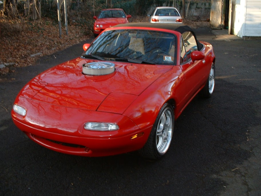

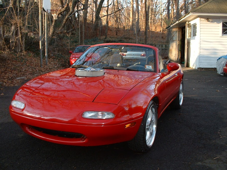

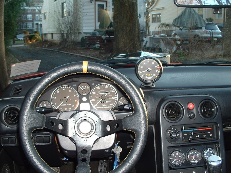

On Thursday night we bled the clutch and brakes, fired her up, and drove her out of the garage under her own power. It felt soooo good. All 7 gears work, as does the clutch, brakes, hubs, halfshafts, and everything else. I only got it up to about 7 mph in our driveway, but it felt like it wanted to leap off the pavement with its copious ammounts of power. My dad and my friend told me it shot out flames at 2000 rpm in reverse. We let it idle for about 20 minutes or so, it runs as consistently as time passes in the day with a solid 40 psi of oil pressure. We aren't gonna take it out until its registered and insured. As 96civic mentioned, now is not the time to rush things. Until then, we have a checklist of minor things to do to it.
-Finnish exhaust
-Make taillights illuminate when the head lights are on
-Install Edelbrock Fuel Pump Relay
-Make ammeter gauge function
-Inflate tires
-Replace clear coolant tube
-Fix the handbrake seize problem
-Insure the gas gauge functions properly
-Get the car on jacks and run it so we can listen for strange differential or other drivetrain noises
-Get proper turn signal bulbs
-Install coilovers
-Install the correct alignment lower control arm bolt, for the rear of the front passengers side. (Take from a 3rd Miata we have sitting out back)
-ReTorque all drivetrain bolts
-Finnish filling up the Differential with oil (almost filled)
-Wire tie the loose wires under the dash
Heres how she stands now
Favorite Pic
Now I just need my coilovers 2 arrive 2 get that back down lower

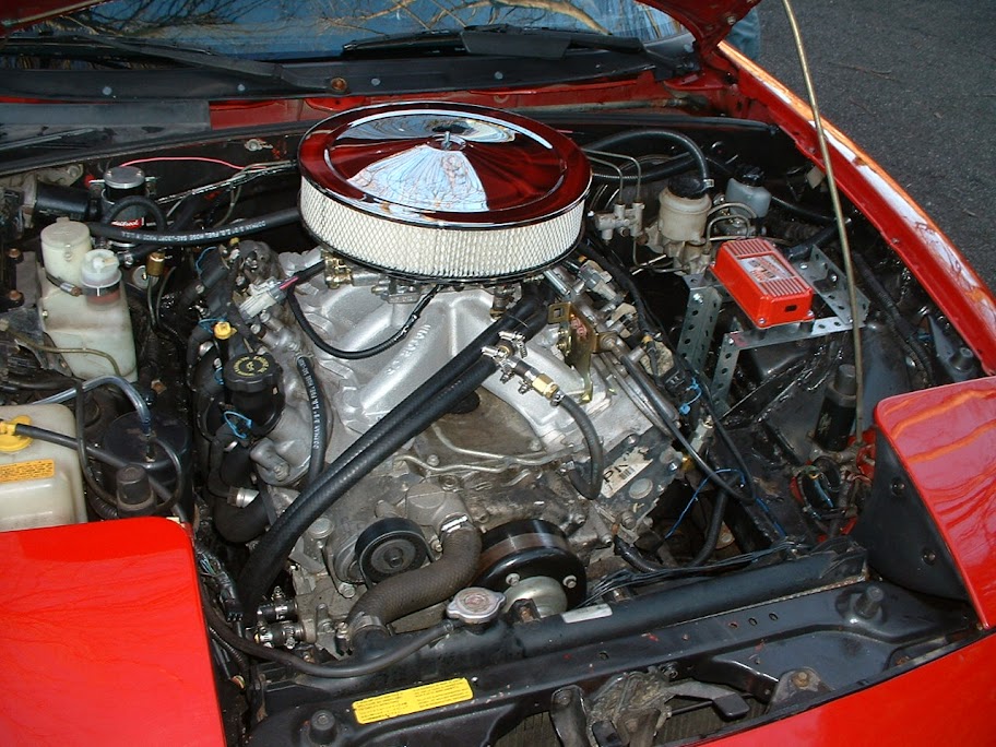

Most definatly agreed...everything else on the car is "trick" why not put on a 4" cowl??? Also why did you carb instead of fuel injection??? One more...in your opinion do you think the 4 lug pattern will hold the torque under full acceleration???

I dunno, but I think he needs a piece of rail in the trunk to hold that joker on the ground! What cam did you go with? I would suggest a Torquer V3 in that little joker!

Thanks man, people should question what rests beneath the hood of this thing
I like the cowl hood Idea, but I'm running out of Ls1 funds. Next on the list if anything will be a new radiator, followed by a cowl hood, a front lip (I still have some rice in my veins), then a new cam. I was wondering about the four lug strength myself as everything in the rx7 TII drivetrain is four lug; the driveshaft and each halfshaft are held inplace by four bolts. From my research it seems that these rx7's which are heavier then my Miata survive repeated hard launches under 700+ hp and 400+ lb of torque. I'm pretty sure everything will hold up, but we'll soon find out
I'll be in the market for a new cam probably around summer and will most likely buy a used one from someone on here. I want one that has as rough an idle as possible without the requirement of changing the lifters, pushrods, or valve springs. Is that the deal with the Torquer V3? If someone on here could recommend a cam like that to me I'd appreciate it.
We finished the exhaust system over the weekend and it sounds really really good. I can hear how well the engine runs, there's nothing loose, no taps or anything, it just purrs like a kitten. It turned out to be mostly straight pipe aside from a couple of small bends and the 90 degree bends on each side from the headers to the underside pipe which we got by cutting a mandrel u bend in half. The rest of the bends we created using the straight pipe. We cut out the section on the inside of where it had to be bent while leaving about in inch uncut on the outside. Then we closed the gap to form the bend and welded the gap. We did it so that there aren't any kinks or crimps, the entire system is 2.5" on each side...aside from the Sanderson exhaust flanges which are 2.25". Then we hung it in 3 places on each side, and clamped it in the necessary spots. The two pipes exit about a foot apart, right under the license plate. My dad thinks it looks like a Corvette, I think it just looks real cool. Its still pretty loud with those pypes m80's and I can tell it will be really loud at wot, but its now mellow enough to drive by a cop at 2000 rpm without him or her giving a second thought. Thanks again for the input guys, Happy Holidays!!

your not gonna get out of changing to a stiffer spring or hardned push rods. nature of the beast. bust a spring, loose a valve, then a piston, then a motor maybe, not worth it, when a set of springs can be had for 300 buck and a set of rods for another 100 or so.
Your right, when I do the cam swap I'll upgrade the valve springs and push rods.
