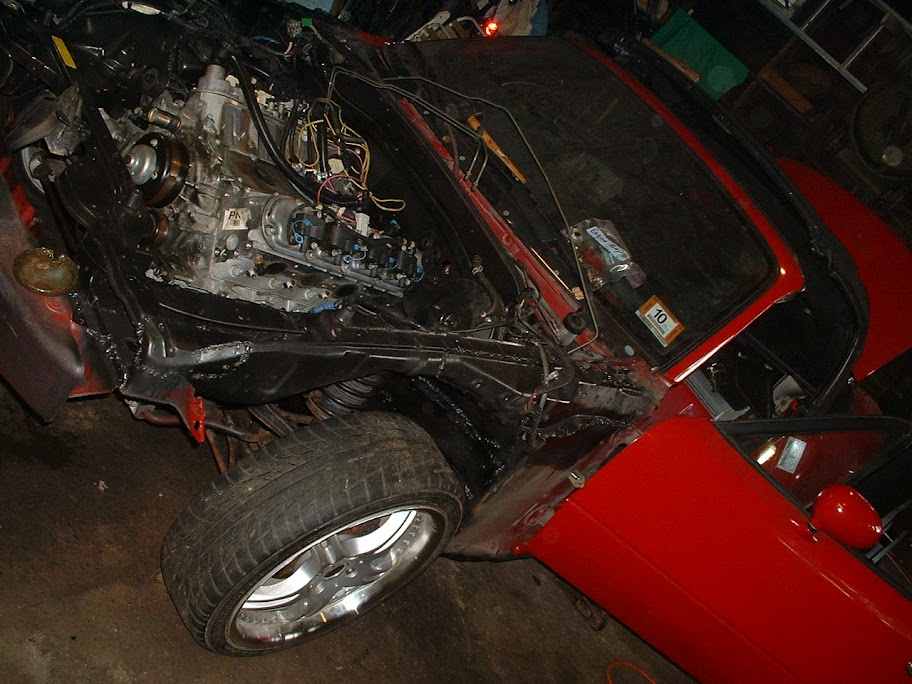

Here's where its at now: its sitting on four wheels with the engine mounted less then a 1/4 inch from the firewall, the trans is in securely mounted to the crossmember, the rx7 TurboII rear end is in place, anchored by a home fabricated torque arm that bolts to the 3 studs on the case, and attaches upfront around the transmission crossmember. Also the brake system and clutch system are back together and cooling system is almost completely in place. What’s left (sort of in order): Put in the headers and finnish fuel system, test run the engine, put in the steering column, the carpeting, dashboard, the starter, alternator, put in the driveshaft I’m going to order tomorrow, finnish the installation of the summit mechanical gauges, make an exhaust system, install the wheel hubs from MiataRoadster that allow for the rx7 half shafts to fit in place, put in the half-shafts, put in the rest of the interior after it runs, along with the fenders bumper and hood.
Ohh yea, sitting on top of that 346 is an Edelbrock high rise intake manifold accompanied by a 750 Edelbrock Carb...

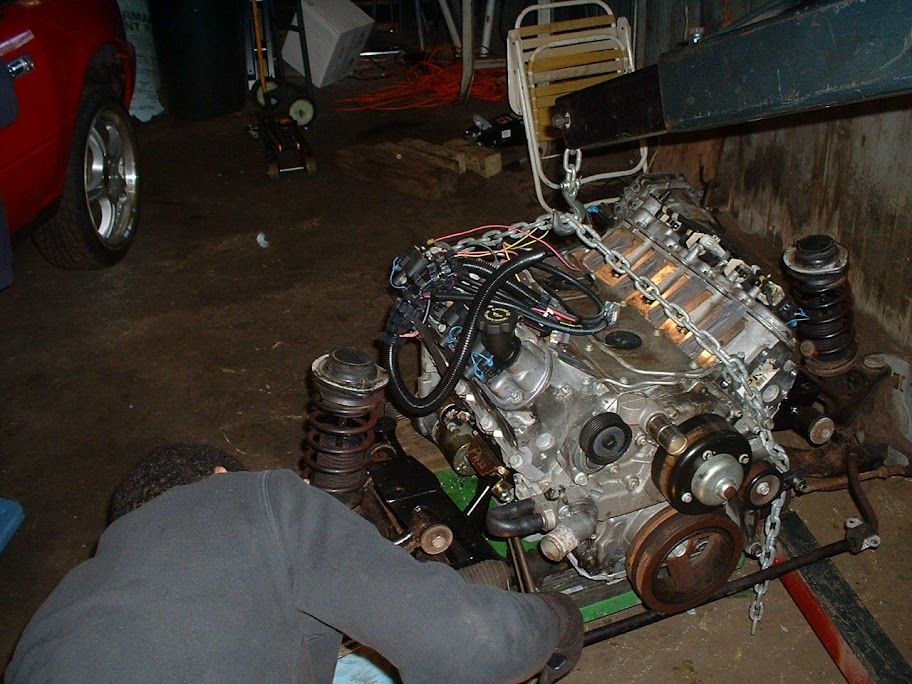

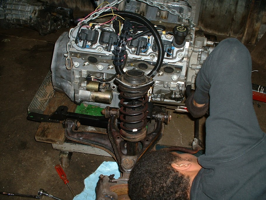

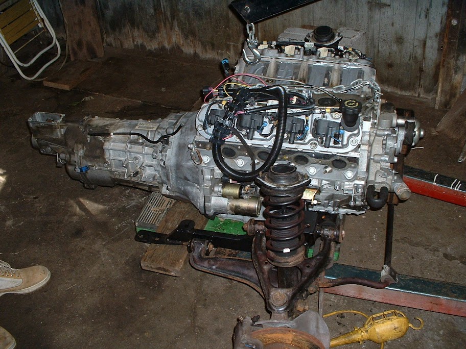

What am I missing? Hmm...an engine stand would be quite nice
Took the oil pan out so Shandelle at V8roadsters could modify it
Came out terrificly

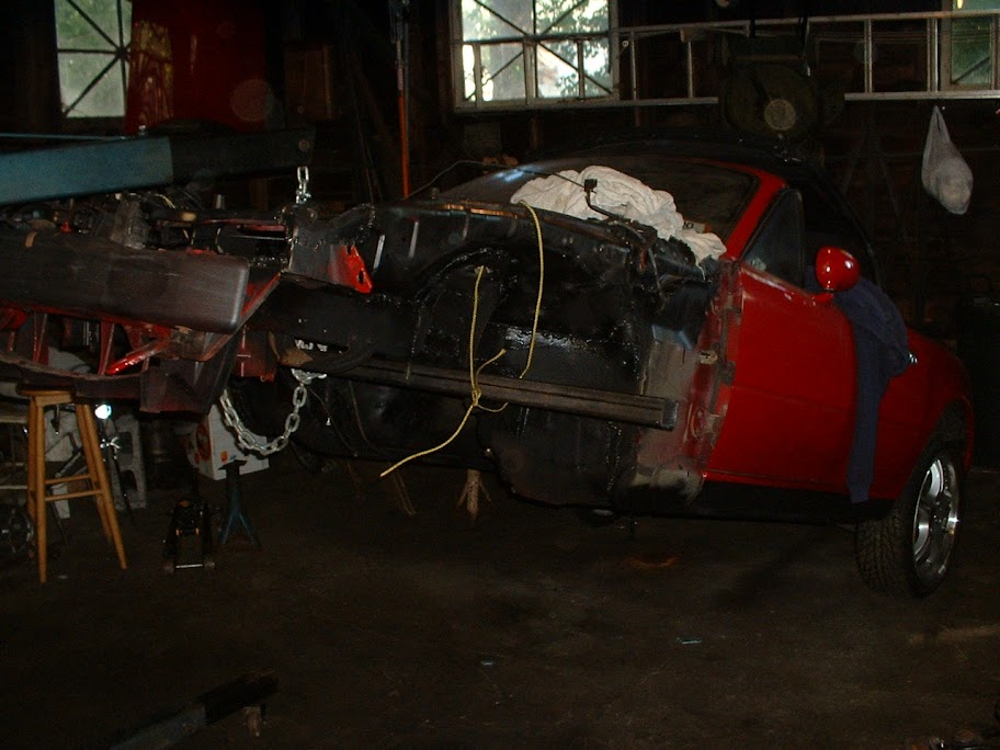

We decided it would be a better idea to take one out of the 'factory' page and lower the chassis onto the engine
Fits in there like a glove. The shifter even comes up through the center of the trans tunnel, right where the stock unit did.

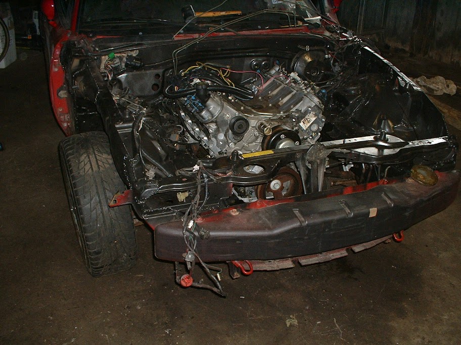

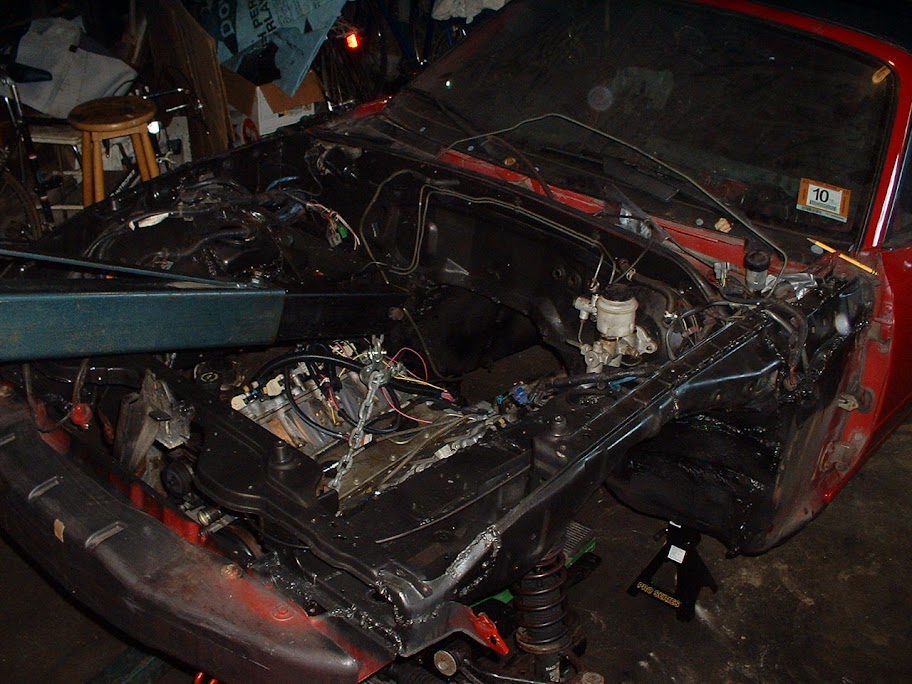

As close to the firewall as possible

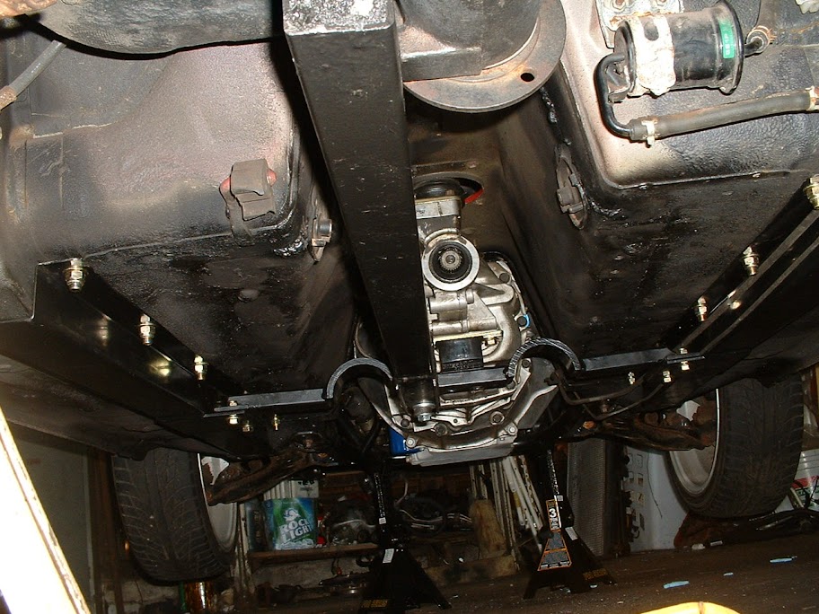

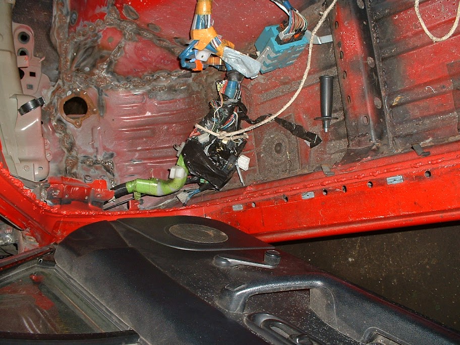

Weird camber angles anyone? Someones gonna need an alignment. Luckily the ingeniously designed v8roadsters k-member allows for all the stock alignment adjustment properties

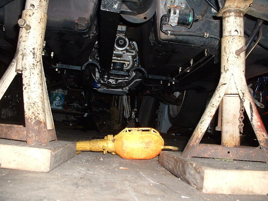

Nice ground clearance

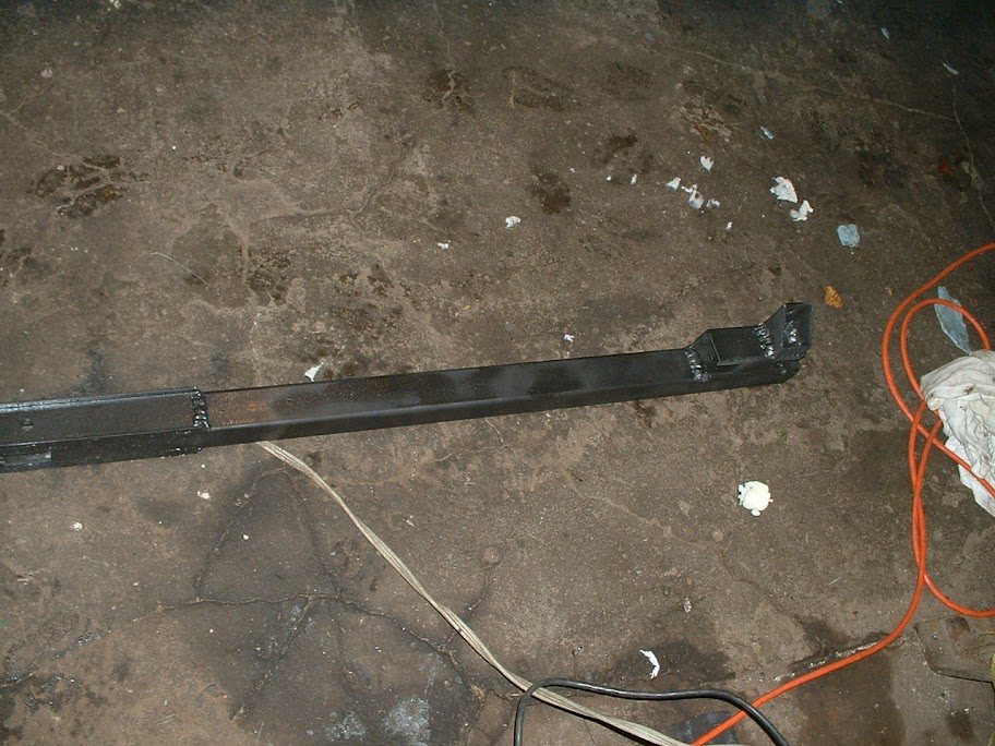

Painted the rear end

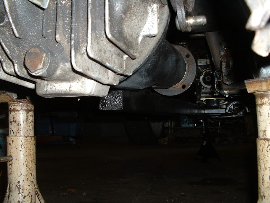

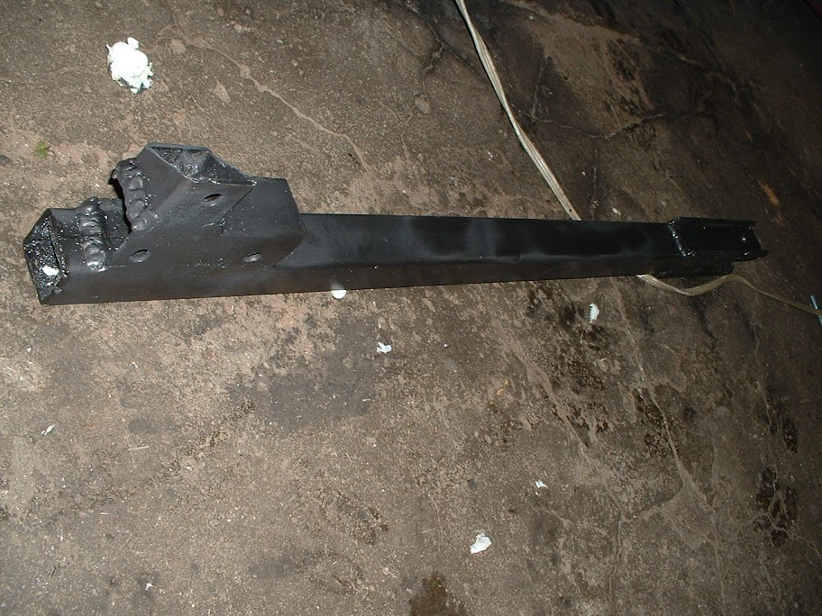

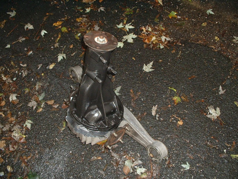

Torque arm, we filled it with foam to prevent rust
Looks good if I do say so myself

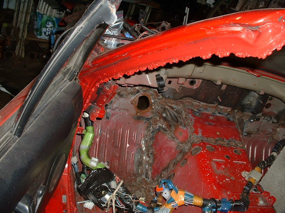

What kind of welder are you using? Some of those welds look kinda scary. If you have not driven an LS Miata, you have a lot to look forward to! Just be warned, you get used to the power fast and only want more. haha
I know man, my gasless-mig produced some unattractive welds, but they're strong and will serve the purpose I want them to by holding the thin layers of sheet-metal that make up the unibody together. For the Torque arm however, I used a true MIG welder at my High School for some exterme penetration, overkill welds. The fastest car I've ever driven was a 2008 Porsche 911 (less hp and more weight then my Miata) owned by a traffic court judge, so I think I'll have allot of power to get used to.

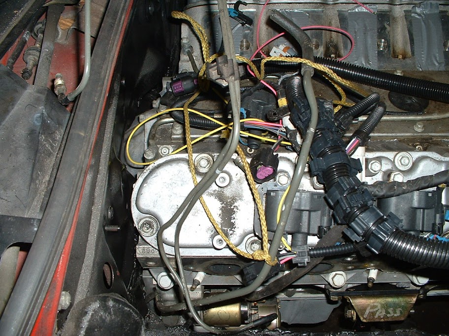

Well, everything is connected, all fluids are in, and the engine is ready to fire up. We hot wired the starter and it spun, but didn't make contact with the flywheel. So we pulled it out and hot wired it outside of the car. The gear slid out and spun fine, so we thought that because we swapped from an automatic to a manual transmission that maybe the starters are some how different. It seems that is not the case. So here is the question, what's wrong? Why is the starter working but not connecting to the flywheel? If you guys can imagine, we are sooooo close to making this sucker run for the first time. We really wanna see and hear this happen. Any help would be greatly appreciated, thanks.

It was late last night, both my father and I were very tired. It turned out we were simply hot wiring the starter incorrectly. The engine cranks fine now, should start up tomorrow.

Made some helpfull comments about the build in your thread in the "External engine" section regarding the starter issue. Thought I was posting the comments here, but somehow got posted in that thread. Have a look.

A few comments:
-Keep an eye on that water bump. The 4 bolt pulley indicates an old style pump. May want to get a new one. There may not be much life left in that one.
-What rear end is that? You need at minimum a Ford 7.5; 8.8 is better or an RX7 style. Also, need a ridgid rear end mount, not just poly mounts & torque tube.
-Need minimum upgraded front springs (coil overs). Fronts & rears preffered. It will be dangerous to drive the car on stock Miata suspension.
Build is comming along nicely. Just be responsable & careful while driving it. I call mine Death on wheels when operated in the wrong hands. In other words when driven carelessly. It's one thing to see the driving Court Judge about a ticket & quite another to be involved in a serious accident.

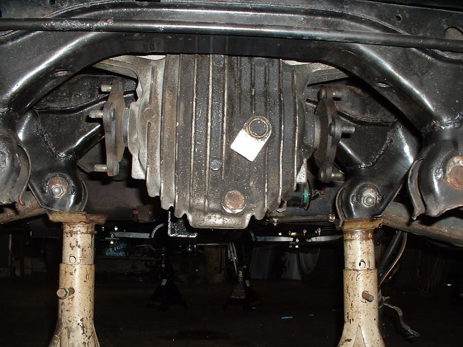

I'm using an 87' Rx7 Turbo II rear end. The way I have it mounted is extremely strong, why do you think my set up is unstable? This is how they are mounted in Rx7's that make in upwards of 700 hp, except for the torque arm which will add even more stability. Think about it, the rear end is going to want to torque upwards, meaning the torque arm will also. The downward weight of the transmission as well as the strength of the trans mount will prevent the upwards movement of the arm. I don't want to sound like a douche, but I haven't seen a stronger set up then mine in a Miata with a TII rear. As for suspension, I have to get my 1.8L sized Torsen LSD sold to fund the purchase of the coilovers I want, and I'll cross the water pump bridge if I come to it. In any case, thanks for the input.
Well....guess you don't need us then. My LSX powered Miata has been in service for 7 years now. Long before the recent influx of too many Miata swap kit companies & "swap experts." I promise you that my rear end strength & set up puts yours to shame. Your mounting is weak & wheel hop will be an issue.

are you not going to metal finish ANY of those welds?
"exterme penetration, overkill welds"
you know having to much penetration creates a stress riser and makes it actually weaker than a weld that is properly done?
I got the welds on the torque arm just right. The box steel I used was very thick
have an upclose pic of one of the welds? how thick was the material

Thanks for the input man. I spent easily 20 hours practicing welding different sizes, shapes and thicknesses of steel on different settings before welding the Torque Arm together. I know about the foam rusting theory from reading about people filling their frame rails with foam. No moisture was in the torque arm when I filled it with the foam. I did chuckle at the beaver comment, but I assure you, that Torque Arm is ugly, over built, and extremely strong. It will never break. The chassis welds were all done with a crummy gasless wire mig. I did the best I could with what I had so all the welds are ugly, but strong. By the way, the trim does fit back on, and the transmission tunnel was welded on the inside and outside
that much heat, you prolly weakened the material around the weld and did more harm then good, welding on one side with the proper penetration is plenty.
Guess you've never welded with a gasless mig
Old Nov 1, 2009 | 01:52 AM
Shinsetsu's Avatar
Joined: Nov 2004
Posts: 273
From: Newport Arkansas
No I havent, but if that is the way it turns out then I dont want to, those look like crap. I would have atleast done some metal finishing to make them a little more astetically pleasing.
proper mig weld on 3/16 steel
the penetration from a proper weld, why would you need to weld again? all it does is weaken the metal
and incase you were wondering this is a tig weld
are you taking any classes on welding or are you just doing it yourself?
