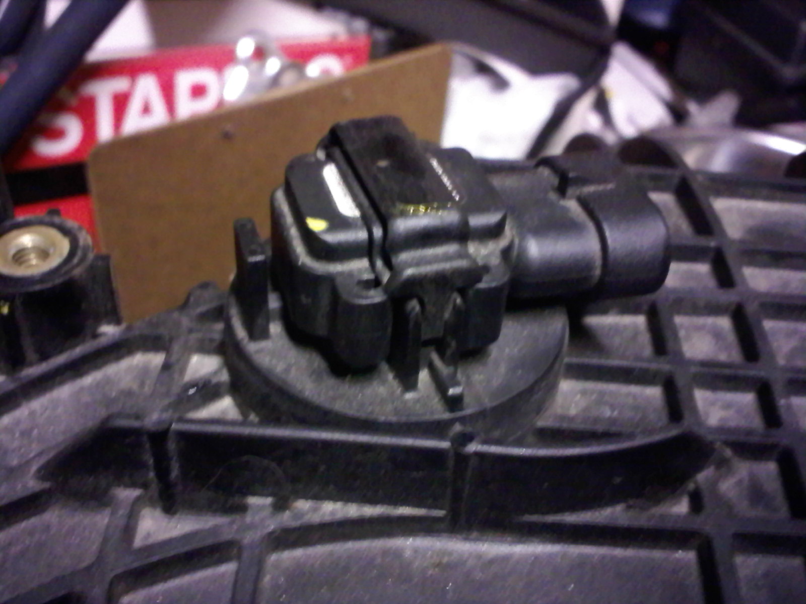

how do i get this map sensor off without breaking it, and where should i relocate it on a carbureted setup

Use a small screwdriver to pop the strap off. Next pull it out of the retainer clips. It wont be in there very good
Once its out youll see if has a rubber grommet (discard) and a ported manifold bung. Hook a vacuum line to the bung and connect to any vacuum source
