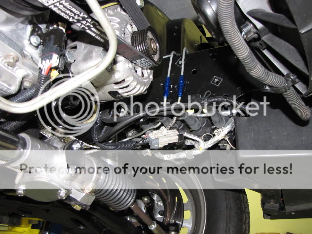

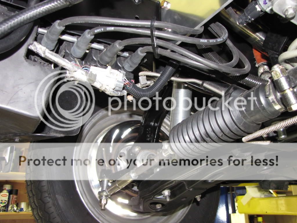

LS1MCSS's Avatar
iTrader: (18)
Joined: Jan 2006
Posts: 3,831
Likes: 8
From: Dover, Arkansas
Here is where I have mine mounted. Not sure if you can mount your like this or not.
Old Feb 2, 2010 | 08:12 PM
lamdenali's Avatar
Joined: Aug 2009
Posts: 258
From: Monsey NY
No my fuel rail is in the way there. I like the way your look
