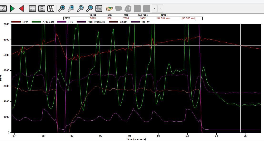

and since the last time i dynoed the car there has been two issues that have been giving me a hard time; the first one is an issue with the boost reading of this thing; on the dyno it made something around 18 psi on the wastegate actuators it had on it ,,, which did not make sense at the time but i was happy so i didn't care
after a while the car stopped making the 18 psi like on the dyno and now would not go past 8 psi . i tried adding preload tot he waste gate actuators to try to eek out a few more psi but no luck. so i assumed there was something wrong with the actuators before and then they got to work properly later since they were rated to 8 psi. i did check all the wastegate lines and everything was in order. so got a new pair of wastegate actuators that are the 17-18 psi version and just installed them to see if they fix the boost issue .
the other issue i was getting was a missfire under WOT after 4500 rpm where the car would buck violently under WOT . i tried swapping plugs from TR8 to TR6 , swapped plug wires , and coils with new ones but with no luck.
so i took the car out this weekend to a local race spot , and did a few passes to see if i fixed anything ,,, and oddly the bost is still at 8 psi ( and since i did nothing to the missfire it was still there )
the logs show that the boost hits 8 psi and flattens out , and you can see the AFR spikes when the missfires happen . the fuel pressure is rising with boost and holding steady for the most part.
i'm not really sure why this is happening , but i think there might be one of two possible reasons ; the first being that the air filters are restricting the air going into the turbos , and the other is that the BOV's i'm using are opening under boost .
as for the misfire ,,,,, i'm still scratching my head ,,, i'll try a new set of coils to see if that helps . i'll aso see if i can clean the filters to see if it makes any difference , or maybe run the car without them or install a better set.

What coils are you using, what plug gap, what ecu, what dwell time etc ?
What are fuel mixtures like just prior to the misfire and do injector pulse widths change dramatically at this time or stay sensible ?
Widebands will not report accurately during misfire events so that is fairly normal.

as for the mixture its ok at 11.7-11.9 just prior to the misfire , and right after the miss happens it shoots up to 23-24:1 , the pulse width soon follows the afr to try to correct the lean spike then settles back down . fuel pressure acts weird sometimes after a few of the misses and not all of them; the pressure dips about 10 psi after the missfire ,,, i thought that was because of the back fire lowering the boost and thus the signal the regulator is seeing , but boost never drops....
so from the above i can assume that the car is not back firing through the exhaust and not the intake , and it doesn't do it becaue of fuel pressure drop ( the drop in pressure happens after the miss) . so this leaves me with the ignition as a culprit.
i'll try to swap coils first , check the plugs again to see if there is anything to see , and maybe try to move the main harness around to see if it it could be some electric noise.

If you're open loop, then the ecu should not be trying to correct anything.
If injector PW's are changing, something either MAP or MAF signal is causing it to change.
What ecu are you using ?
And the rpm trace is looking a bit odd during the problem too. Is the cram/cam signal good ?

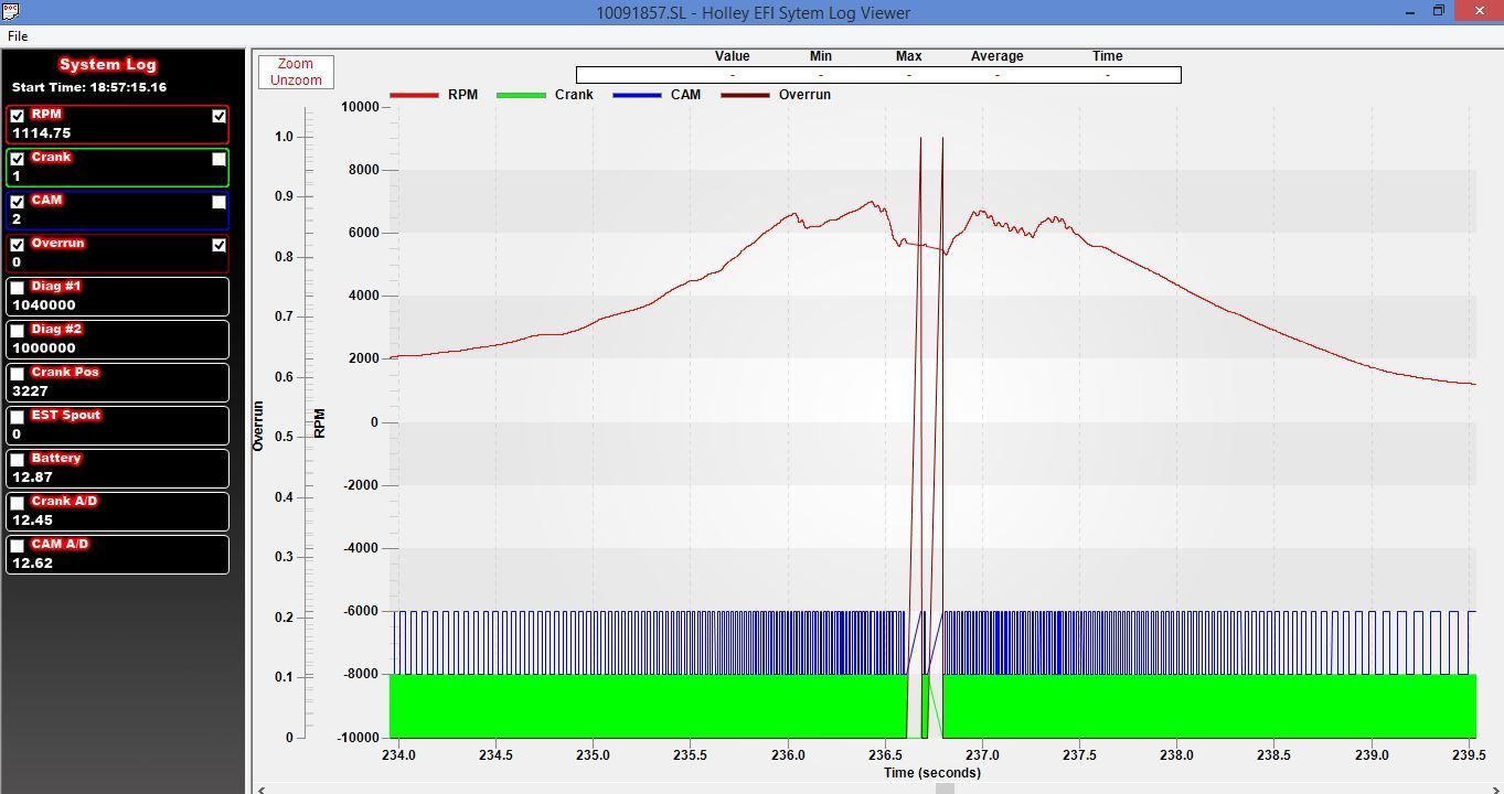

the rpm trace is like that because that is how bad the miss is . the cam and crank signals seem to be perfect. I should run an internal log of the specific signals to see if there is anything funny going on with these.

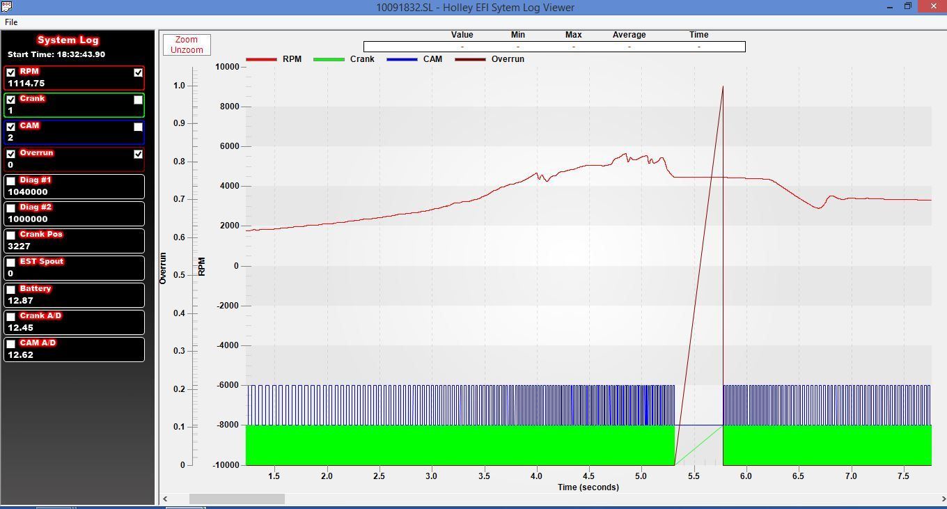

been messing around tring to figure out why the car was missing at the top end,, well i did a system log and did a few WOT pulls to see if i can see anything ,,,, and i think i found something. during the misfire both cam and crank signals go flat ,, which rules out the reluctor as an issue ( if it was i would still see the cam signal when the crank signal would drop off.)
so this leads me to believe that i have an electrical issue somehwere along the cam and crank wires to the pcm ,,,, so next step is the wiring diagrams

Test to ensure the sensors have power when these events occur.

Hmm now that's really weird. But now more than ever I'm definitely voting for some kind of software gremlin. Two separate sensors dropping out at the exact same moment is just too coincidental to be anything mechanical or wiring.
Except when they're powered from the same supply source.
I would highly doubt it's software related, but it would be wiring, interference, whatever. Power is easy to test.

they both share the ground, shield and positive wires according to the holley diagram.
