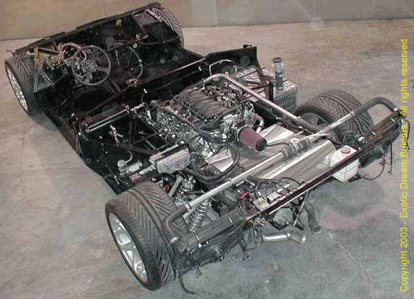

I have finished the chassis so that I can drive it (less a throttle cable) but I have posted an ad on the duPont registry that I am building replicas. I am getting lots of questions on boosting the horespower beyond the 320 that is stock in my crate engine. My focus is on building replicas, not performance upgrades. This may be a silly question but what are some recommendations for bolt on applications and ball park cost that will boost the horespower and what kind of HP will that get me? Or if there is a post that reviews all that just let me know.

If you can put together what I've seen in your website, then you can definately bump HP on the LS1s pretty cost effectively. I expect at least 500 flywheel HP on the engine I'm building for my Grand Sport by going with some Patriot Stage II heads (very inexpensive), a custom grind cam, ported throttle body, long tube headers, underdrive crank pulley, etc. The homework has all been done on these engines. It's very easy to get more power out of them. I suggest that you read the posts in the internal and external engine sections here for a while. It'll help get you going in the right direction.

Very very nice.
A few comments...
1) I'd pull together a performance package, maybe partner with one supplier so you have consistent product. I'd get the following:
-Ported Heads (I like the GM CNC LS6 heads for the price). Keep the compression at 11:1 and nobody will have problems.
-224/224/114-ish cam, will pass emissions and not need a ton of custom tuning (I'd go no bigger than a 228/228//114 because it might not pass and you might force folks to buzz the motors too high and the engine reliability drops)
-Chrome moly pushrods
-LS6 intake
-Ported throttlebody
-Crank underdriver pulley
-ASP hi-sided tensioner pulley or Katech tensioner, the belts can walk off if you run more rpms
-Blueprinted oil pump
Should bump a 300rwhp stock motor up to 400rwhp no problem, maybe 425rwhp, but that depends on the head work and what you are using for exhaust manifolds.
I'd run 1.75 long tubes and 3" dual exhaust with a crossover for optimal power.
Add another $7000 to make the engine into a 382ci stroked motor.
