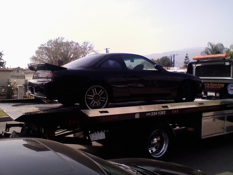

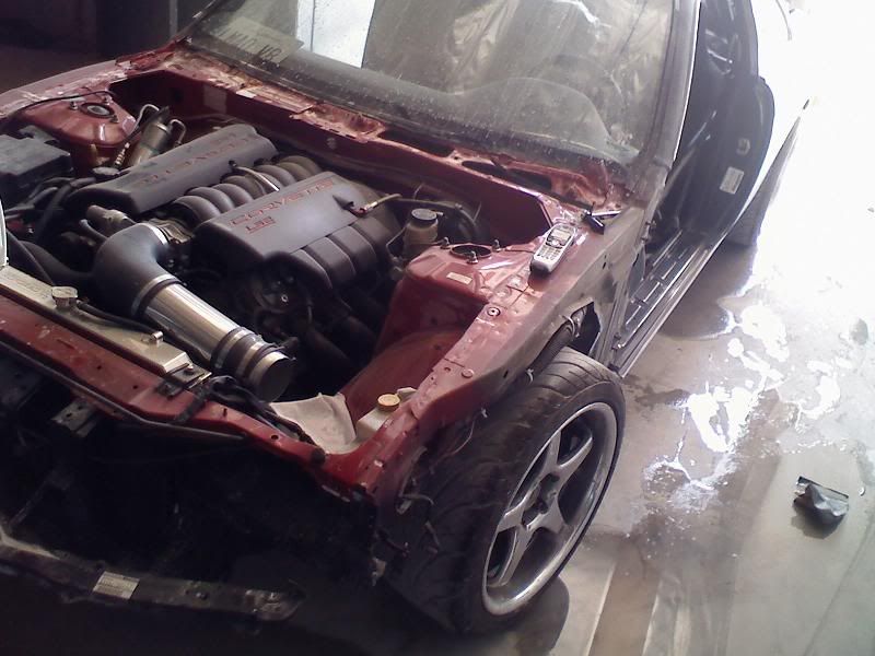

new 240sx the day I bought it, off to the paint shop to get the engine painted.

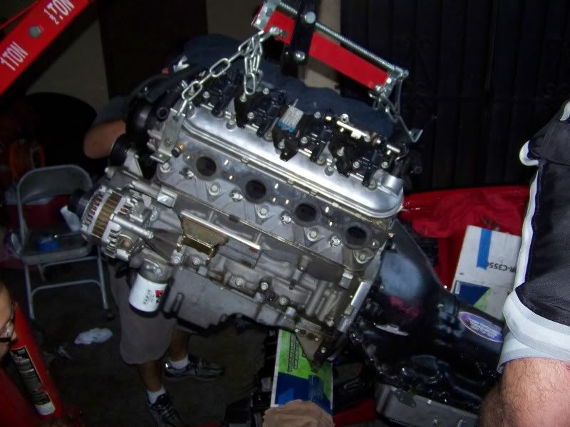

first day it came back from the paint shop, we got to work.. daft motor mounts and cms th350 tranny mount
headers fit great, even though they were made for the old 240sx

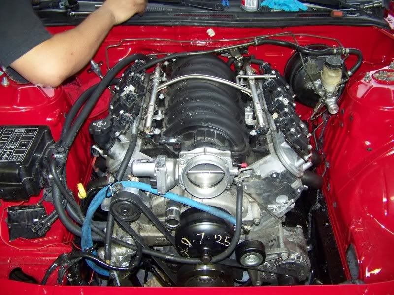

just waiting for the corvette covers at the time and nos install and its pretty much done

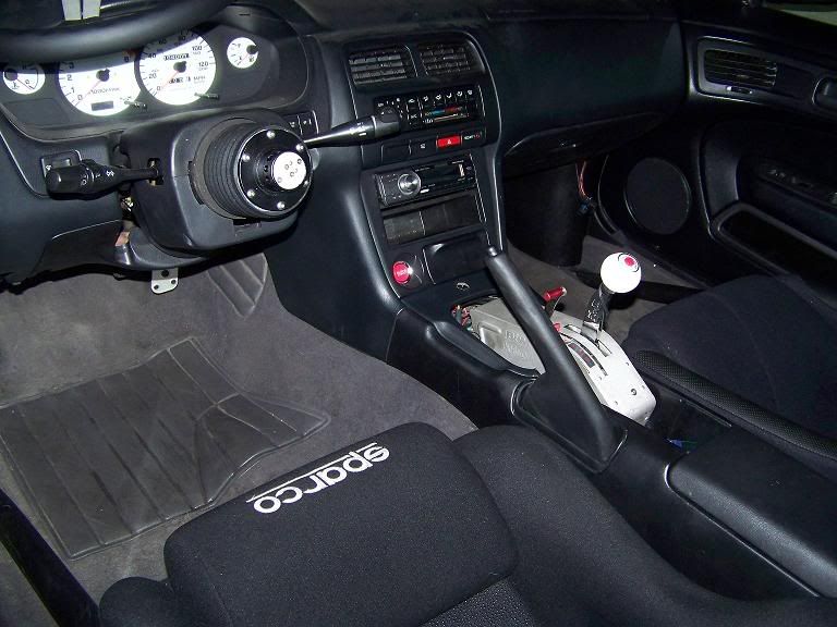

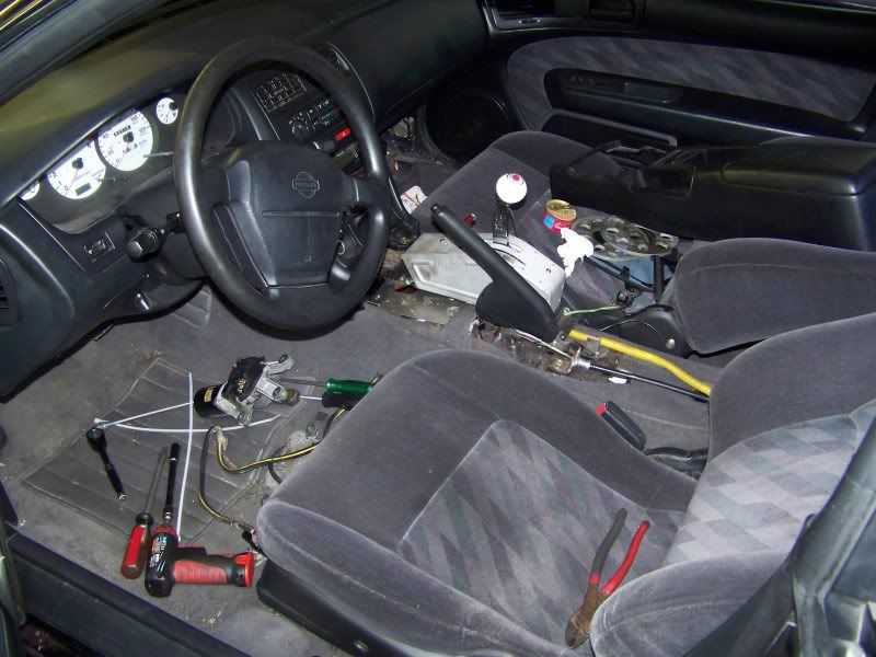

shifter in, and looking great!

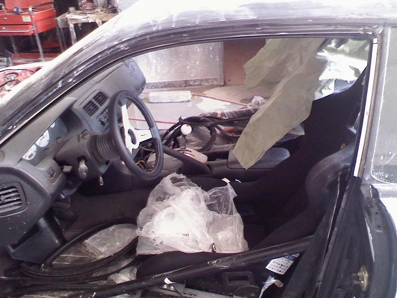

had the cage put in and seats installed
installed a s2000 engine start button in the oem cigarette lighter spot..

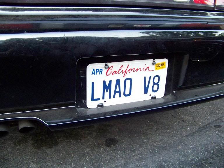

new plates.. i wanted LOL V8 but it was taken, so i guess this is the next best..

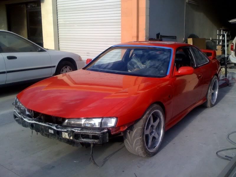

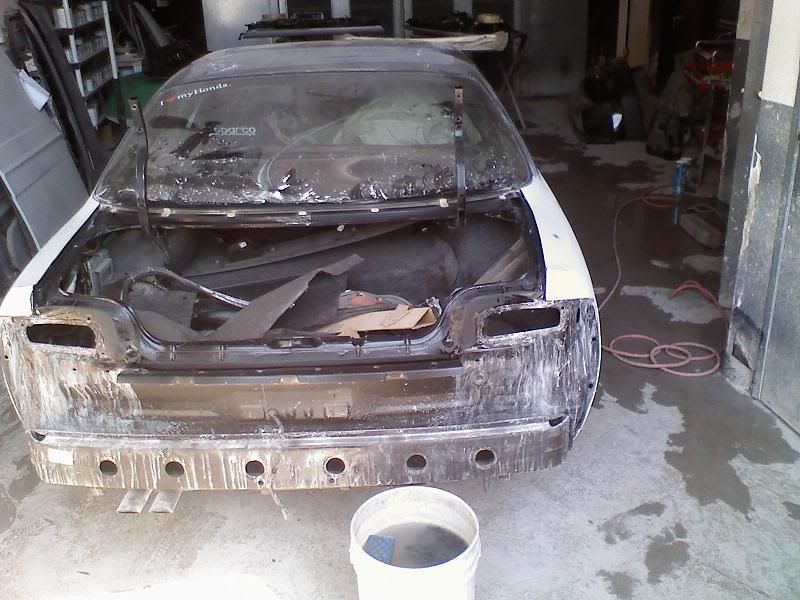

straight out of paint
the following day

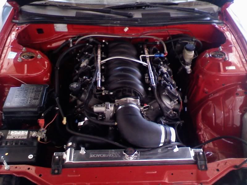

Done with paint and body work
Then i dropped of the car to CMS so Ryan and mike could have some fun with it

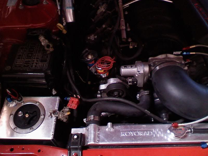

Dedicated fuel system and NOS plate kit being install @ CMS
