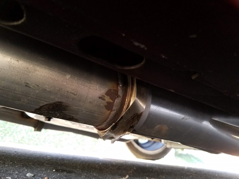

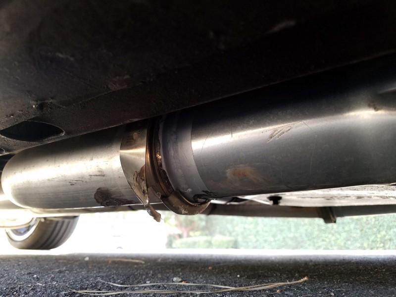

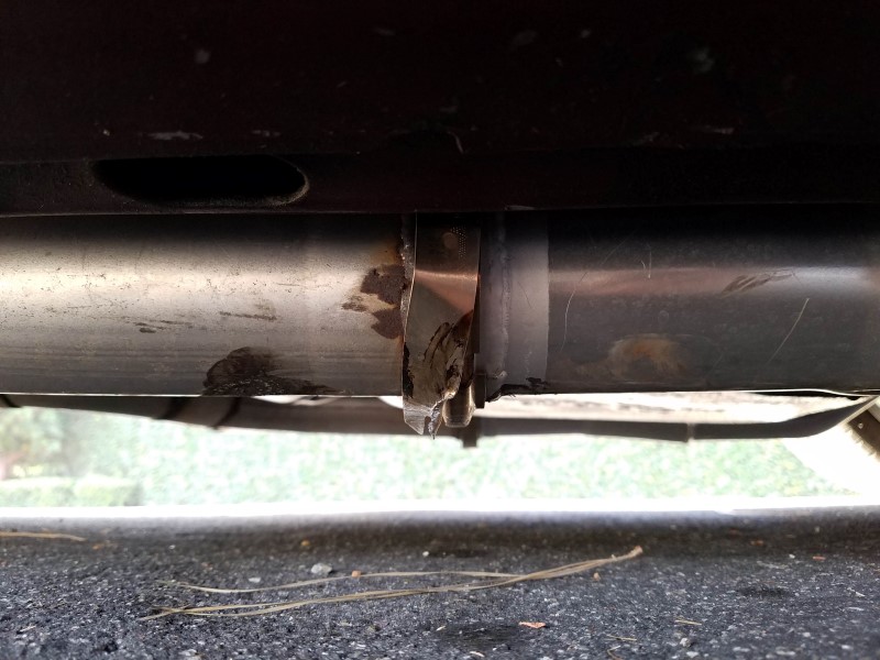

Well it finally happened - I had an unexpectedly rough exit on a humped driveway the other day. When I finally got around to inspecting the damage it was clear my v-band is done for
I can replace the v-band but this is just going to happen again. I am thinking about using a sawzall to cut off the flanges, possibly behind the welds, and then installing a Torca clamp http://www.normaamericasds.com/sites...fs/Coupler.pdf Any thoughts on this?
Old Sep 21, 2018 | 02:19 PM
  #1597
user 4737373's Avatar
Joined: Feb 2013
Posts: 3,540
Likes: 207
Use the Torca couplers Clint, you won't regret it. I use them in the development of all the Hooker Blackheart LS swap systems.
Old Sep 21, 2018 | 02:38 PM
  #1598
cam's Avatar
cam
iTrader: (9)
Joined: Apr 2004
Posts: 3,389
Likes: 67
From: in the garage
I have issues with the torcas pulling apart on mine underneath too. In tight spots, or high ground clearance builds the torca works decent, UNLESS you are wrenching on the build a lot in which case they are not ideal for service fit. This is where V-bands shine, but if tough, good seal, and serviceability is a goal? Cant beat ball and socket imo
https://www.summitracing.com/int/par...1156/overview/
Old Sep 21, 2018 | 10:53 PM
  #1599
kirk69nova's Avatar
iTrader: (9)
Joined: Oct 2009
Posts: 152
From: Pittsburgh
I am using torca style clamps made by Walker now. I like them because they are inexpensive and don’t distort the pipes. Also they are low profile if you can clock them with the bolts facing towards he floor of the car.
Old Sep 23, 2018 | 09:50 PM
  #1600
hookemdevils22's Avatar
iTrader: (12)
Joined: Jul 2008
Posts: 1,411
Likes: 8
From: Tempe, AZ
I have both torcas (came with my headers) and traditional U-bolts (came with my Popes exhaust), and I prefer the torcas. Granted, mine are slip fit, while it sounds like yours will span a gap between pipes.
