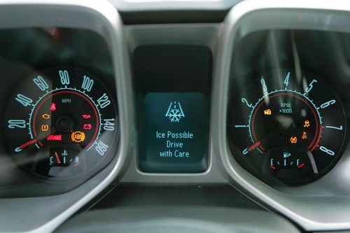

Would it be possible to do this with that PCM and a newer gauges set? Like the ones from a late Camaro or a Cadillac CTS?

These are the options I would like to use:
2008 and up Cadillac CTS:
2010 and up Camaro:
Old Apr 21, 2011 | 05:03 PM
