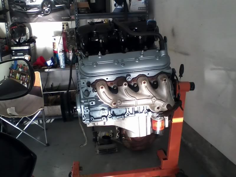

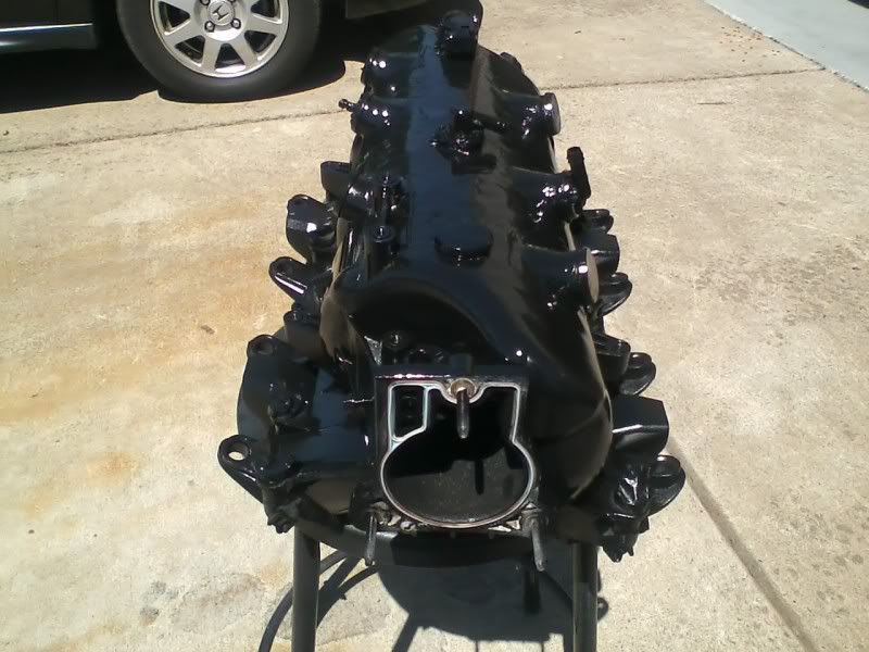

Wow you really went to town on that intake. Looks nicely cleaned up and smoothed over. Engine paint looks good too. Where are you from? Any emissions requirements for your swap?

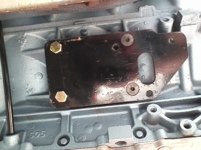

got the CTS-V oilpan on. went with carshop 1" setback motor mounts, should arrive wed.
Old Aug 11, 2011 | 07:42 PM
kwnova9's Avatar
Joined: Jul 2011
Posts: 72
Couldn't be any happier with the carshop 1" setback adapter plates. I did have to grind my SBC factory motor mount flat on the side that sits on the mount, and had to notch the passengers side to clear the block. Nothing a angle grinder couldn't fix!
No I just need to get the cherry picker out and set the motor and trans in!!!! Hopefully everything fits.

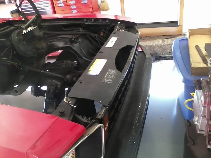

Ready for surgery

Carshop 1" setback plates with stock sbc mount attached to it.
oil pan clearance

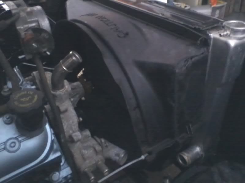

Custom fan shroud it fit my alum. Radiator. Stock '99 silverado 2500 shroud, cut about %50 of the plastic out then plastic welded it how I want, used a propane torch and zipties as filler rod. Id have to say, not too bad for a 20yr old right

what did you use to clean and degrease the engine before you painted it? is that duplicolor engine enamel?
lookin good
Old Aug 22, 2011 | 12:03 PM
  #40
kwnova9's Avatar
Joined: Jul 2011
Posts: 72
I used "purple power" and "simple green", lots of green scrubby pads, and paper towels to clean the engine. overall is was more dusty then greasy.
The paint i used was VHT i believe, it has a little bit of metallic in there but pics don't show it well. I used duplicolor engine enamel on the intake because it goes on super thick and made a strong, glossy surface.
