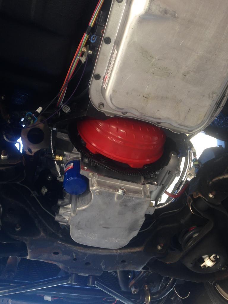

I have been asked about the mounting, firewall clearance and oil pan clearance.
Here are some measurements and pictures.
Pass side head is 3/4" from firewall. CTS-V oil pan sits 1/2" below crossmember, but the DSE frame stiffeners are lower then the oil pan.
I used the Spohn adaptor plates with F-body engine mounts.

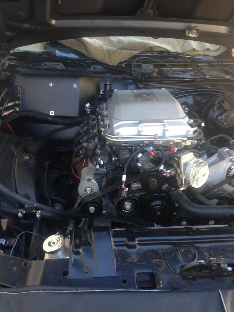

It's coming together. Worked out all the location details and the ZL1 top looks much better than the CTS-V top on this LSA.
Coming together!
