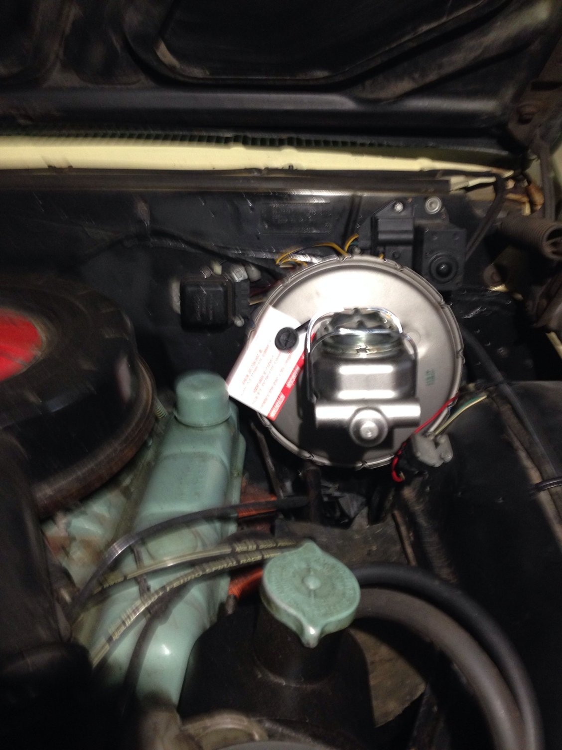

I will check mine tomorrow. I have a pair of 65 Lemans. I installed a stainless steel brake conversion kit with the 67- 69 booster 7-8 years ago. Worked great. I finished my 5.3 conversion a few months ago and the brakes work just as good with the stock 5.3. If you search 65 lemans 4 door you should find my initial write up with pictures. I haven't updated it in a while.
PM me if you need more info or pictures.

As already stated a dual 8" will work possibly a 9". They are not stock they are dual diaphragm. 11" will not fit.

I test fit a reman 67 11" booster. It barely clears the inner fender.
Now I just need to figure out if the ls3 and Vette covers will work.
