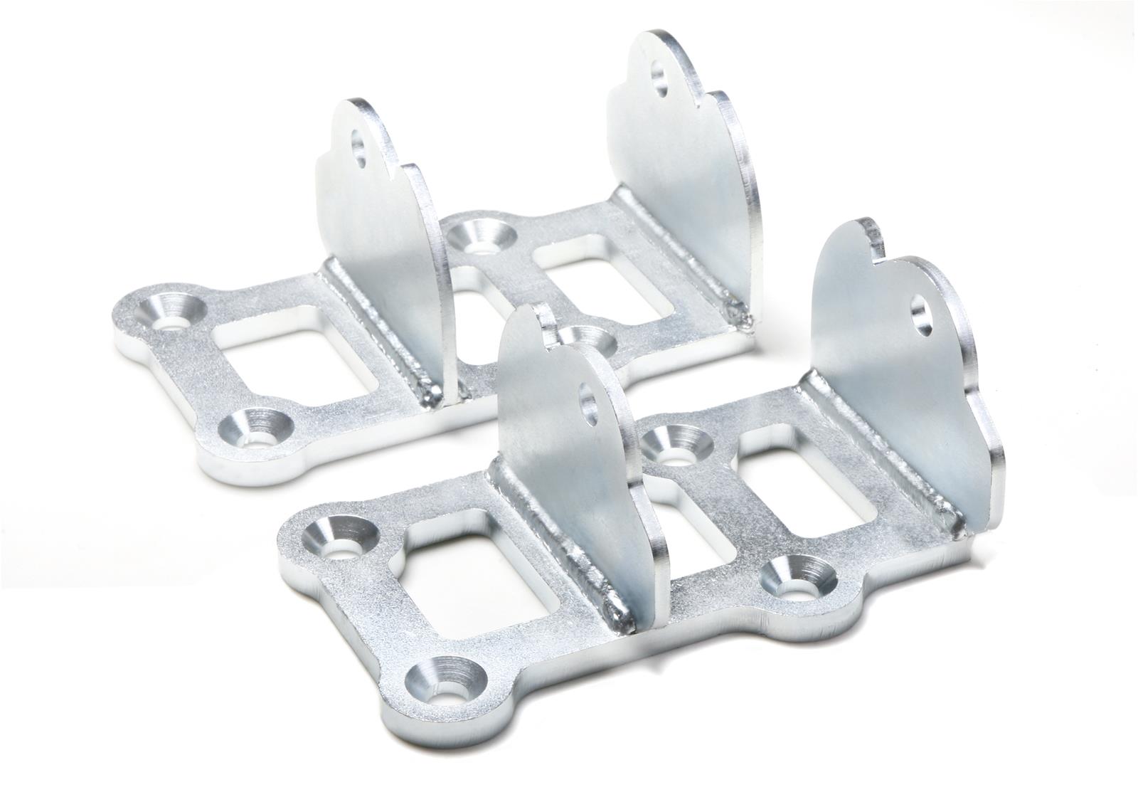

Toddoky... you are with Hooker, right? Those mounts will clear all the necessary stuff? That is another concern of mine... do I dimple F-body headers, or do I pony up the big money for yours (no offense, they're fairly priced, I just enjoy saving money.)
I just assumed that (like any swap mounts) they have their drawbacks, but if you can convince me, that might be $125 well spent. Coils clear the A/C? Truck accessories clear the crossmember? Are your G-body headers available yet?

Fry directed you to the bulletin I prepared for the Hooker parts so thanks to him for pointing that out...the engine brackets are available now and the crossmember and headers will be following them in a few weeks.

Will it be offered as a kit or individual pieces? I guess I'm asking should I wait and get a kit, or go ahead and get them one by one?
And how are those mounts different from the 12621 version?
They will all be available as individual pieces as there are far too many possible combinations of parts to make stocking/ offering kits feasible...Hooker/Holley will be offering an oil pan ,mid-length headers, cast iron manifolds, exhaust systems and the adapters to connect them all together in addition to the engine brackets, trans crossmember and long-tube headers so you can see where the choices to the user will be quite extensive. Unfortunately, if you are dead set on using the CTSV pan the Hooker set-up will not be a viable option for you as the engine brackets position the engine too low in the frame for that pan to fit without experiencing interference will the engine crossmember.

12621 mounts an option with the CTS-v pan?
I have no problem buying a whole integrated system, but like you pointed out, I may have fitment issues regardless. Absolutely not a reflection on Hooker parts, its completely due to the production variables in the G-body. Since I enjoy fabrication (and I'm darn good at it ) you can maybe see why I'm tempted to go less expensive and encounter the same fitment issues
Ok, thanks for that info.
Still... might dive in. A few weeks from now will be about the time I'm bolting the LQ9 and T56 in place.
Yes, the 12621HKR swap brackets were developed about 5 years ago at a time when the 302-2 Holley pan didn't exist and so were designed around the geometry of the Holley 302-1 pan, which is much taller in the front like the CTSV pan. The engine height and fore/aft position provided by those mounts does not permit the use of the truck accessory drive and are not compatible with any specific trans crossmember, so just be aware of that if you want to go that route. Since you plan to fabricate some of your parts that may work out for you. You will not be able to achieve what I consider to be a desirable engine inclination angle with those brackets unless you cut out the tunnel floor and rebuild it. This will especially be pertinent to you since the T56 trans you plan on using hangs lower in the center of the car than just about any other transmission.
