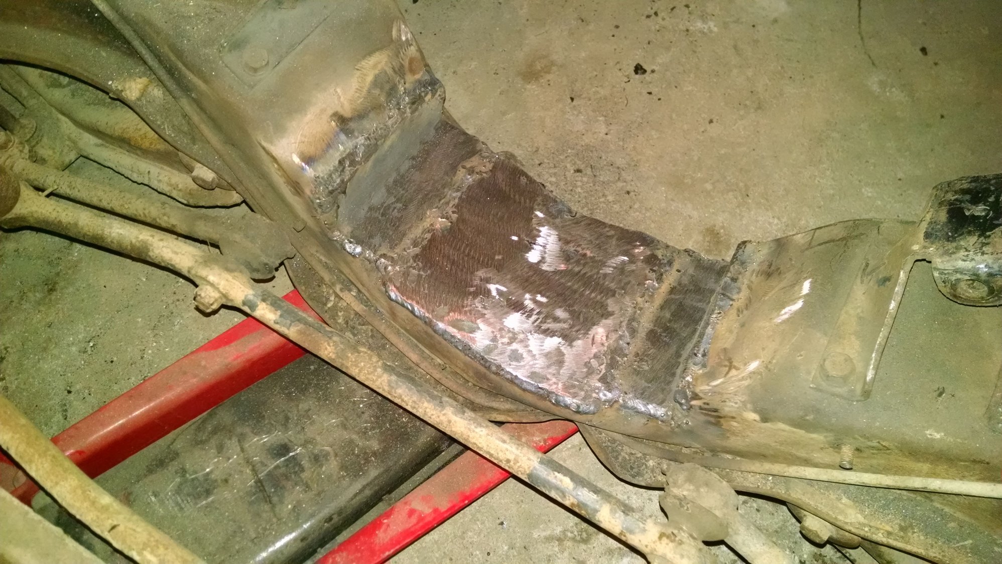

Well, it is definitely not the prettiest.. But I got my cross member notched, and the motor back in. Fits soooo much better. CTS-v Oil pan has clearance all the way around it, and the truck intake has about an inch of clearance before hitting the hood (without vortec cover).

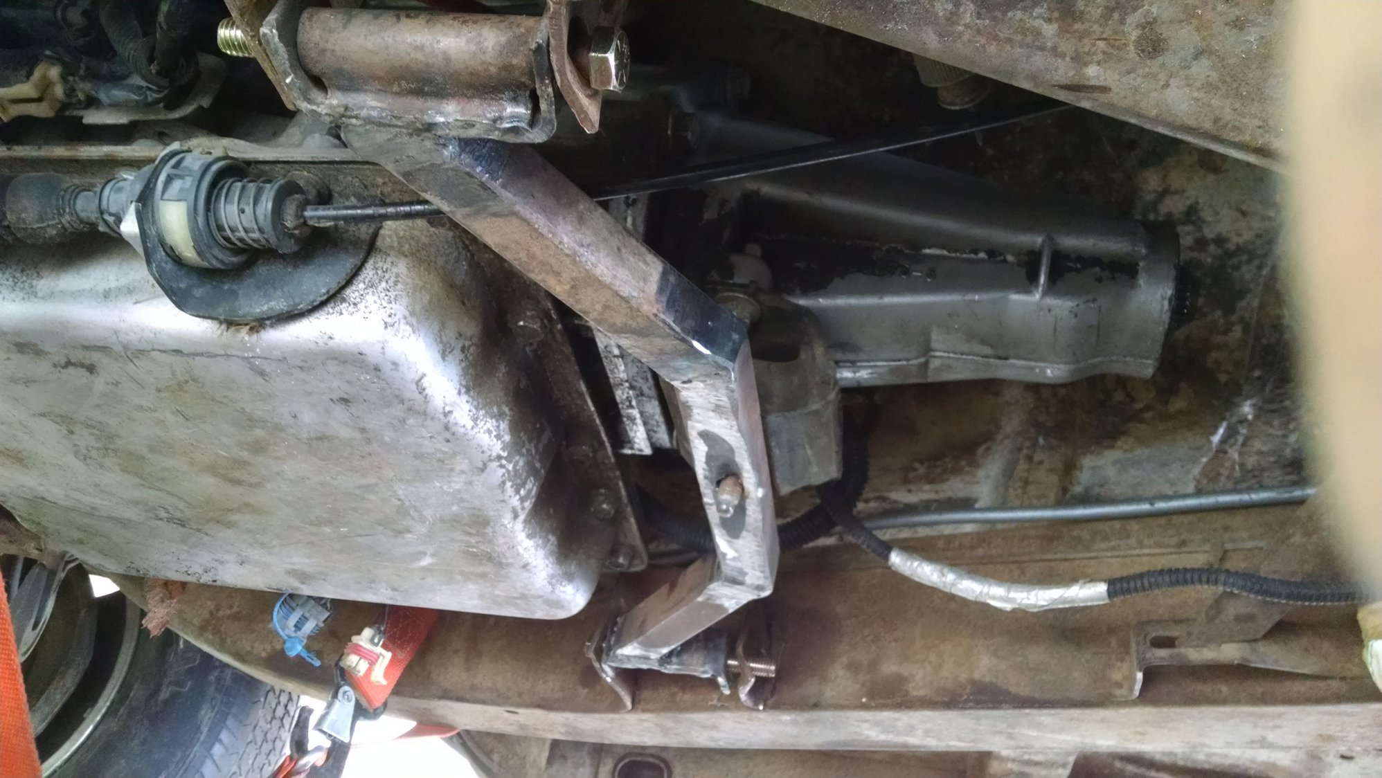

From: South Dakota
What are you x-frame guys doing for a trans x member? Making it or buying it? I am trying to make one but I don't know how to go about it without having to weld the x member to the frame. I would rather have it bolted in case it needed to be moved or removed for whatever reason

I ended up making my own for now. I would think this would be stout enough to hold it. It's a hell of a lot lighter than a powerglide. Used original mounts and used parts off the original x member to make it work. Not the prettiest but it will work for now..

That one is similar to what I did, although I think I am going to change mine a little eventually. As of right now, my tubing is welded to the front of the mounts. I think I am going to move it to the back, then add another piece of tubing to the front of it and weld a plate between the two for the transmission to bolt to. Would add some extra strength too.
