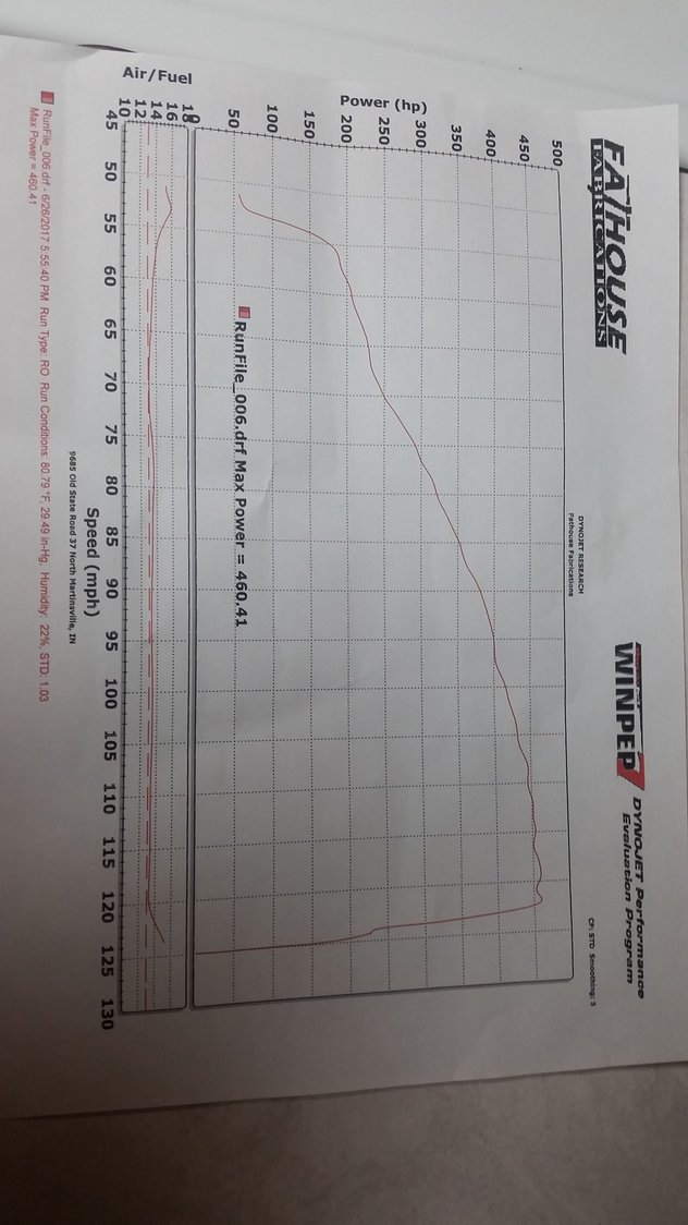

Old Sep 5, 2017 | 10:01 AM
oldschoolmuscle's Avatar
Joined: Nov 2004
Posts: 261
From: indy
finally got the car dyno tuned, on 93 octane
