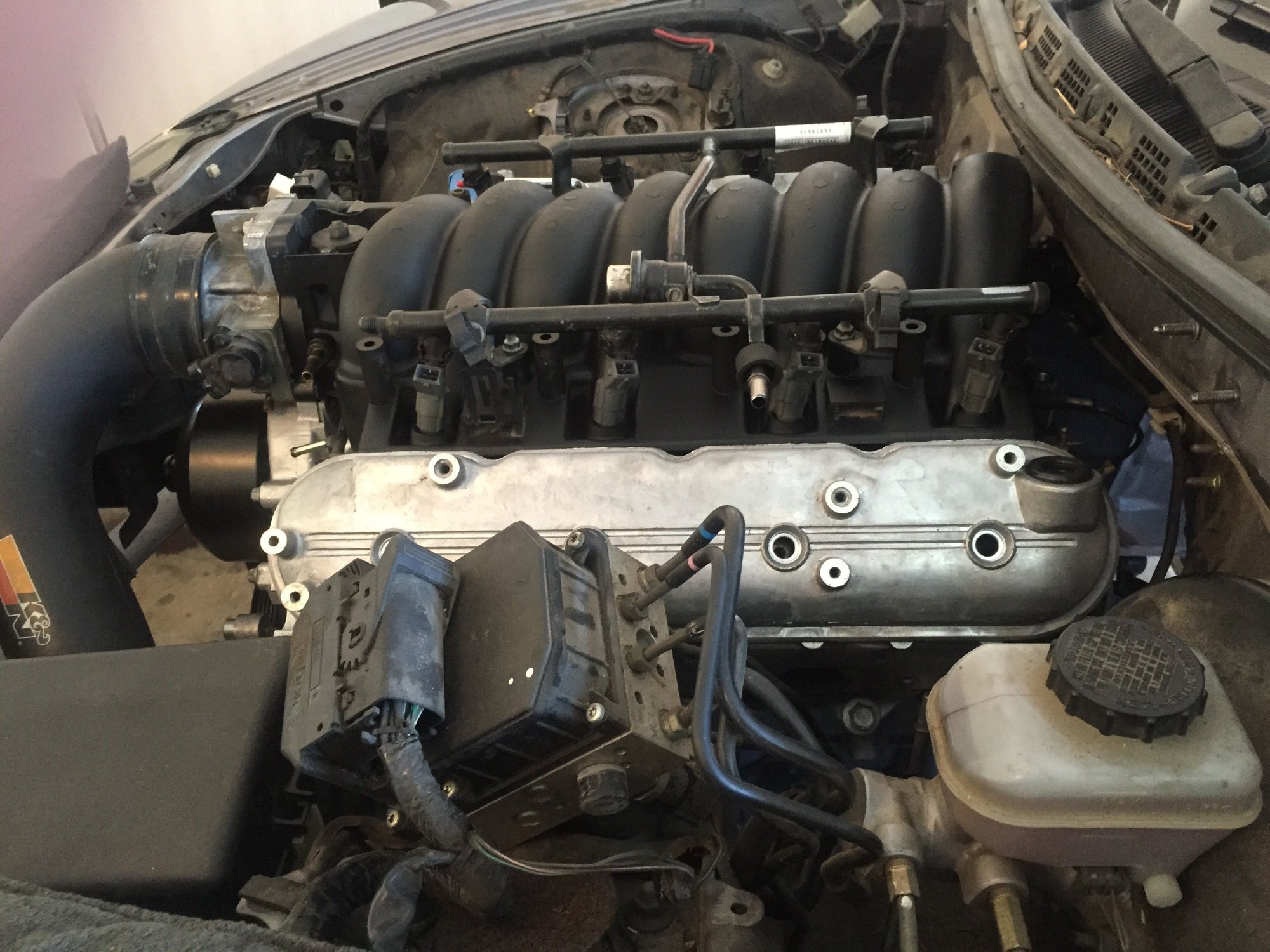

Lsxis300's Avatar
Joined: Feb 2015
Posts: 63
From: San tan valley az
Originally Posted by Lsxis300
remember i have the 8.8 with 3.23.im goin to put in.
Ls1 motor,cleaned it up a bit.

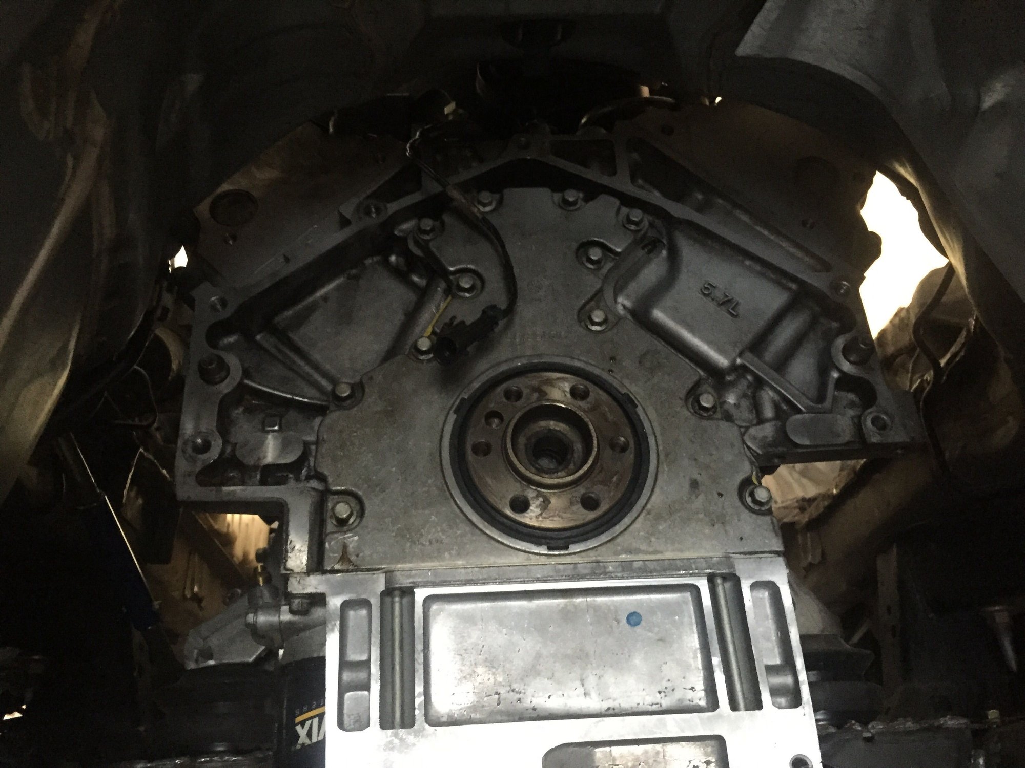

Old Jun 13, 2015 | 01:32 PM
  #54
Lsxis300's Avatar
Joined: Feb 2015
Posts: 63
Motor in,have some 99 Vette exhaust but the bottom hits the motor mount,will have to find some camaro manifolds.

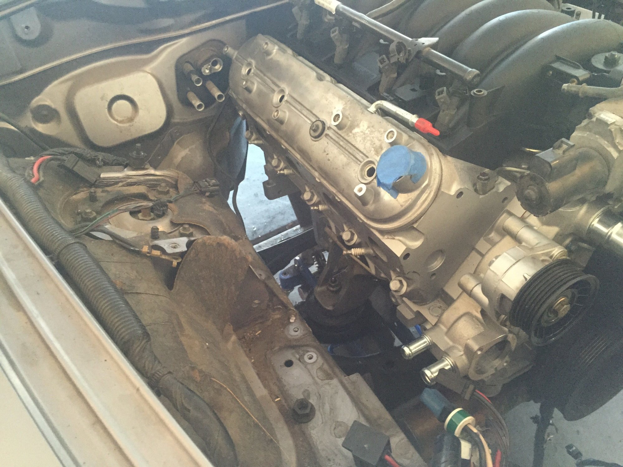

Old Jun 23, 2015 | 06:47 PM
  #56
Lsxis300's Avatar
Joined: Feb 2015
Posts: 63
Have a set of 2000 vette exhaust manifolds but they hit the motor mounts.I looked at some ls3 manifolds and those look like the ones to go with.it going to go slow for the next few months,AZ temps when I get of work are around 110,120 in the garage.

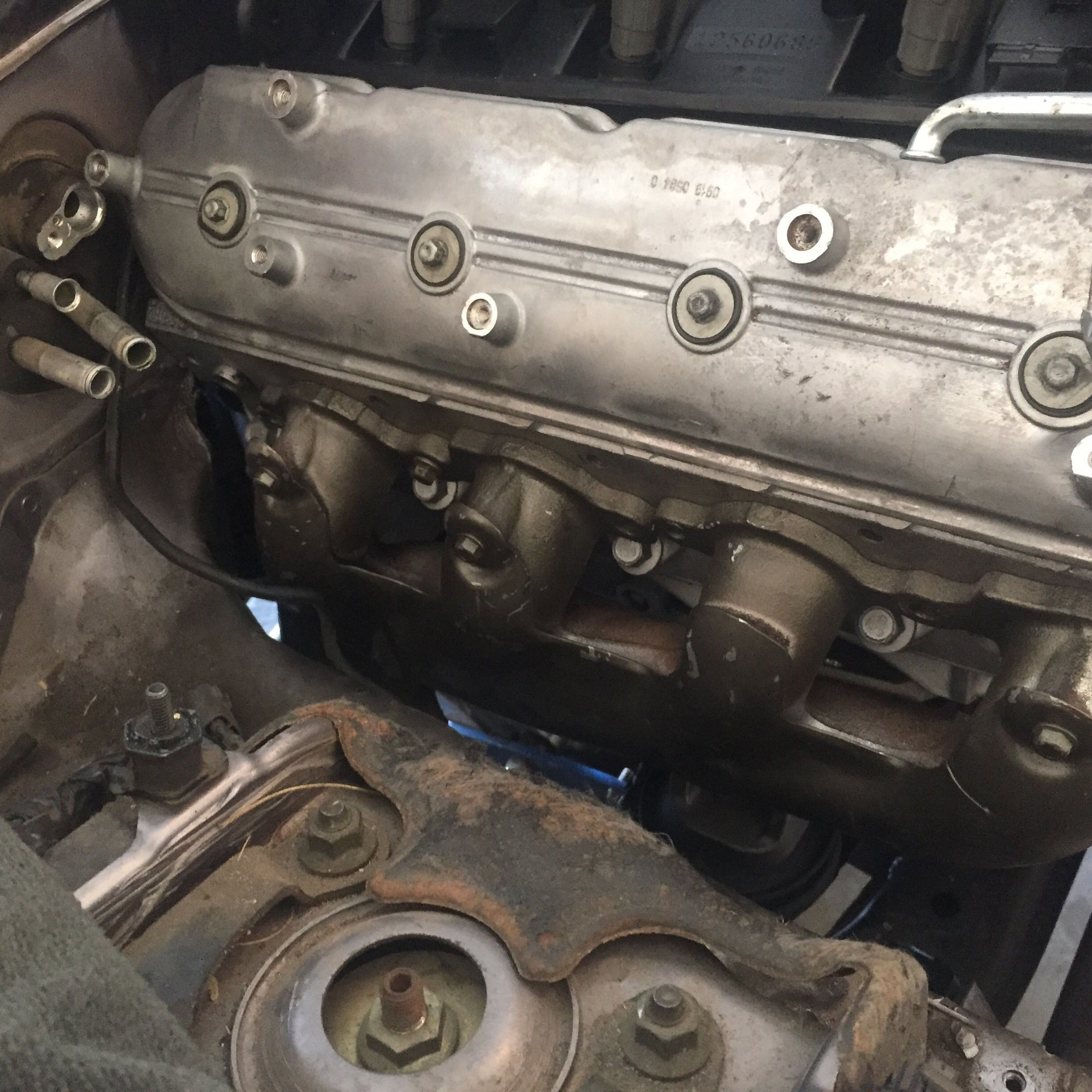

Old Jun 27, 2015 | 09:16 PM
  #57
Lsxis300's Avatar
Joined: Feb 2015
Posts: 63
Going to have to trim the pinch weld on the driver side by the firewall,almost got the ls3 manifold to fit.
Back of the motor

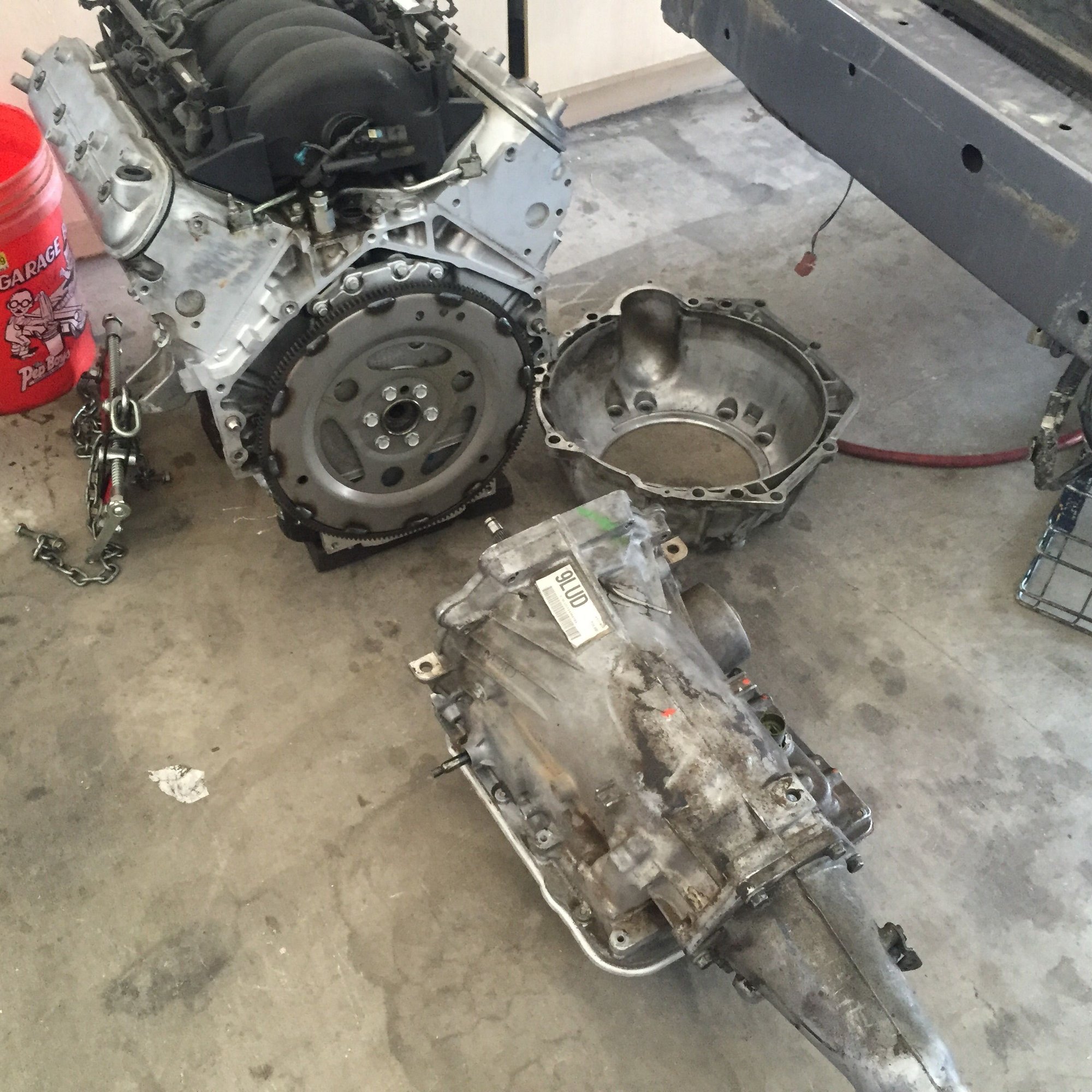

Old Jul 12, 2015 | 03:54 PM
  #58
Lsxis300's Avatar
Joined: Feb 2015
Posts: 63
Well I pulled the motor back to hook up the trans.everything was going good till I tried to stab the converter in,it did not want to seat all the way in.FTI converter from summit, friend of mine brought over a stock one and it fit right in.the only difference we saw is the snout on the FTI is about 3/8 longer than the stock one.so now I have to send it back,on hold for another 2 weeks probably!

Old Jul 16, 2015 | 08:30 PM
  #59
Skrewball's Avatar
Joined: Sep 2010
Posts: 4
I ran into a problem with converter fitment and found out that the 4l60 transmissions had at least 2 different bellhousings.
The bellhousing you have pictured looks like the earlier bellhousing that is shorter than the later.

Old Jul 26, 2015 | 04:11 PM
  #60
Lsxis300's Avatar
Joined: Feb 2015
Posts: 63
The bellhousing you have pictured looks like the earlier bellhousing that is shorter than the later. This Page has a good description of the differences.
It may not be anything helpful for you, but thought i'd share.
thanks I sent that converter back,and bought one locally,went in first try.put the motor and trans all in at once it was a pain by my self but it in,working on the exhaust now.
