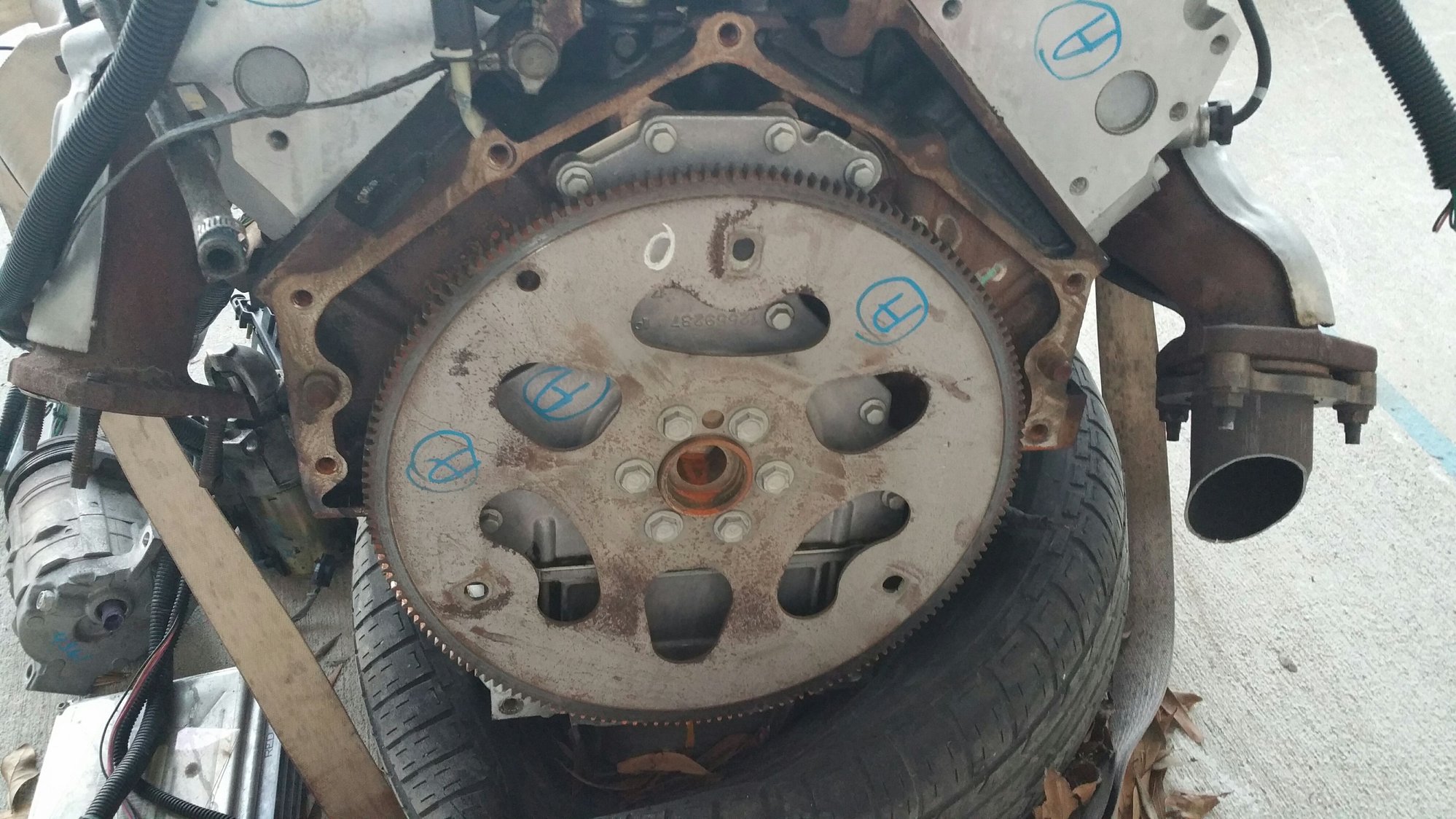

Well we are starting our project, and with help we will try to get this done. This is my son's car and after his motor went south we decided to go with something not as hard to find parts as with JDM. We are both novices at this, so try not to be too hard on us as we progress and ask a million questions. Here are the starting pics. We pulled everything minus the power steering box. Our motor is a 5.3 out of a 2002 suburban.
1st question: We are buying the LS1 complete fuel delivery kit from speedway, as his Walbro 250 does not have enough PSI to run this motor. Is there something beter/ cheaper? or is this a good setup for daily driver mode.
5.3 2002 suburban donor motor
89 supra with almost everything removed.
Again any comments or suggestions will be appreciated. More pics to follow.

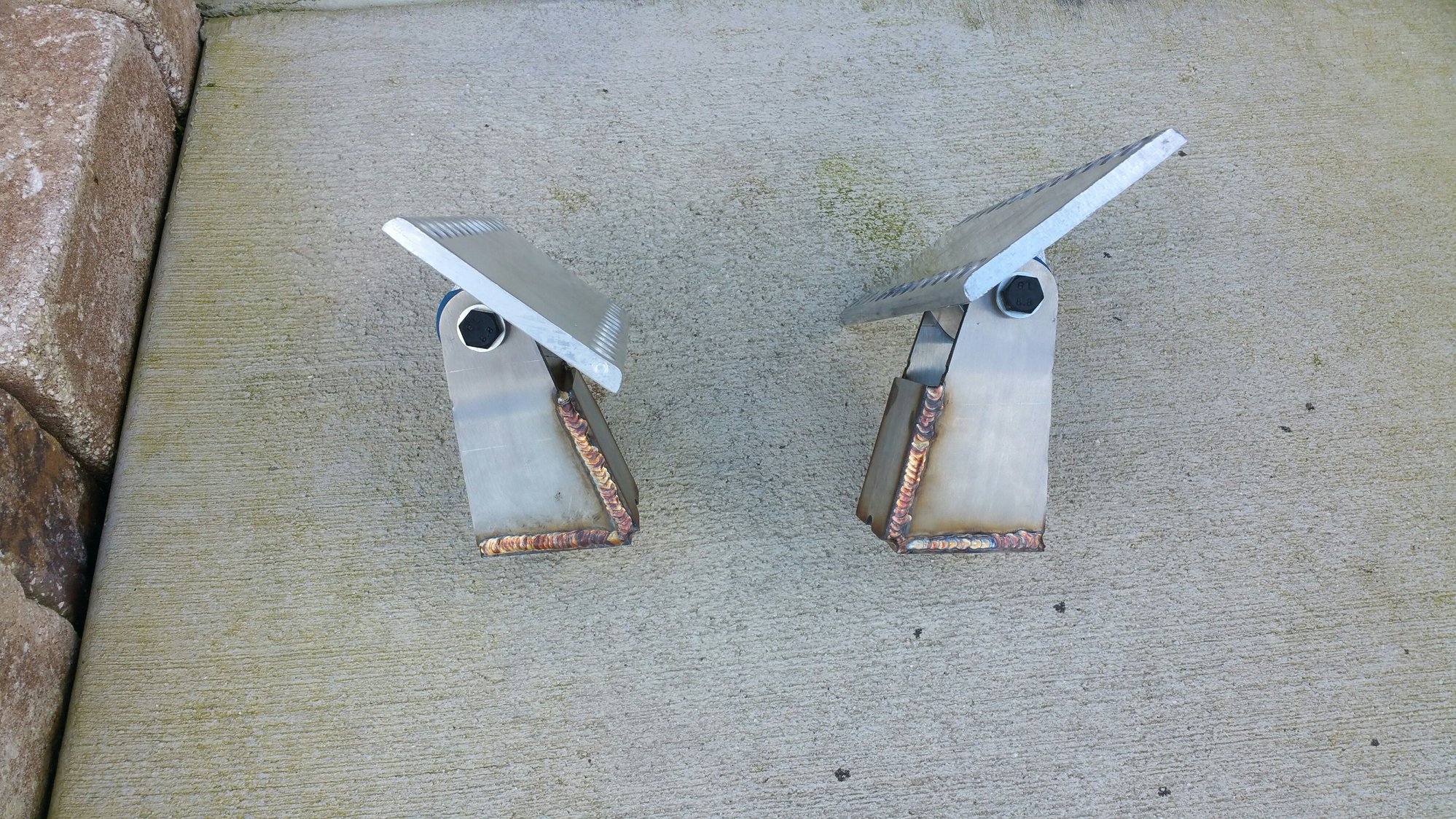

These are our CXRacing motor mounts, and we will be mounting them today.

I would suggest you get those mounts on the motor as soon as to can to make sure it fits in the car. I'm doing the same swap in an '88 and my mounts do not fit right at all. I bought the same cxracing mounts.
