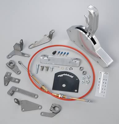

This is the one i'm interested in because it does not have the little reverse lockout lever that I find annoying. do you remember which brackets you used on yours? Maybe i'll go back into the MCSS thread and see if you posted that linkage hooked up in a picture.

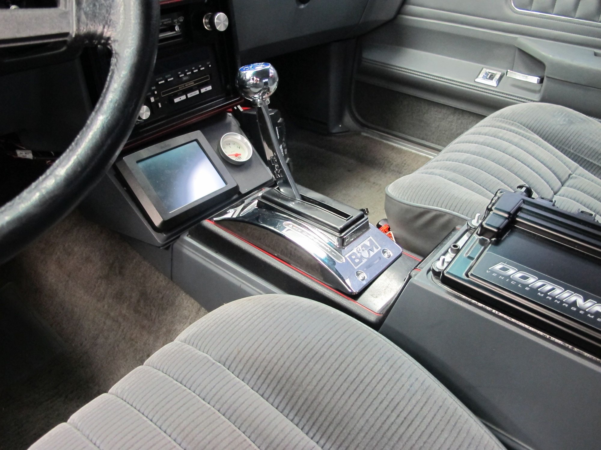

Here's the shifter as used in our Monte, I'm sure you're console is different but you'll get the general idea. No elongation or modification to the shifter was needed since they provided a 4L80E specific lever in the kit for attachment to the selector shaft at the transmission.

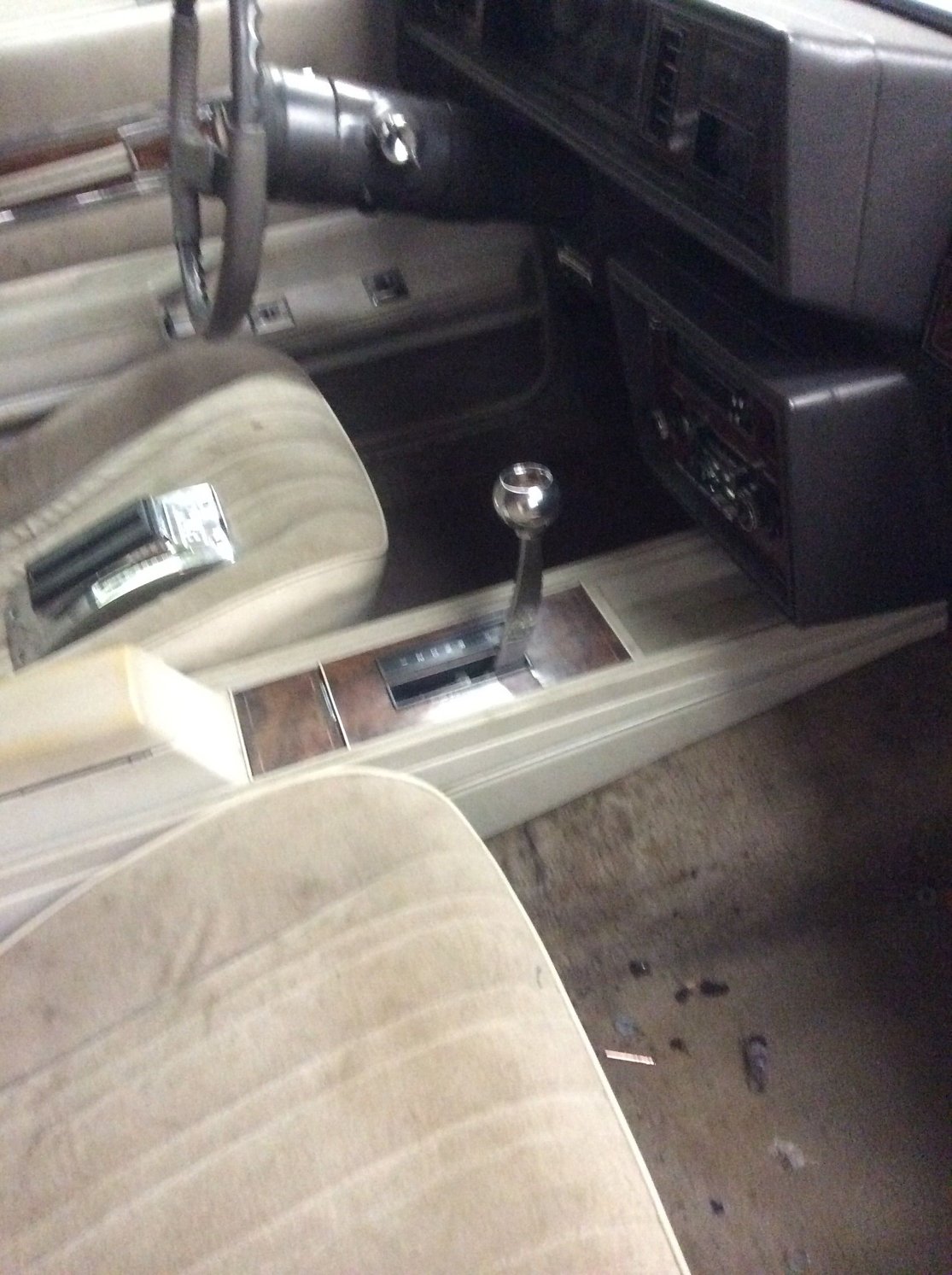

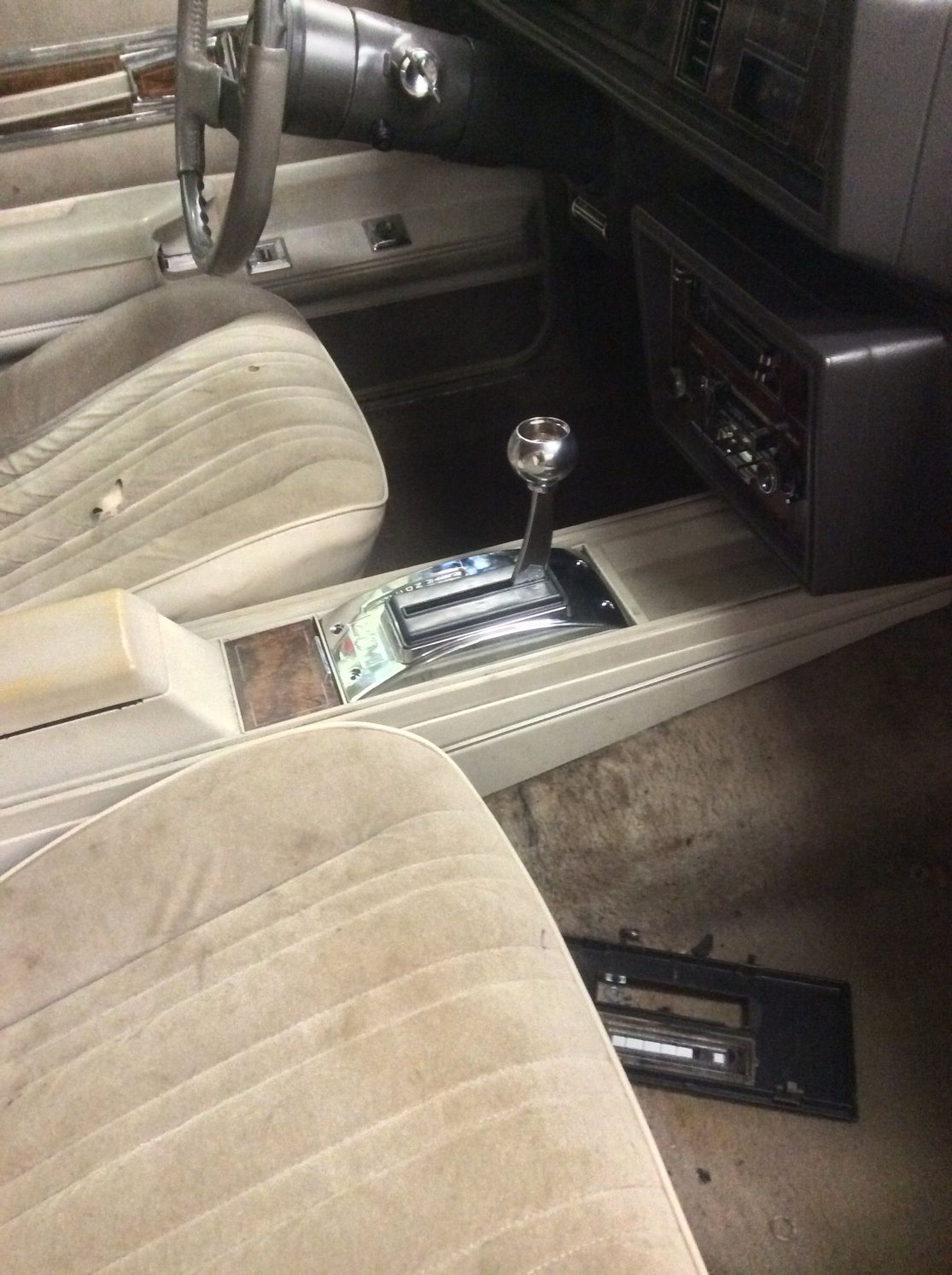

You can put the b&m quicksilver shifter under the console and retain a stock appearance. There is also a guy who makes a shift indicator lens for gn for use with the quick silver
As you can see the quicksilver bezel fits perfect. This is the easiest way to hook up a 4 l80 in a g body I think
This is quicksilver in my cutlass
This is what I ended up going with

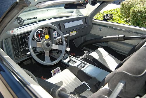

That looks like it's made for that console. was there any modification to get the actual shifter in place or did it just bolt in?
I think that's what this guy has.

It wasn't hard, just a little time consuming. I think I took out the front bracket for the factory shifter and used 1/2 in spacers for the back to level it out. The hardest part was positioning shifter so it would work with console . If u search the net there are a few threads on this install. You can put it in with self tapping screws first to get alignment just right
