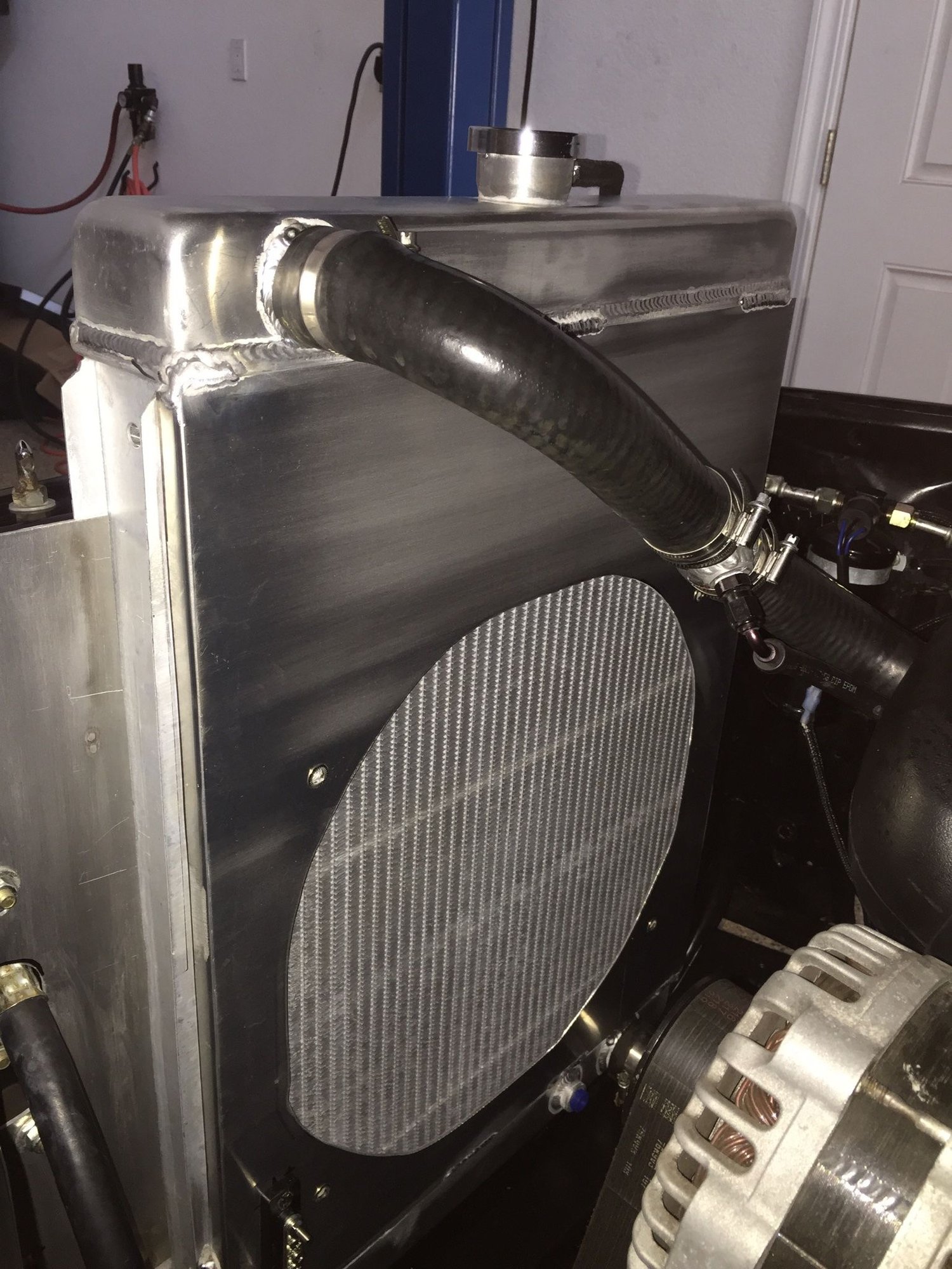

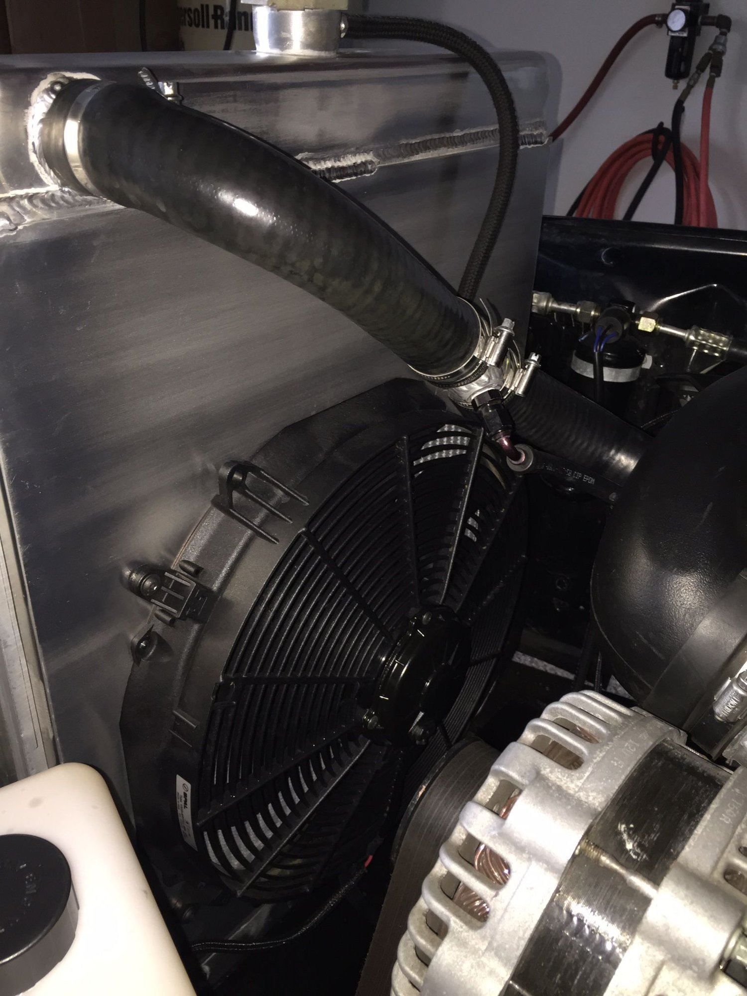

What do you think about this radiator for my standard LM7? You think it will work? Its a standard engine and i will keep it that way.
I realize im not so good at cooling systems… Is this the easiest way or how do you think i should do? Am i missing something?
Hope i don't seem to stupid now...

Looks more like an overflow than surge. Difference is overflow is just that. Surge is high spot in cooling system and part of the systems' coolant flow path.
Only flow of reflow tank sees is burping of high pressure coolant when things get hot and then as cooling happens vacuum draws fluid back in to radiator.
I'd ask:
1. What is the high point (where air will collect when filling)? If radiator then you just need an overflow. 13 lb cap would be good.
2. If the surge tank will be highpoint you'd use a higher pressure cap on radiator and 13 on surge tank.
3. Another consideration... Where will you attach steam vent? This needs to be within pressurized system. Overflow tank is not pressurized... Just atmospheric

If the radiator tank and pressure relief cap are the high spot, I'd only install an overflow. It is exactly what I did and works great. I used an overflow from a Sububran and bought it new on Amazon for $15.
If there is another high spot in your system, that won't work. I'd then install a surge tank.

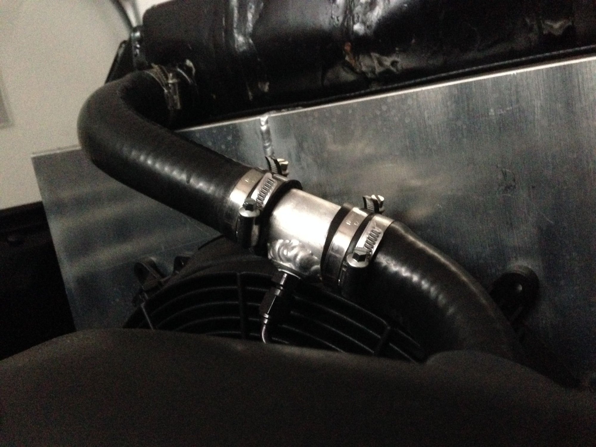

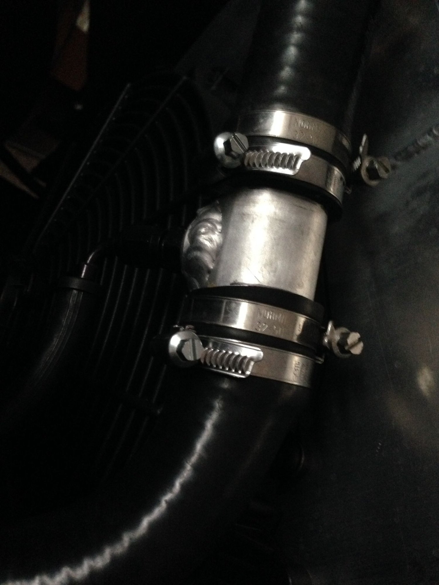

As for the inline steam vent, it works great. I built one with 1 1/2" AL tubing and a -6AN male bung that I welded to the tube. See photos. Or you can buy similar from Jagsthatrun.com

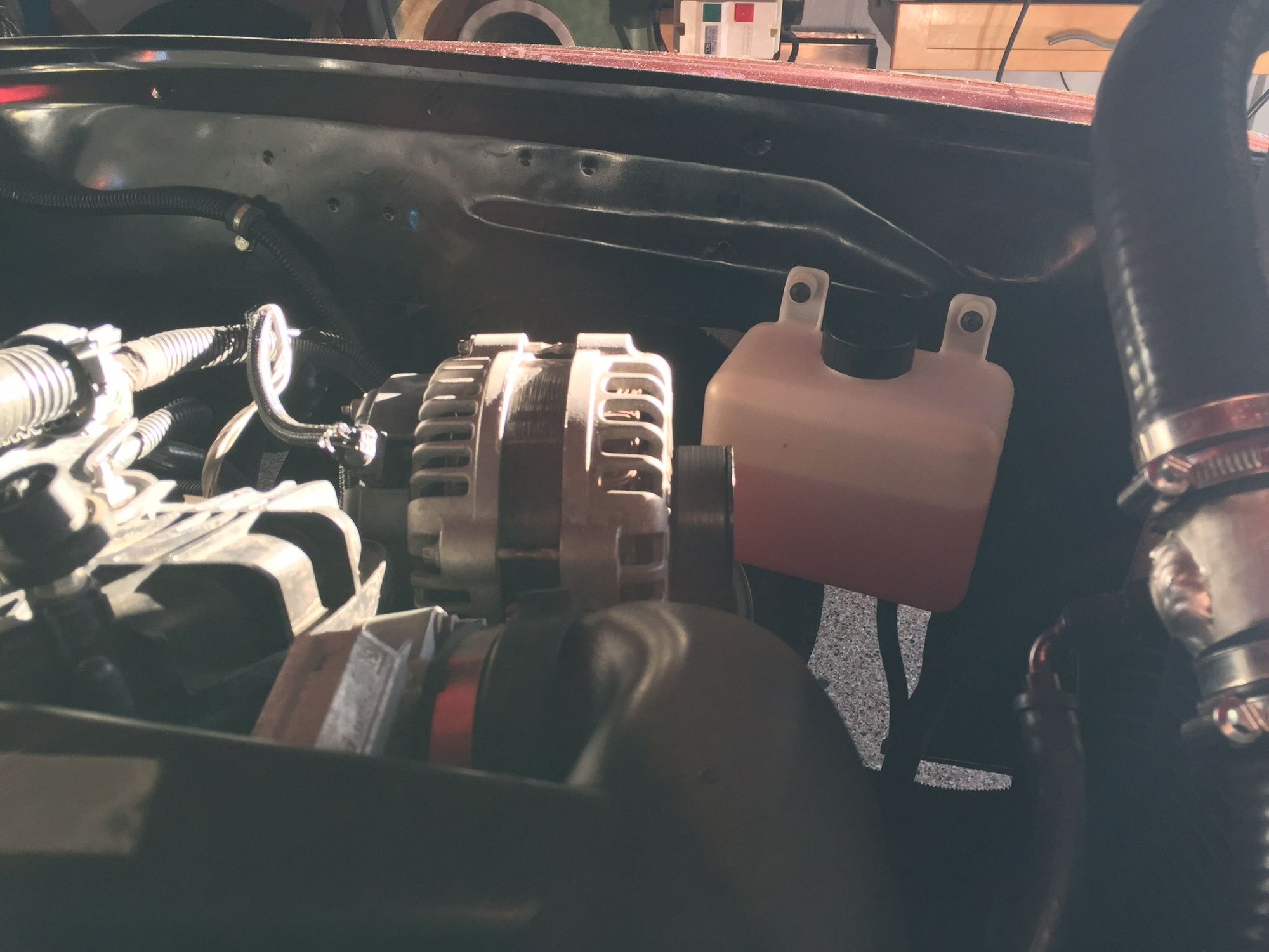

With a newborn and some spine surgery its hard to find the time but this i some of what i done.
I was able to use standard hoses from a Silverado. Just had to shorten them. For the steam vent i got a adapter for a temp sensor that im able to use.

The uppger hose.

The temp sensor adapter.
