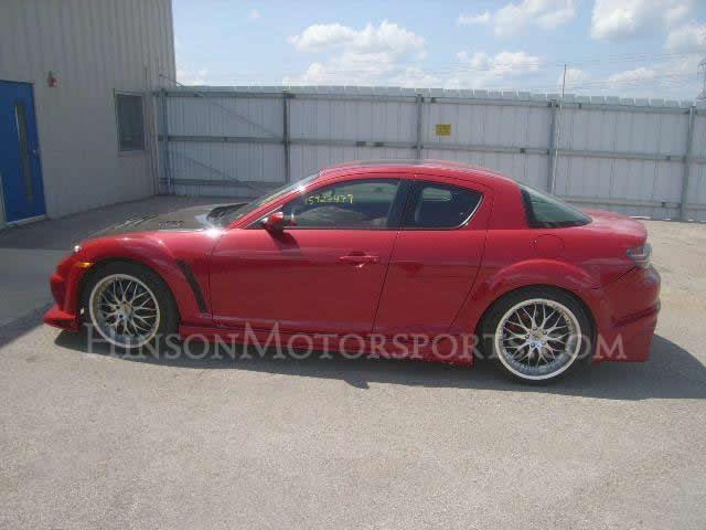

I'm doing a rx8 swap with a lq9/4l60 swap,I heard a lot of bad things about Hinson.i would go true rx8ls1.com they are really helpful.
