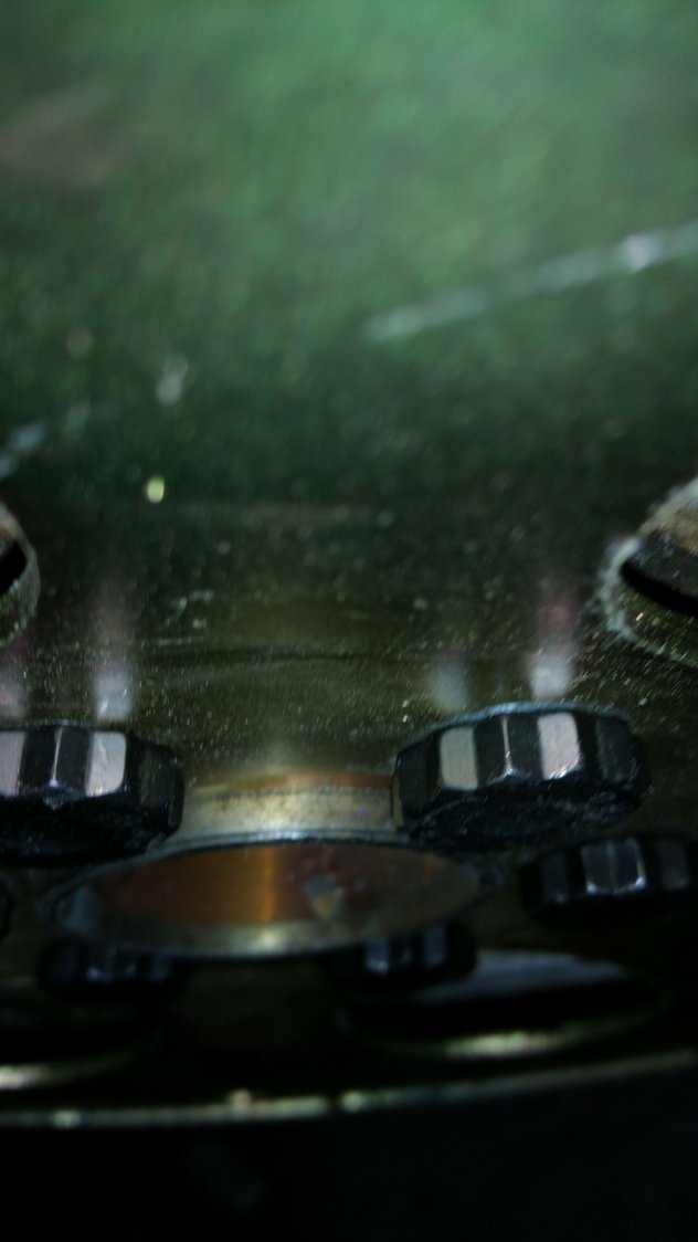

I'm having issues with getting the flexplate bolted to the engine. The crank snout is interfering with the socket so I can't tighten the correctly. The engine is a 2003/2004 lq4. Here are some pictures to hopefully help understand my problem.

Use a thinner wall 12 point socket.

Yea try a 3/8th drive socket or have a 1/2" drive socket turned down a bit to clear.

...or use the factory hardware. I've never experienced or heard of a failure with the factory hardware.
For the thinner socket trick, try cheap (typically imported) non-impact sockets from your local overseas junk tool dealer.

Thanks for the reply every one. No, I haven't used thread loc yet, still just mocking everything up to check fitment. I ended up buying a kobalt 12 point set and that seemed to work.

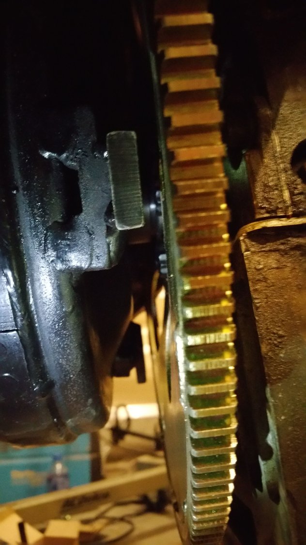

Does this look right? And can I just pull te converter out to meet up, or do I have another issue I need to address?

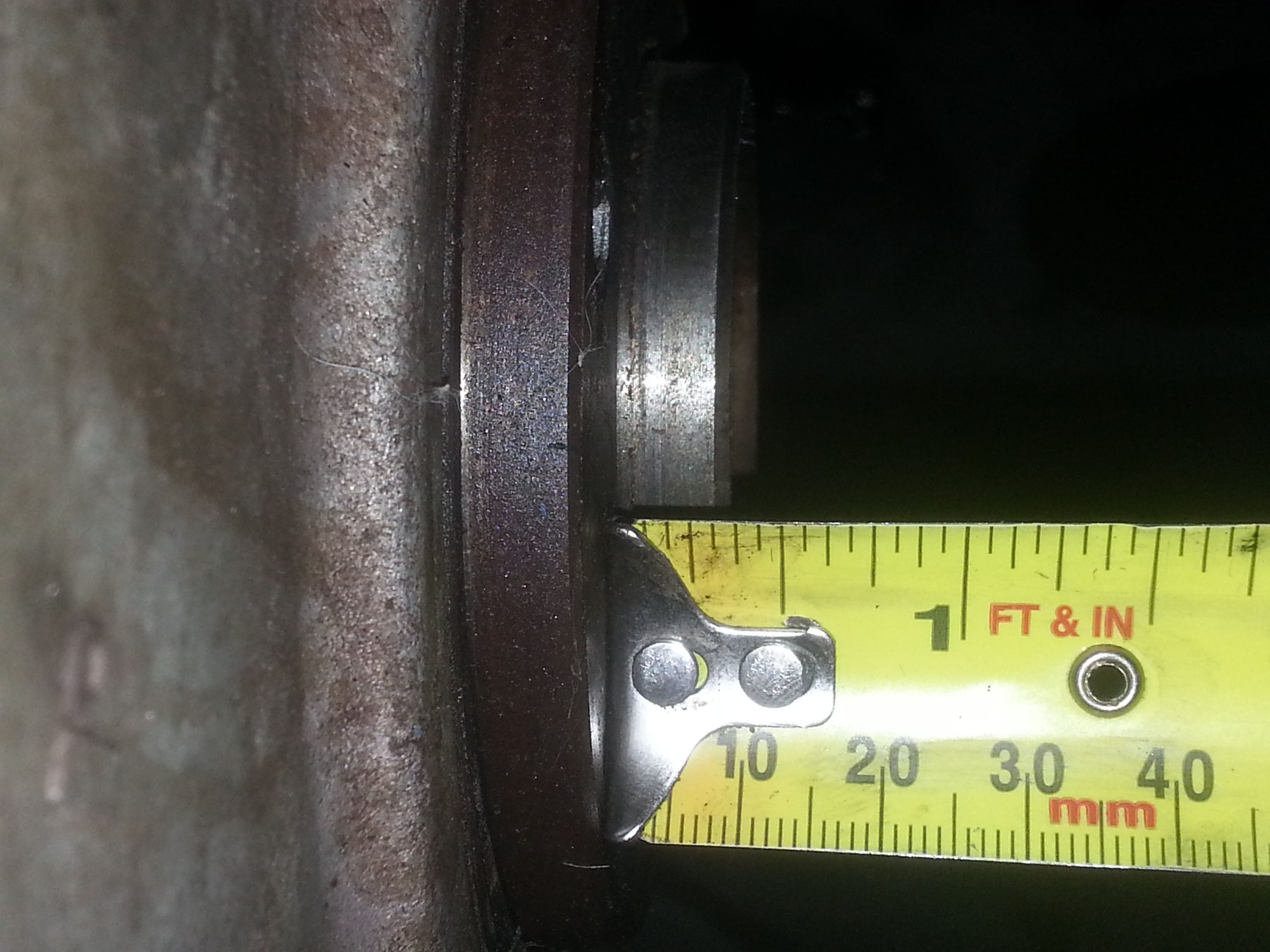

This is of the converter sleeve, do I need to remove this?
