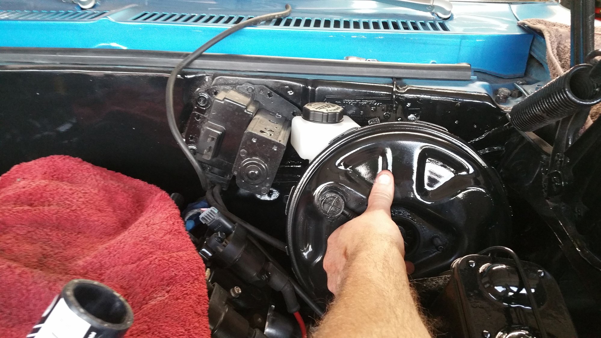

Well it's not a cheap lesson, but I'm sure you'll be much happier with a hydraulic clutch anyway. Is your PCM location going to give room for A/C unit/vents? I know my factory system occupies a lot of that space with ducting.

It allows plenty of room for a Vintage Air evaporator - we took measurements using my setup. He's running the center vents in the console (pic a couple posts ago).

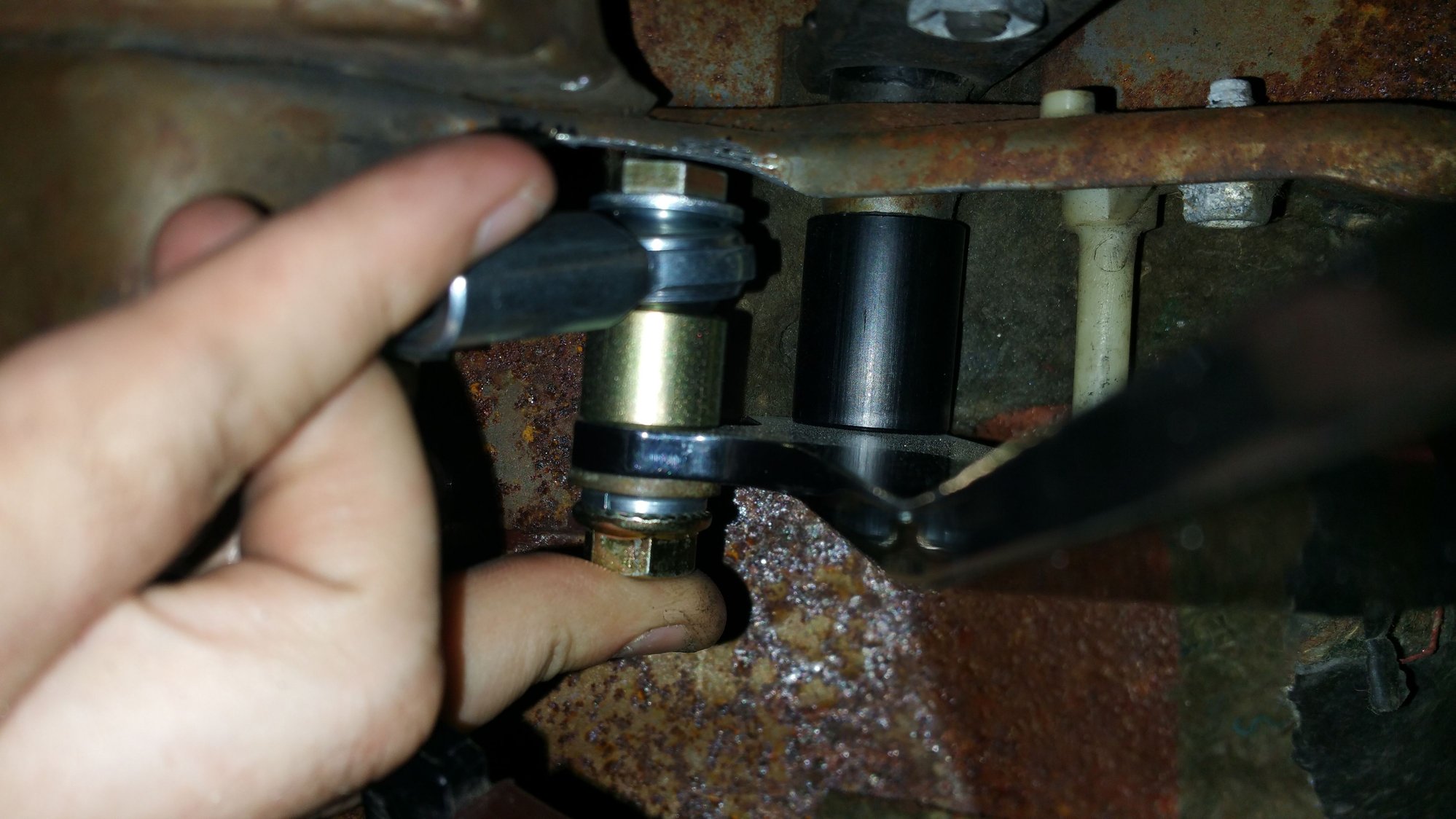

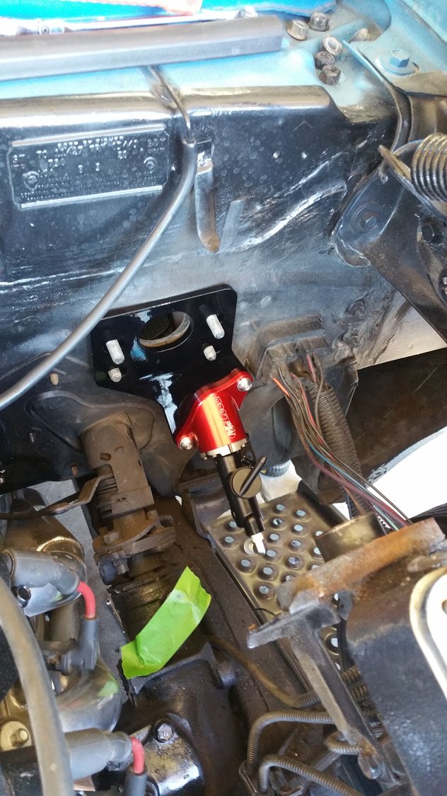

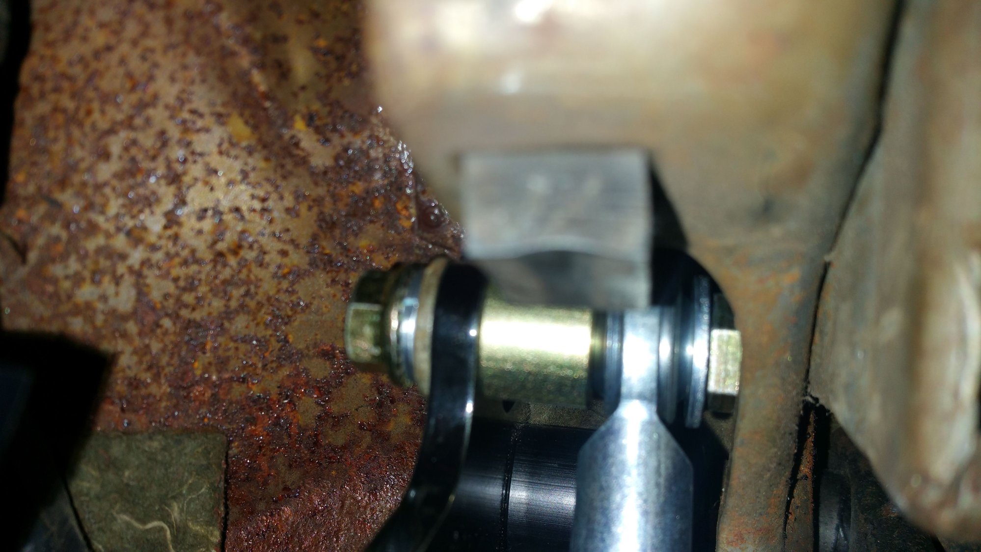

Had to order a new boot for the clutch push rod but I got it mocked up for the most part. I did have to do some cutting to get the bolt head to clear the pedal bracket.

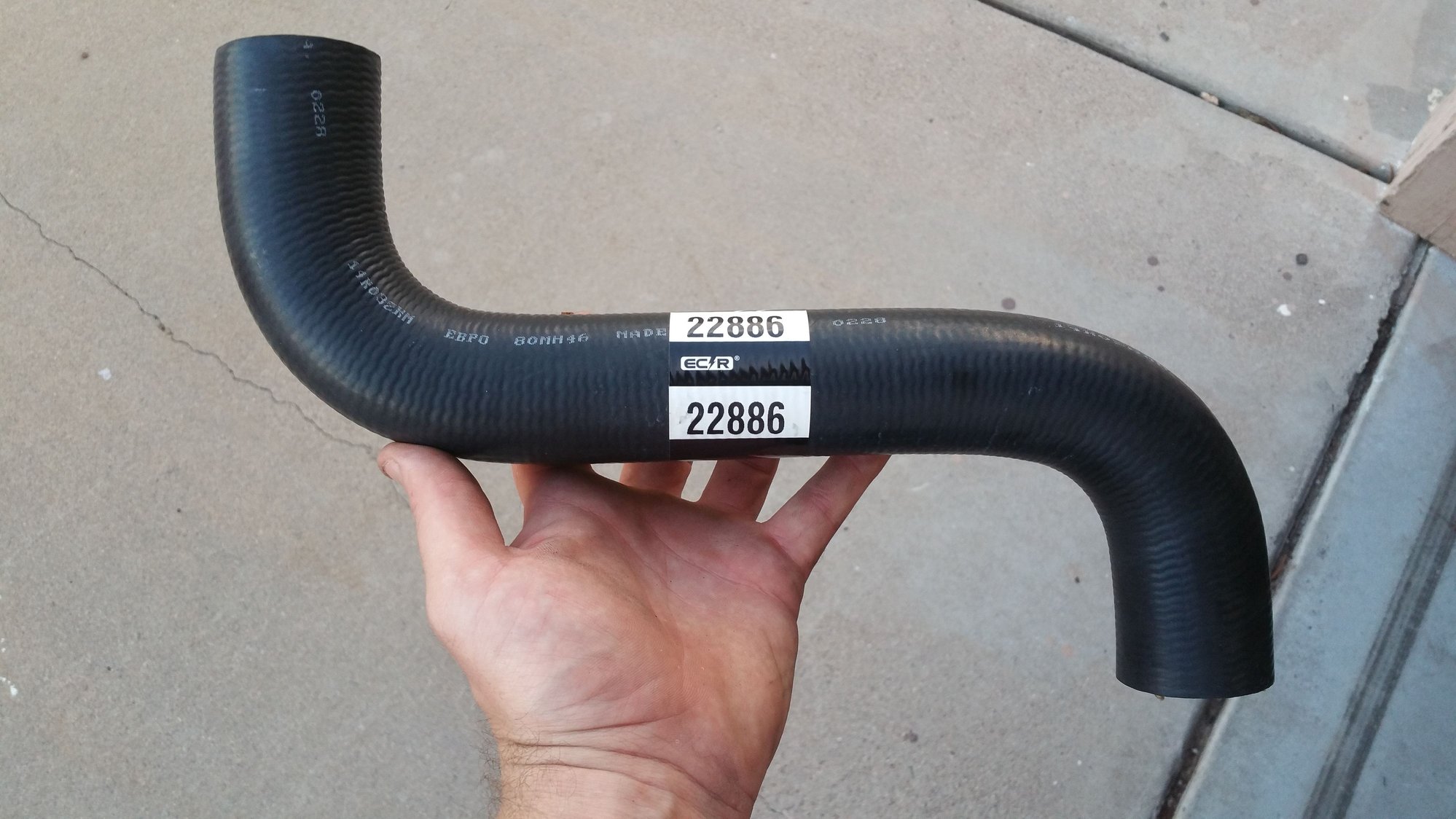

Been struggling for my lower rad hose a bit. I have the speedway rad and I didnt realize the lower inlet was 1 3/4" and its also at a weird angle. The hose I found today is 85-95 chev truck. Basically end up cutting it in half. Its not perfect but I think its doable. Top hose was money first shot. its a little lose on water pump side. Here are part numbers

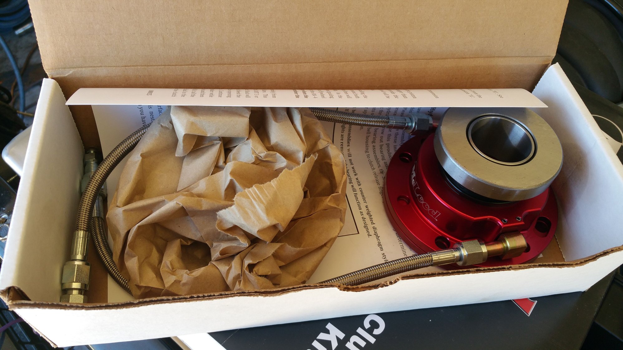

ok, worked on the throwout bearing setup today. Man, Mcleods instructions SUUUUUUUUUUUUUUUCK. My tolerance is way out and I have emailed them to see how to fix. I do have a question maybe someone here can answer. What the hell is this ring for? This is the Mcleod 1364 bolt on to tko600.

Joined: Mar 2014
Posts: 35
Hookem approves this location. lol I think the pic makes it hard to see but I showed him the other day in person and he said it will work great.

Well, i am waiting on a shim for the throwout bearing. That will put me within my tolerance. Had to order a pushrod boot for the firewall. Got that installed today and bolted up the booster etc. so far I have great clearance for the hyd fluid res. Starting to come along...AGAIN
