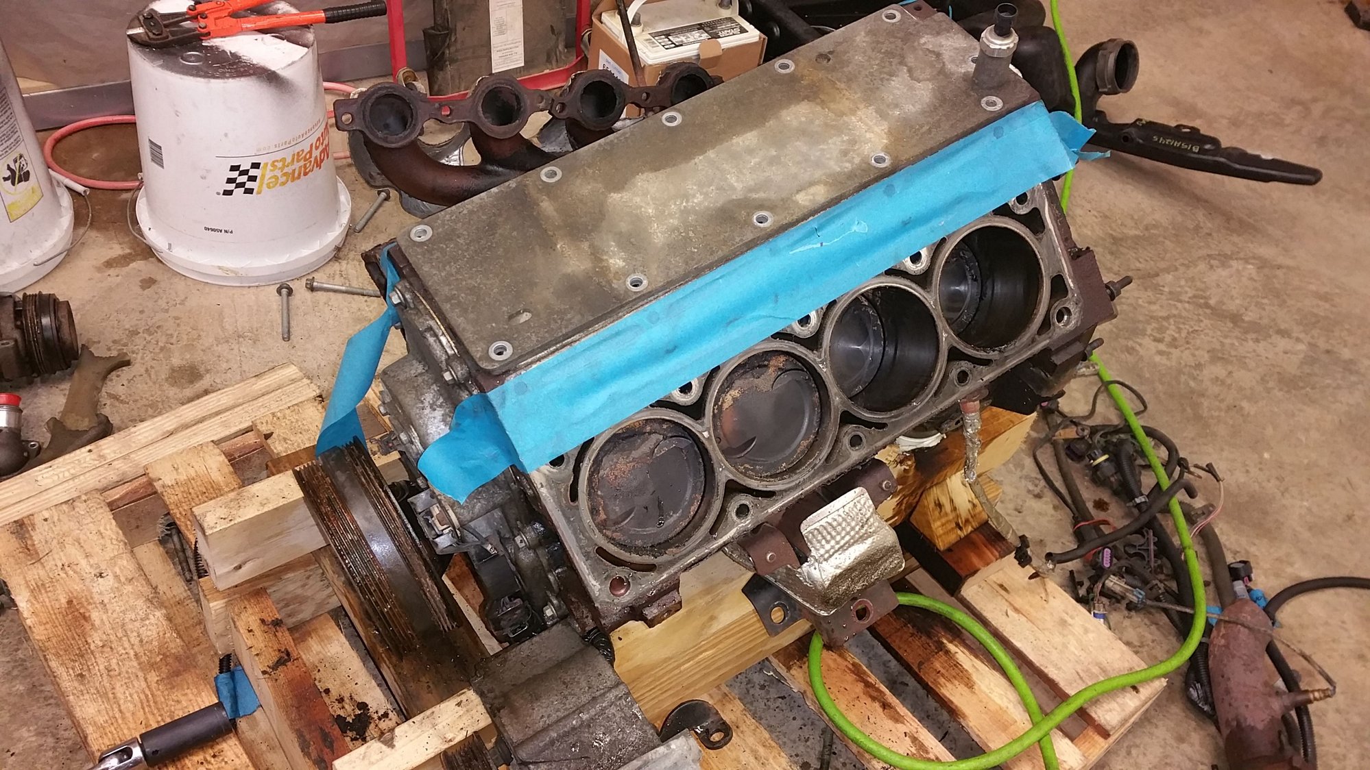

This was the engine after about 2.5 hours. It is SOOOOOOOOOOOO much easier to work on this thing outside of the boat/car.
2.5 hours later...

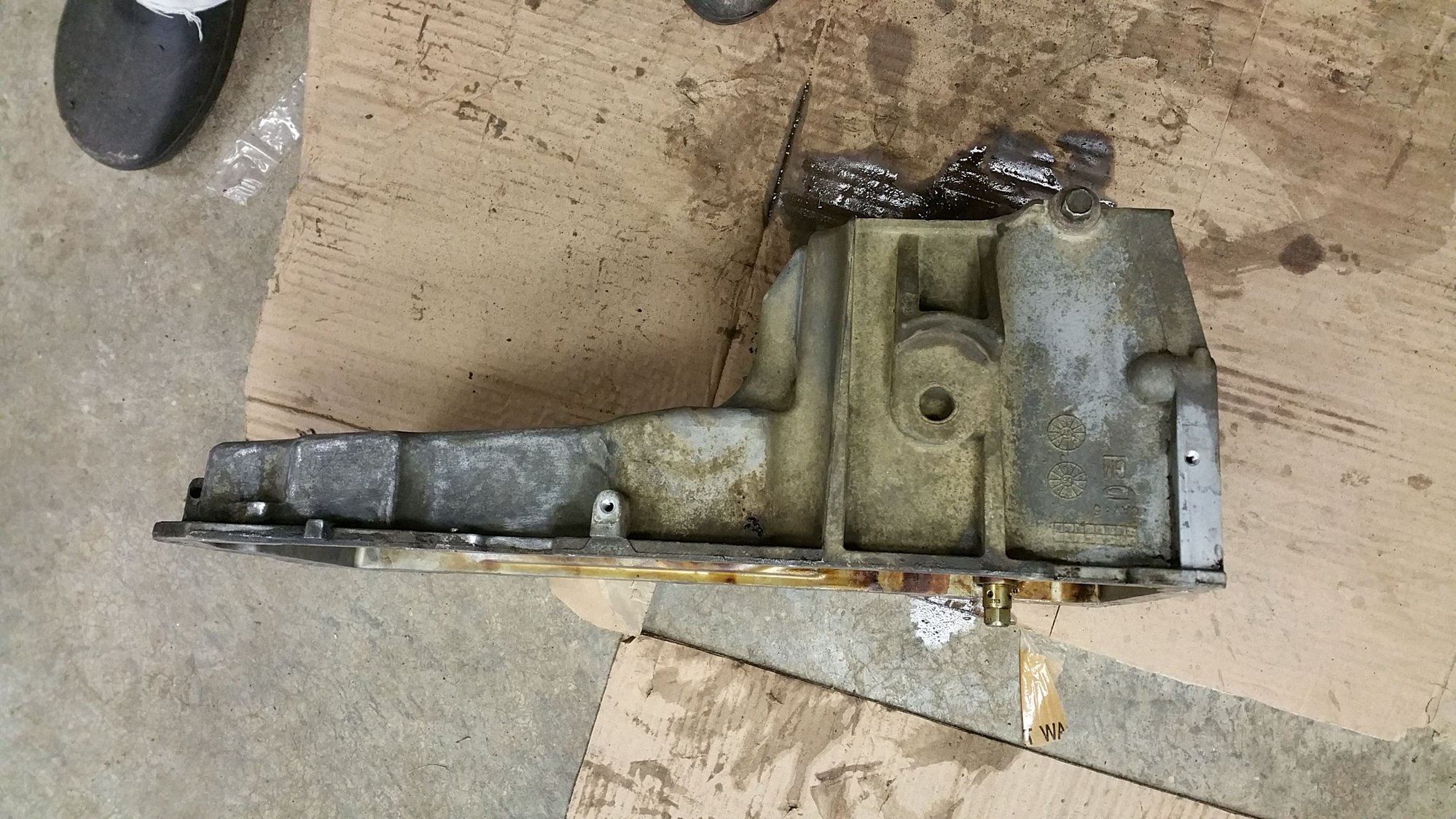

Oil pan and valley cover primed and awaiting paint.

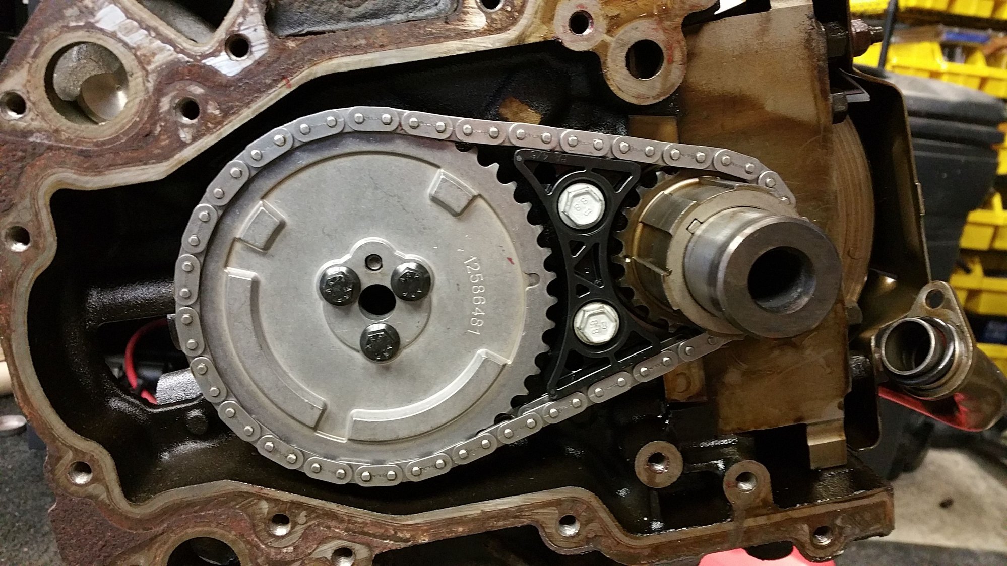

I went with the dog bone style chain dampener as the original tensioner was broken.
Melling high volume pump in place. This is a LOT easier to do with the engine out.

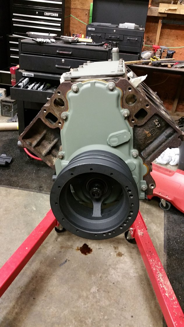

Timing cover and dampener in place.

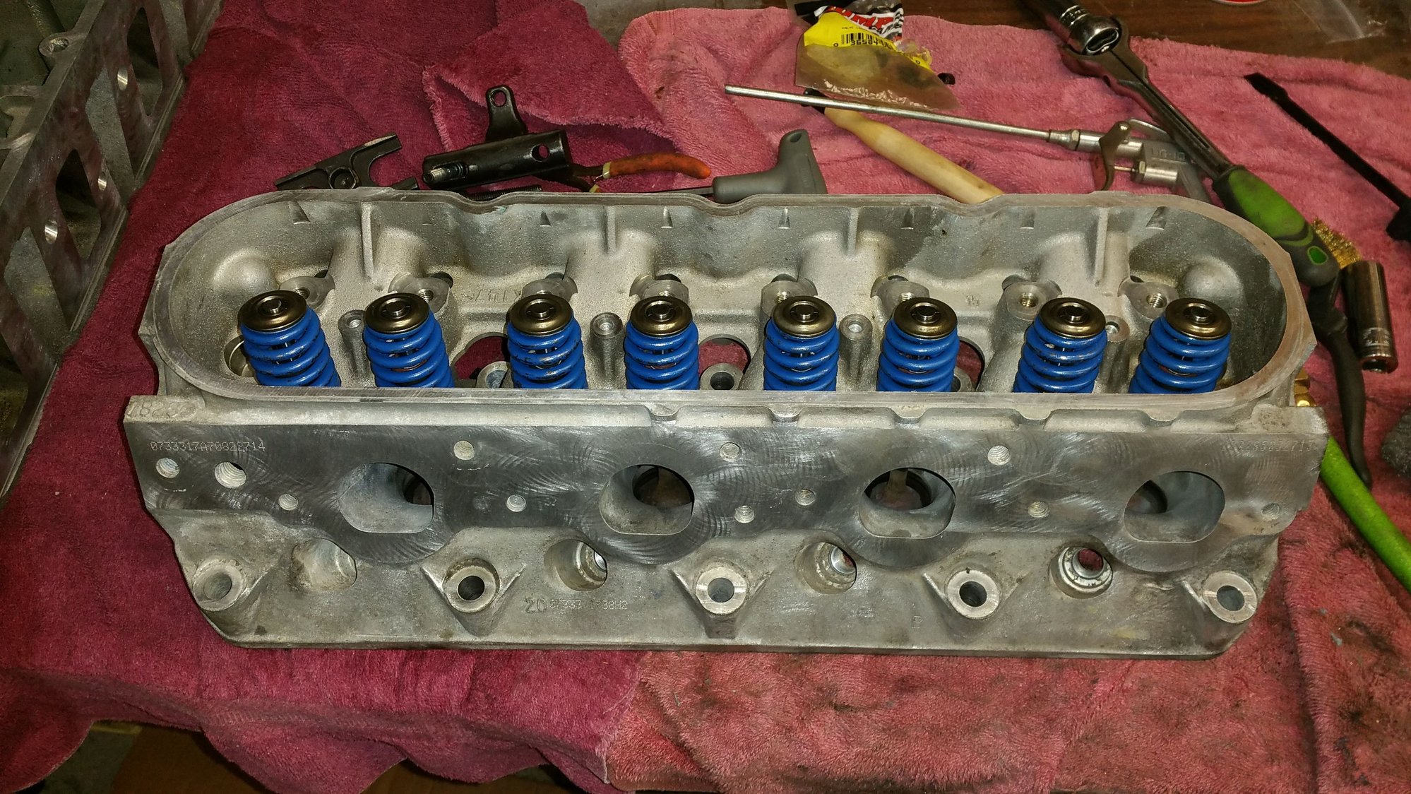

Finally made a little more progress. Both heads are pretty clean (a few external nits need taking care of) and one has been lapped and loaded with new valve springs, seals, and locks.
