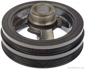

Pretty sure that's normal. This is a 2002 LS1 from a camaro and it has never been apart. It has that 1/8" sticking out.

I've had several varieties of LS-based engines and they've all had the front cover seal on the balancer neck, not the crank shaft.
Looking at this pic, I think the gap depicted above is actually showing part of the balancer, not the crank.

Yes, my pic is showing part of the machined portion of the balancer which is what I thought the OP was talking about. If the actual crank was showing the balancer wouldn't be on hardly any at all and would fall off.
To the OP, is the crank even with the front of the balancer where the bolt goes? If it it, then thats as far as it's going to go on.

Ill get some pictures this evening. It look identical to the gap in that picture though

If your balancer looks like the picture ls1nova71 posted, it's on all the way.
