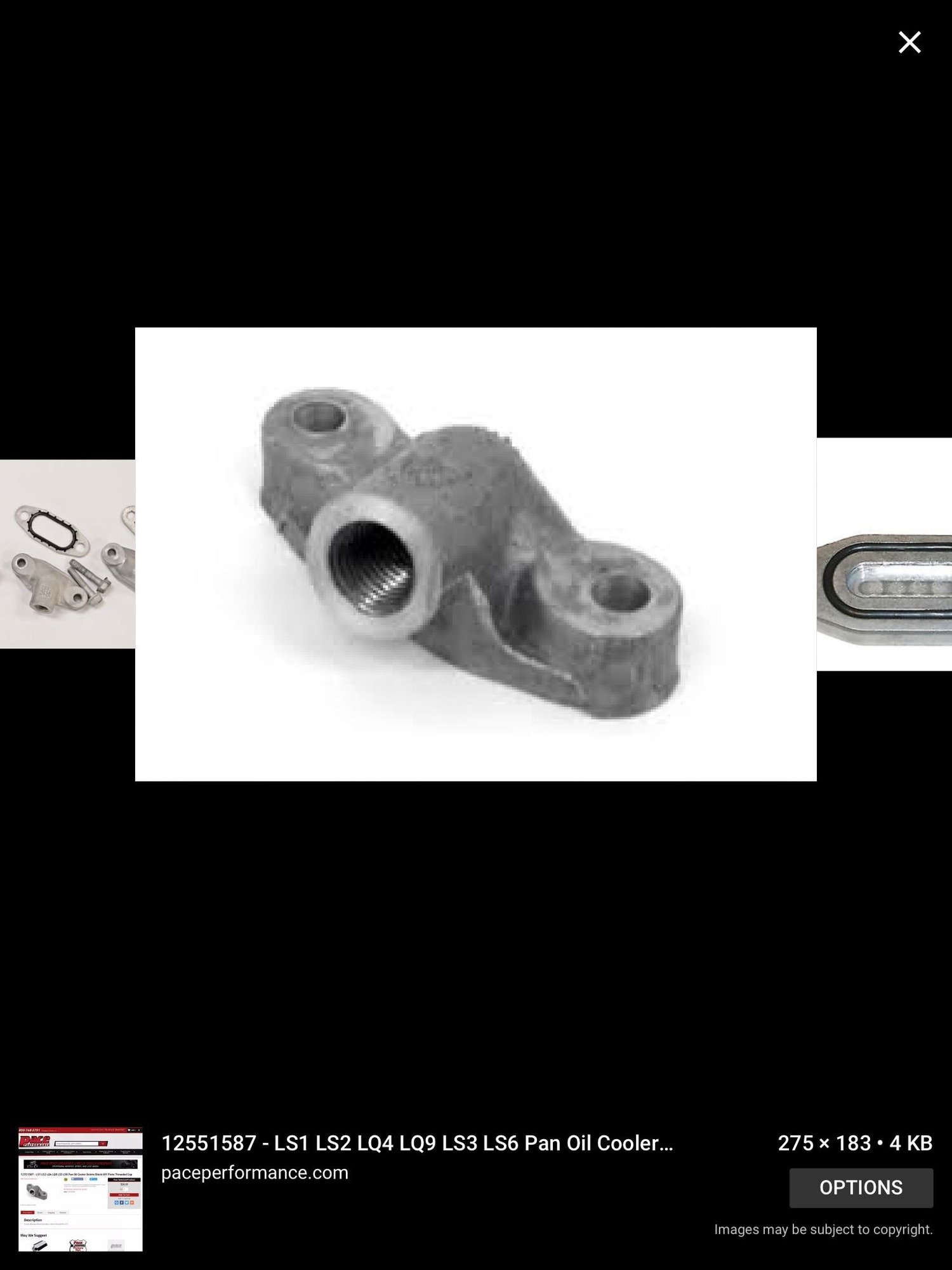

You shouldn't have to. But I wouldn't recommend trying to drill and tap it on the oil pan....
Old Mar 3, 2016 | 08:45 PM
jimmyg's Avatar
Joined: Jun 2014
Posts: 1,533
Likes: 12
U can buy one with a nipple already on it . I think I got mine on ebay.that way I could leave the stock one connected for the ecm
97-2000 vette <br/>Pace performance
Old Apr 13, 2016 | 05:50 PM
mugwump5's Avatar
Joined: Jan 2016
Posts: 41
You can take your adapter and tap it also.
