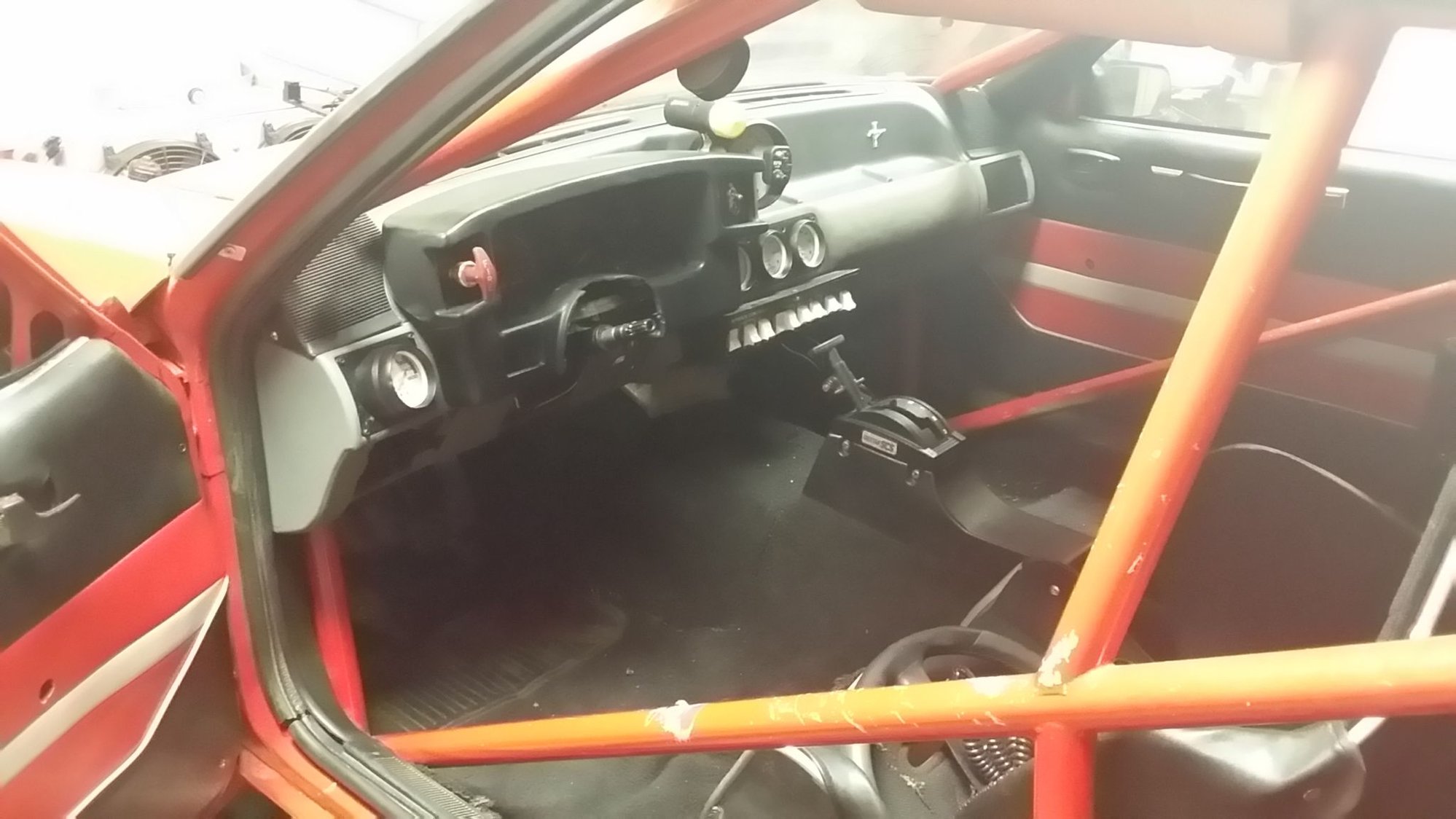

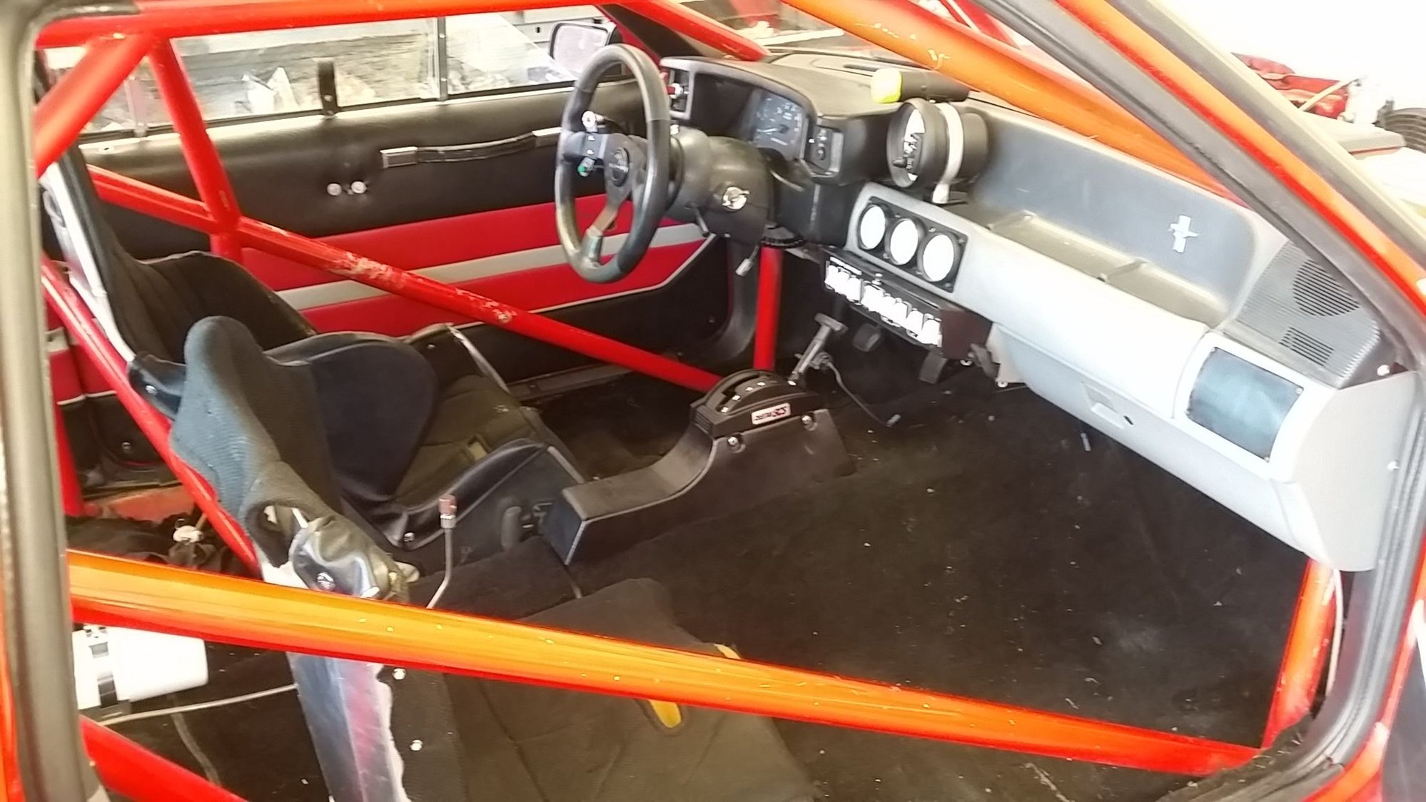

Made some progress with the car,cleaned up the trunk and interior

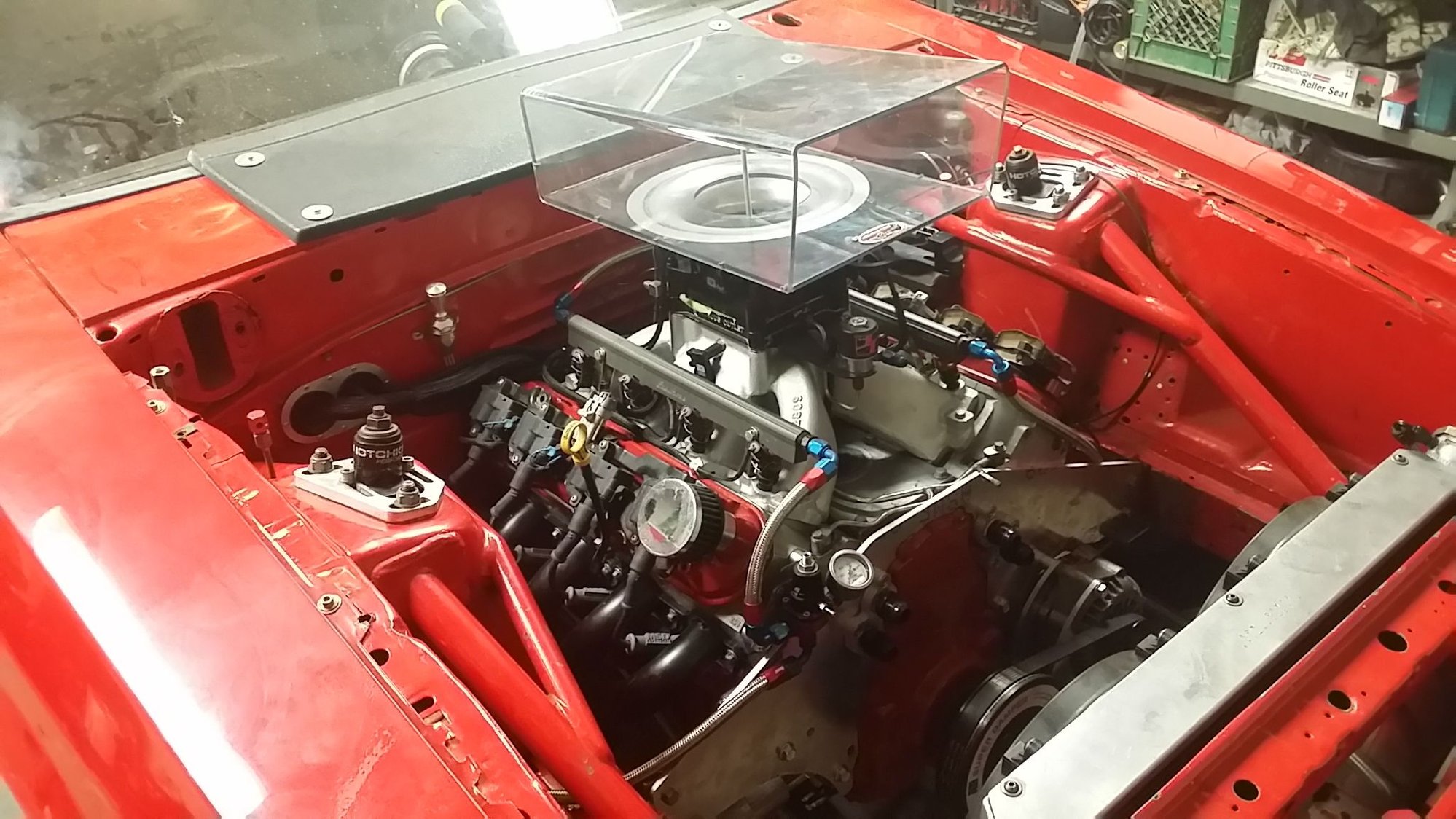

First I got rid of the hood with the aero scoop in favor of a VFN 5" slope hood
Engine and transmission are now in the car, used a Skinny Kid Race Cars LSx/Foxbody motor plate. I'm using a GM pcm, and a PRK Automotive stand alone engine harness for engine management. I chanced the fuel system completely from the carb setup, to Efi with a Holley inline pump. Still using the same Nitrous Outlet Stinger plate that I had on the Camaro. The Dynatech headers fit on passenger side, but will need some work to fit the drivers side

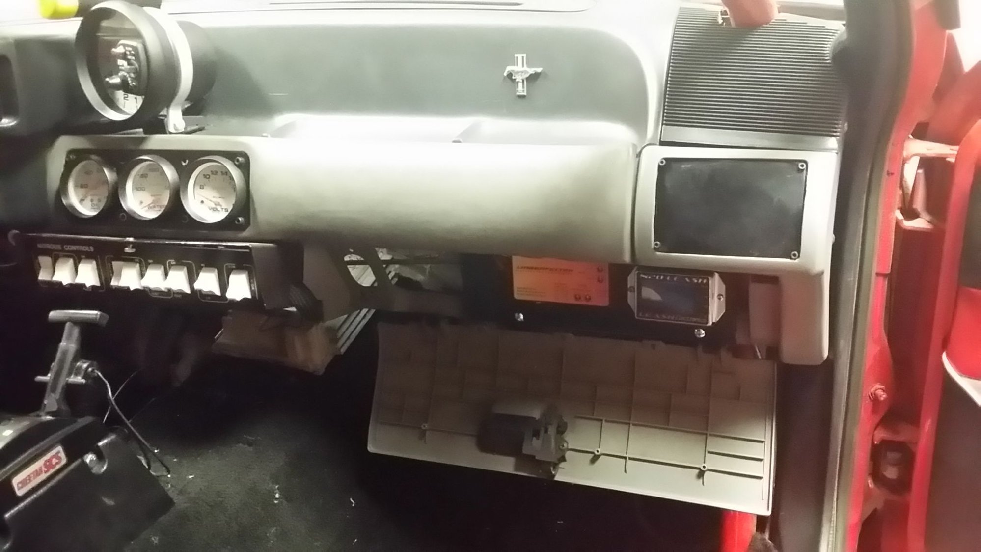

I put the LNC-2000 and Leash progressive controller inside the glove box lid
To reduce some weight and make more room to get in and out of the car I ditched the stock column in favor of a Racecraft tubular bolt in unit. and a 6" steering wheel extension from Tim McCamis Racing

your steering column has 4 bolts that hold it under the dash that you can shim different ways to help clear the headers. you can almost drop the column an inch with spacers.
