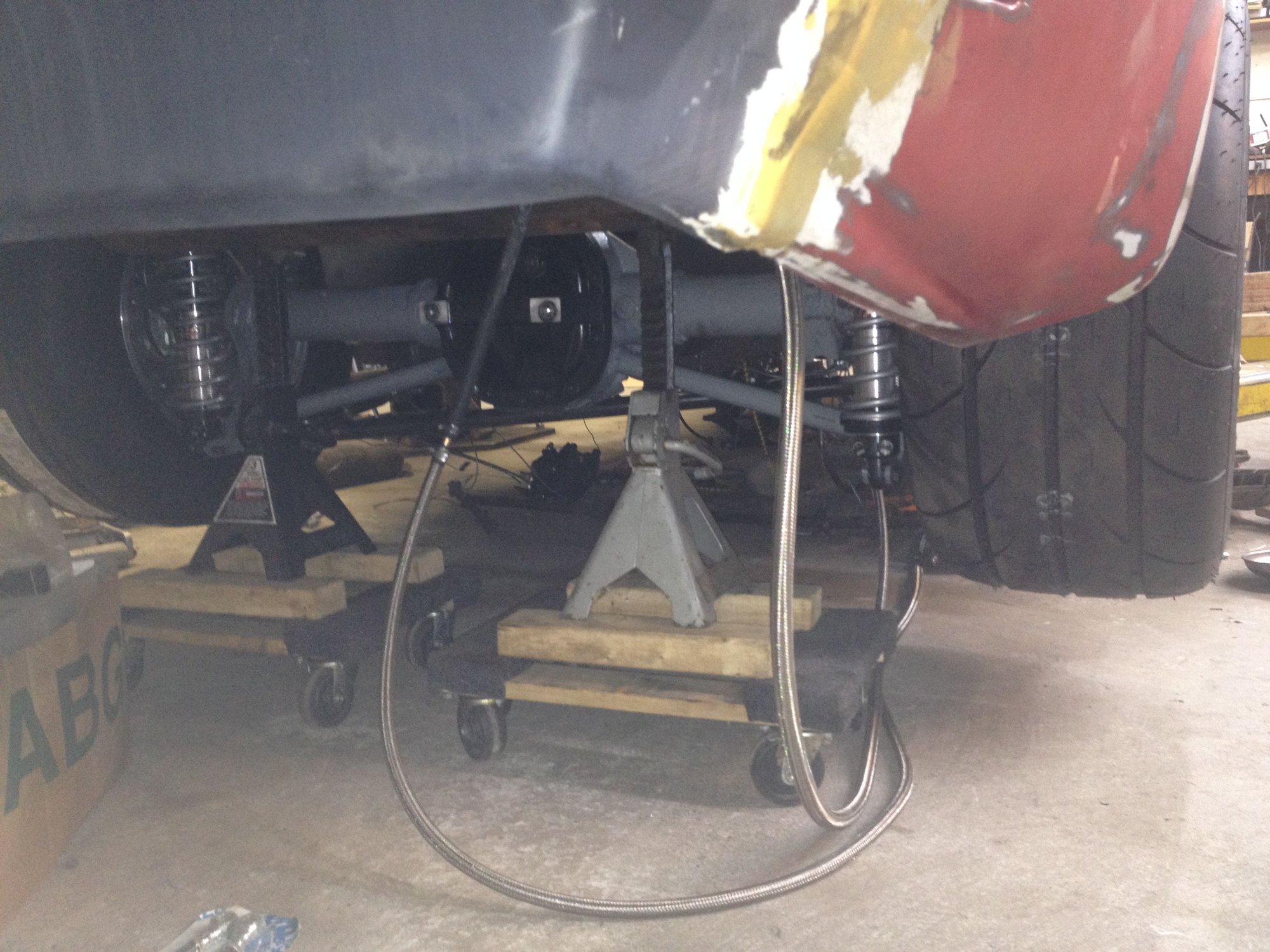

Let's start with the rear

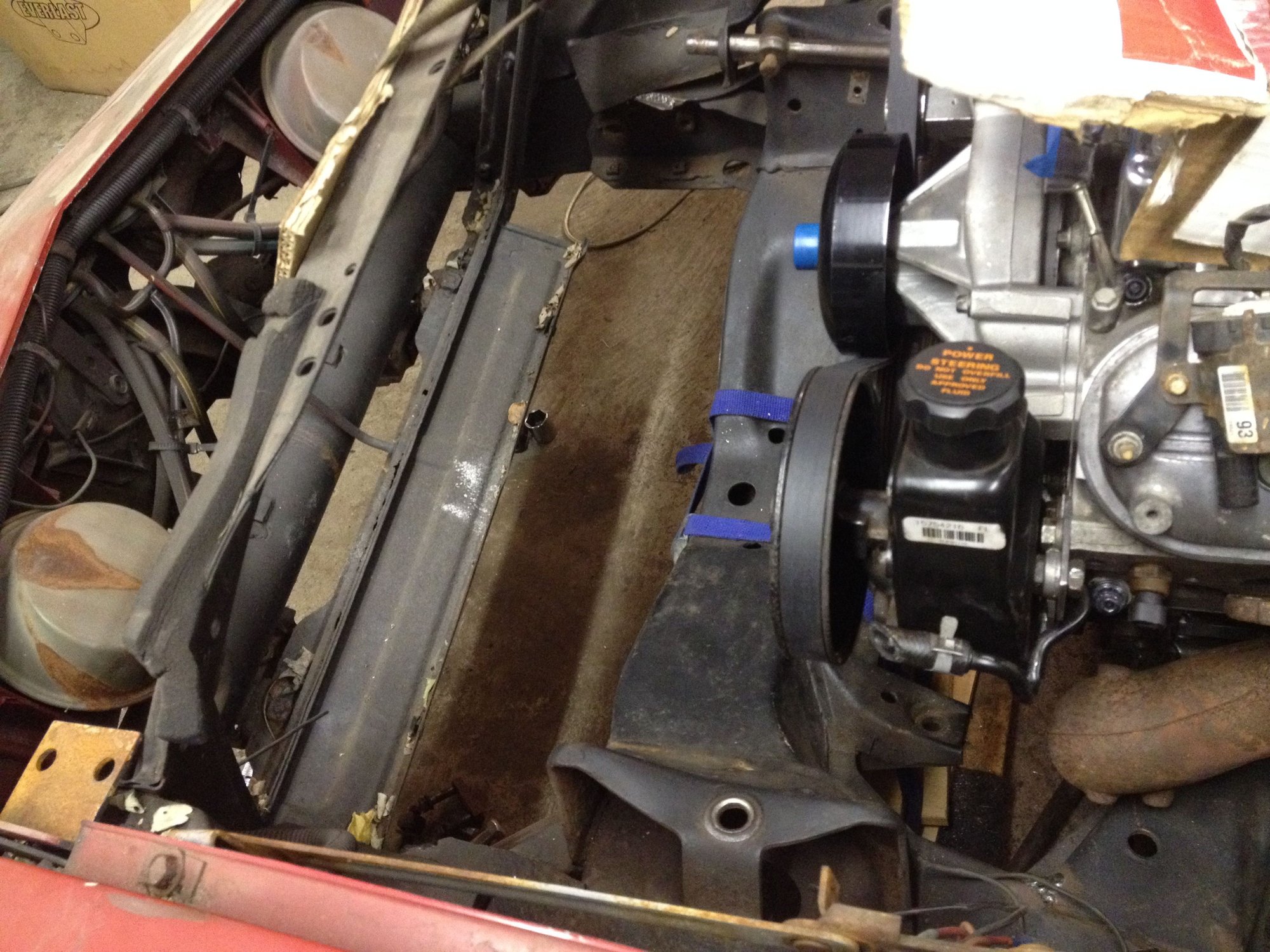

Needed to make more room up front for turbo and intercooler, so I gutted the rad support, vacuum junk and especially those headlamp vacuum canisters.
Before.
After.
Those are Ebay linear servos at about $30 each. Add a relay and when headlamps turn on, they automatically open. When lights turn off they close.

I narrowed the rear to fit 295/55/15 MT DRs.
Wheels are 15x10 with with a 5.5 backspacing.
This is with the suspension unloaded.
When I load the suspension, I'll see if I have to flare the fenders or not. It's close.

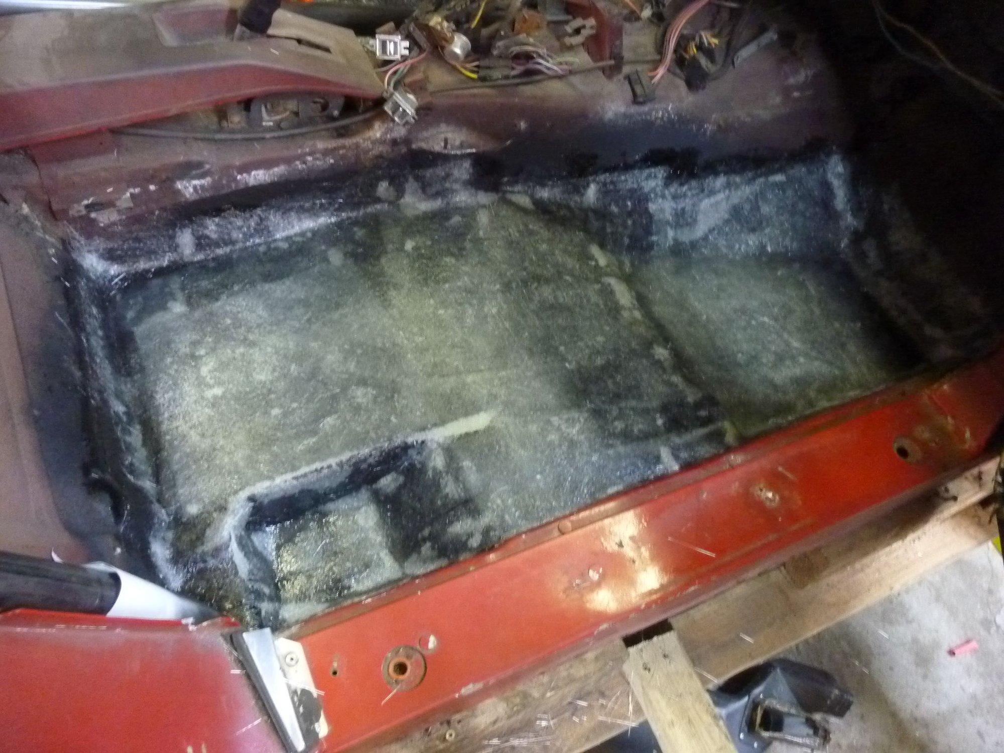

The floor on both sides was pretty rusty with a number of "ventilation" holes. I treated the floor with rust reformer and then fiber glassed over it.

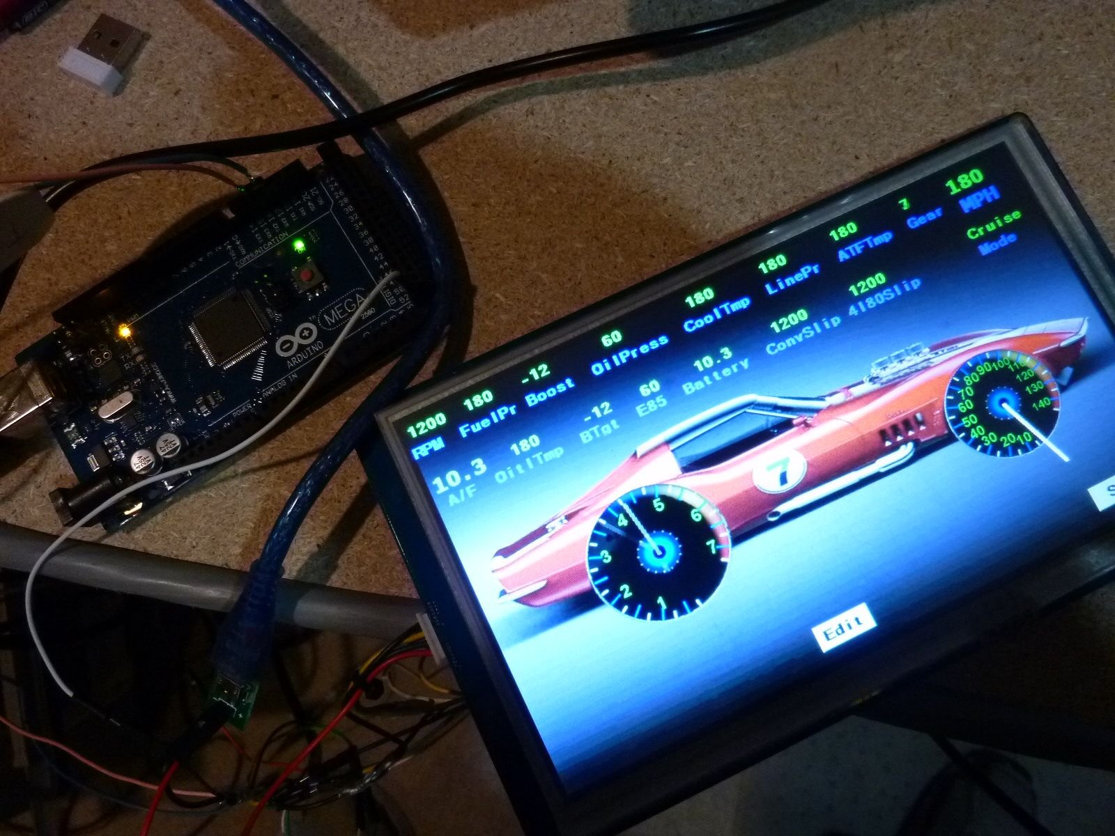

Ok, I know I should be working more on the mechanical stuff to get this car on the road. But I really enjoy designing electronics as well.
I saw this killer 7" display and thought it would be great for the dash. So I'm playing with it, to see how much more work it will be to integrate this.
Here's what I have so far. It's not attached to the transmission controller yet, the numbers a just a mock up being run by the Arduino.

I pulled some photos off the internet and made them backgrounds for each of the driving modes. If anyone has some nice graphics that they think might look nice as a background, LMK and I can change these easily.
This display allows me to move anything around easily, so if I don't like where any part is, I can mode it around, add other stuff, graphics etc. It's also a touch screen, so I won't need lots of buttons to run this.
The Cruise/Sport mode screen has a bunch of digital info as well as a Tach and Speedo.

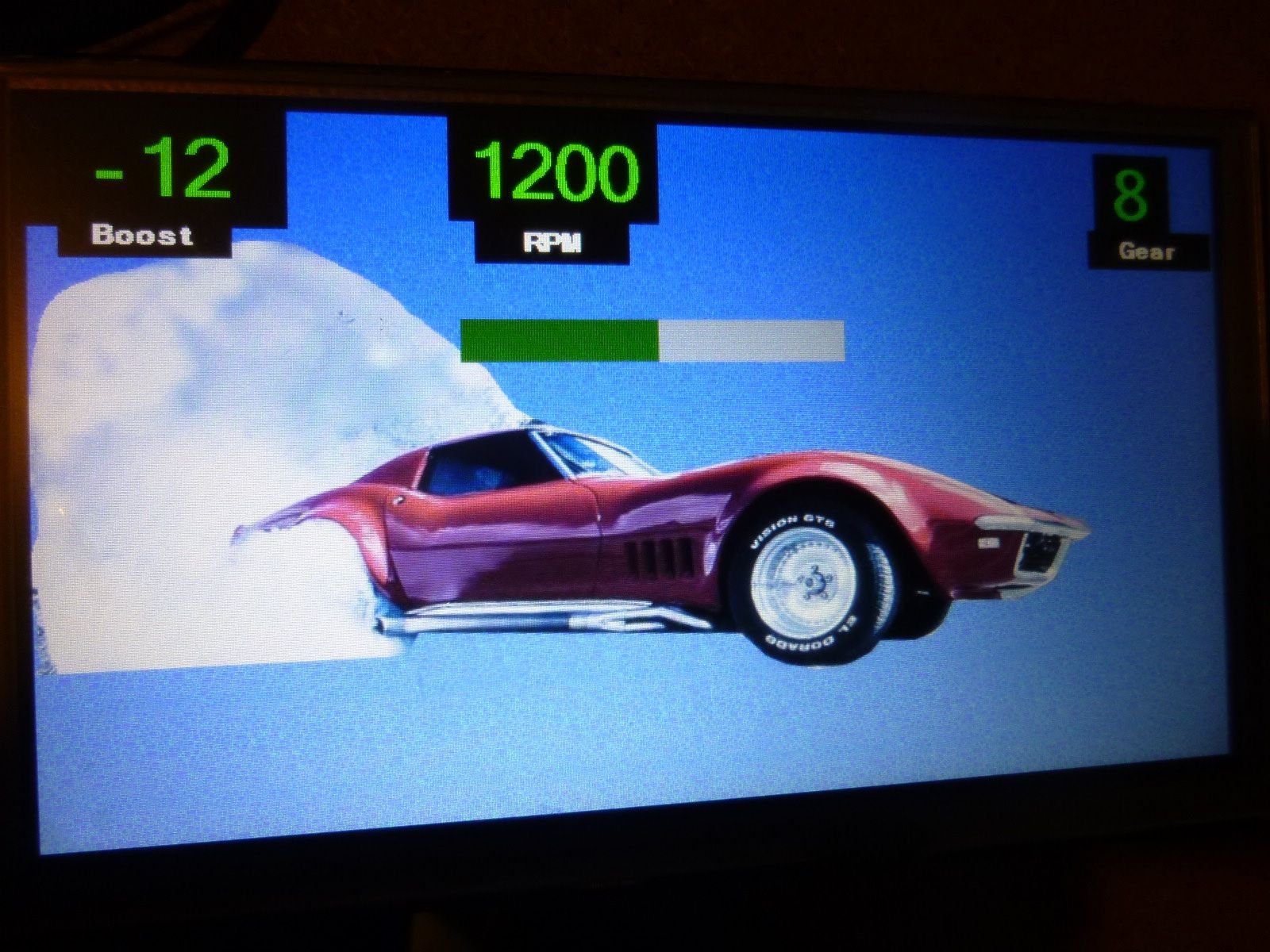

Here is the burnout mode screen.
That slider in the center is to let me know if I'm under or over my boost target for that gear.

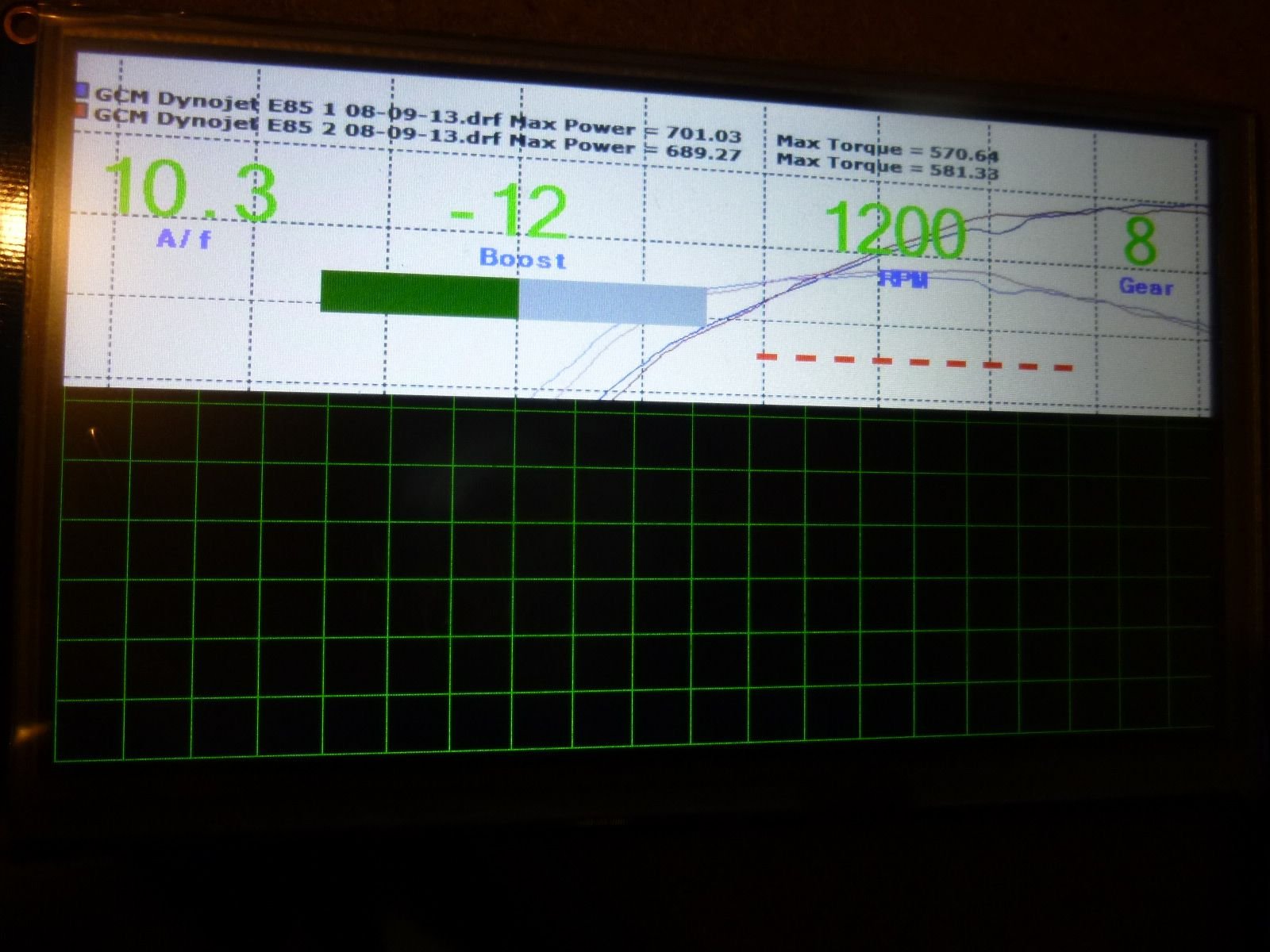

Dyno mode screen:
The bottom of the screen will graph RPM, boost, A/F.
Hmm, I could plug in the weight of the car and have it calculate HP and graph that too.
The black text on top of the screen is not my dyno run, just part of the background photo of a random dyno sheet. It's a nice target to shoot for..... or maybe surpass.
