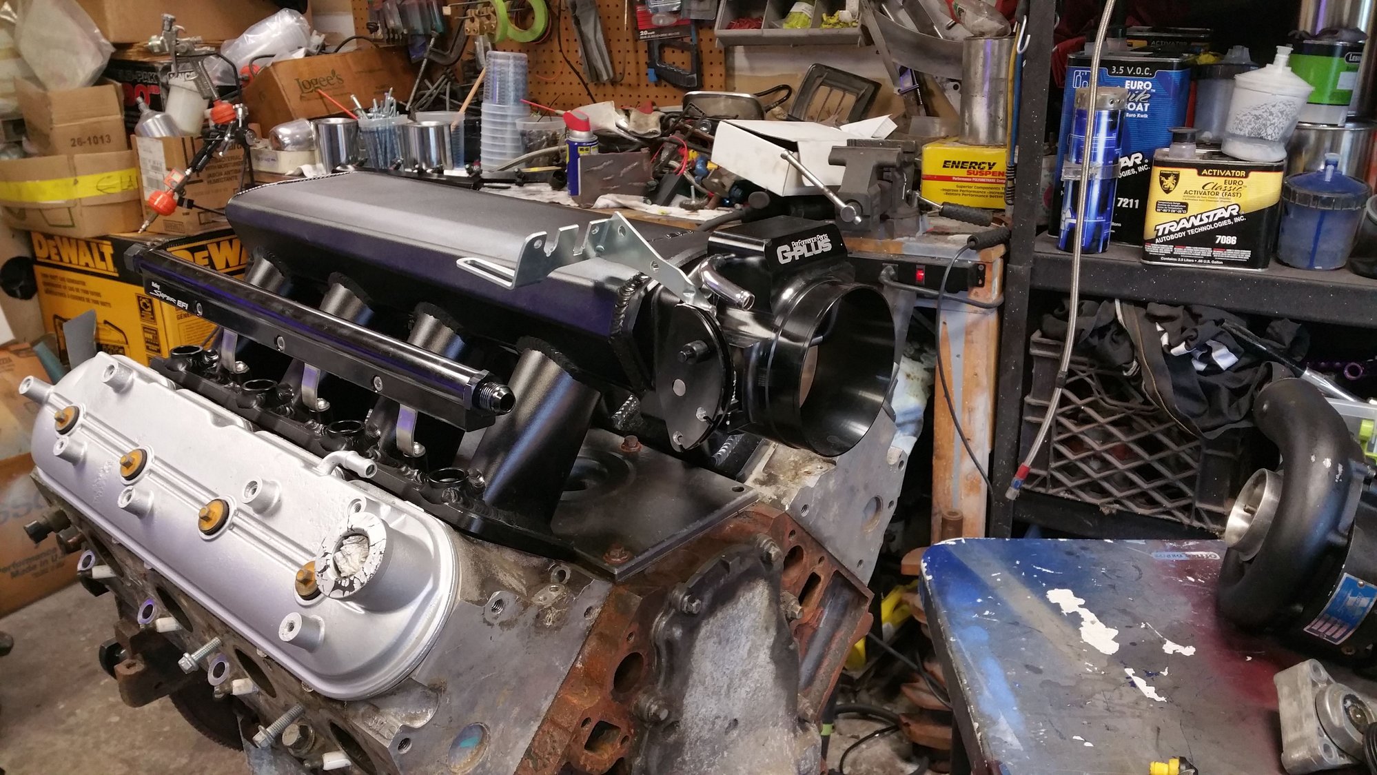

Old Nov 19, 2016 | 08:47 AM
lamdenali's Avatar
Joined: Aug 2009
Posts: 258
From: Monsey NY
Old Nov 19, 2016 | 11:08 AM

Holy moly @21 # all your internal must be bullet prove. I'm running all stock. I'm thinking of Denmah kit 5-600 will do for me for the street
